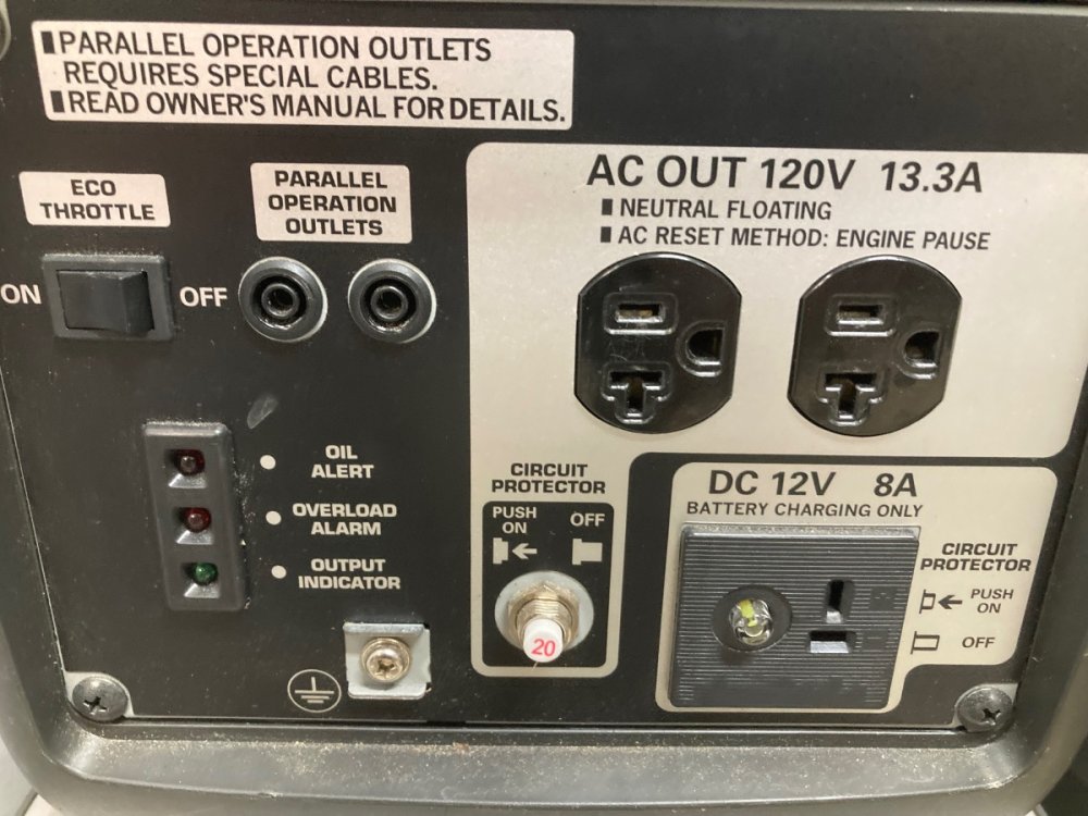

Only ran AC with ECO mode off so far, it’s just my preference. Never tried to run AC with ECO mode on. Purchased and installed the MicroAir EZ start worked fine with the 2000 Honda. When charging battery through Progressive converter or anything else, run gen-set in ECO mode.

On 6/15/2023 at 3:02 AM, Patriot said:
Does your EU2000i have an echo mode setting? And with the EZ start will it run your 13.5 Dometic in echo mode?
On mine, YES it will BUTTTTTTTTTT
When I looked that voltage drop and time to fire off the unit, I only run my Honda on full power mode when I have the A/C running.
I think that makes sense. If you have a 13.5k btu I doubt eco mode would be happy.
