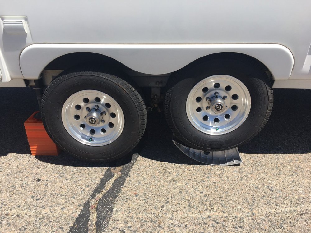

jd1923 Posted August 6, 2023 Posted August 6, 2023 Well, y'all got me thinking of being ready to change a tire on the road - TY. I had the Oliver hooked up this weekend to do a few things, like measuring rear ride height before and after coupling, and while I was at it, I tested my EZ Jack to know whether it works on the Oliver. The one I bought 30 years ago is the same brand as this one: Blaylock EZ Jack and Wheel Chock for Tandem-Axle Trailers - Aluminum - 20,000 lbs Blaylock Industries Wheel Chocks EZ-JACK It does work on the E2, lifting the other wheel barely off the ground. Then I used the rear leveling jack to bring it up another inch and it was very solid for changing a flat tire (chock the other side if you are going to decouple the TV). All was good, then as I pulled into a gas station, up the driveway on an angle, I heard a loud BANG, and quickly checked my right-side mirror to see if I had hit the curb but was 2-3 feet away. I'm thinking a shackle got turned upside down when I drove up the jack, lifting one wheel allowing the other to drop. Now it's reset, all by itself! 3 Chris & John in Prescott, AZ | 2016 EII #113 | '01 Ram 2500 Cummins!
Moderators topgun2 Posted August 6, 2023 Moderators Posted August 6, 2023 10 minutes ago, jd1923 said: Now it's reset, all by itself! Your assumption is very likely correct. And, that bang is a bit startling even when you are expecting it. If this happens to you again and you notice that the shackle has flipped then all you have to do is slowly drive (on the side that is flipped) over a curb or a 4x4 (this is what they do in the Oliver Service Dept). Bill 1 3 2023 Ford F150 Lariat 3.5EB FX4 Max Towing, Max Payload, 2016 Oliver Elite II - Hull #117 "Twist" Near Asheville, NC
jd1923 Posted August 7, 2023 Posted August 7, 2023 2 hours ago, topgun2 said: If this happens to you again and you notice that the shackle has flipped, then all you have to do is slowly drive (on the side that is flipped) over a curb or a 4x4 (this is what they do in the Oliver Service Dept). Bill Thanks Bill, the driveway entrance had a 2" bump, and I was taking a left turn (had jacked up the left side) at a good 10 MPH! Just another way to do it. Lol 😀 1 Chris & John in Prescott, AZ | 2016 EII #113 | '01 Ram 2500 Cummins!
Moderator+ ScubaRx Posted August 7, 2023 Moderator+ Posted August 7, 2023 4 hours ago, jd1923 said: Blaylock EZ Jack and Wheel Chock for Tandem-Axle Trailers - Aluminum - 20,000 lbs Blaylock Industries Wheel Chocks EZ-JACK It does work on the E2, lifting the other wheel barely off the ground. Then I used the rear leveling jack to bring it up another inch and it was very solid for changing a flat tire (chock the other side if you are going to decouple the TV). All was good, then as I pulled into a gas station, up the driveway on an angle, I heard a loud BANG, and quickly checked my right-side mirror to see if I had hit the curb but was 2-3 feet away. I'm thinking a shackle got turned upside down when I drove up the jack, lifting one wheel allowing the other to drop. Now it's reset, all by itself! I'll bet you're are spot on about the noise coming from a reversed shackle. While working on the running gear of the trailer, while I would advise you to chock the opposite side, I would also recommend that you to never unhook the tow vehicle. It is your greatest safety net. With the trailer still attached to the truck, there is virtually no way it could move forward or backward. 2 Steve, Tali and our dog Rocky plus our beloved dogs Storm, Lucy, Maggie and Reacher (all waiting at the Rainbow Bridge) 2008 Legacy Elite I - Outlaw Oliver, Hull #026 | 2014 Legacy Elite II - Outlaw Oliver, Hull #050 | 2022 Silverado High Country 3500HD SRW Diesel 4x4
jd1923 Posted August 7, 2023 Posted August 7, 2023 (edited) I don't bother with a chock when coupled. The truck parking brake is quite enough, as it ain't going nowhere! I will chock to decouple a trailer for tire repair, since I prefer to drive the wheel in for repair, not the whole rig, unless we're many, many miles to a tire store and then the spare makes sense to me. I see so many vehicles stopped, just one foot from the white line on a major highway and I'm thinking why, in the world, did they stop there? Why not coast a little down the road to a safe place. This is first and foremost. Your tire likely needs replacing anyway, you can't hurt it any further, maybe scrape the rim little which is less important than your safety! Just keep rolling, don't hit the brakes, flashers on, and coast slowly to a safe place, while looking ahead to eyeball the best safe level spot available! And Steve is absolutely correct, if you are going to mount the spare, drive truck & trailer in for repair, there is no reason to decouple. Edited August 7, 2023 by jd1923 REmoved story 2 Chris & John in Prescott, AZ | 2016 EII #113 | '01 Ram 2500 Cummins!
