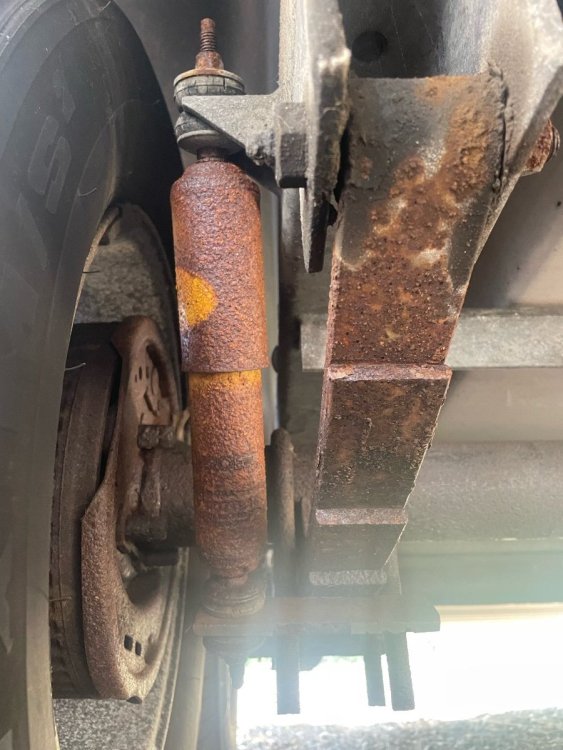

I'm looking at a 2017 Oliver to possibly buy. It's lived its life in the Pacific Northwest and in the last year and a half in a beach town - and it shows! I don't know how damaging it is - I've never been around rust before -  I don't know if its cosmetic or there's a real problem. (I assume the shocks need replacing). Lots of rust on the leaf springs, shocks, axle, inside the tire, and I guess the shackles.
If I do get this trailer it will probably mostly live in the southwest.

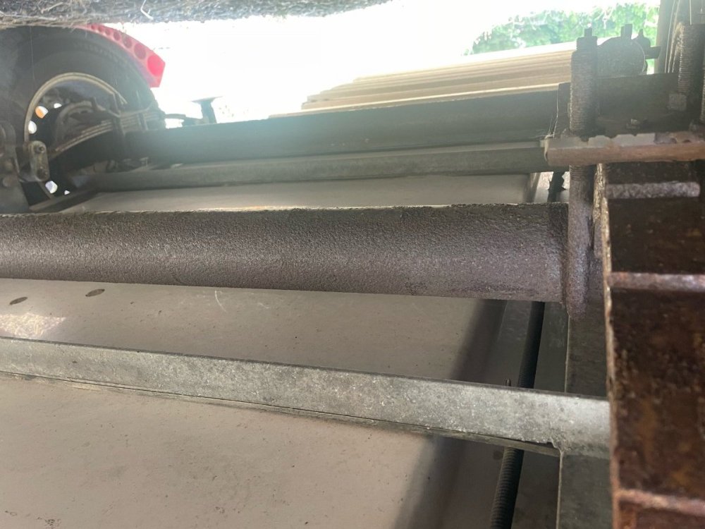

Cort - Is that "scale" on the aluminum stringer too?  What does the aluminum frame look like?  It appears as if this Oliver has the EZ Flex suspension.  If that is correct, does it appear that the zerks have been used (i.e. did the owner ever lubricate this suspension?) ?
Actually, even though the shocks look bad, you really can't tell unless you test them.  The black rubber pieces at the top of the shock appear to be in good shape - particular for a 2017.  Any idea of how many miles the owner put on this Ollie?

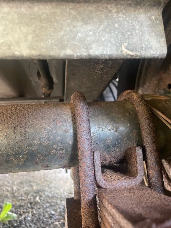

Did you scrape any of that rust off?  If yes, how deep does it go?  For the most part it appears to be surface rust (i.e. no deep pitting).  Certainly it would be a fair amount of work (assuming that it is surface rust) but it is possible that it could be brought back assuming that you are a bit handy with taking things apart, really cleaning them, and repainting them.

As I remember the aluminum frame looks fine.  It does have the EZ flex suspension. I will check on the zerk lubrication. The owner did have it to Oliver for maintenance a couple of times.  It's been a couple of years but she said no one said anything about the rust. Then again, it's been at the beach since then. I will try to find out if the zerks have been lubed and how often. I think they should be lubed fairly frequently.
It has about 20K on it.
Did not try to scrape the rust off - I guess that's next. Thanks!

I personally would steer VERY clear of any trailer that looks like that, there has to be all sorts of hidden corrosion that you don’t know about, until later. A lot of Pacific Coast beaches are very toxic for all vehicles due to sea fog, the wide flat sandy beaches dry out at low tide and the prevailing westerly winds blow it across everything in its path on the shore. I was at Tillium Beach OR, there were a couple of days like that, there were dried salt crystals on the truck and trailer, and the ebike rusted badly in a couple of areas.

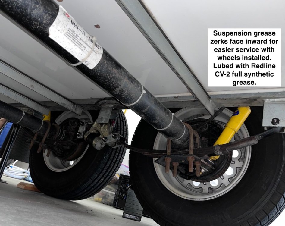

There are plenty of other Ollies to choose from that won’t make you wince when you look underneath. Here is Hull 218, I just sold it a couple of months ago. 25,000 miles towing, stored indoors always. Look for one that hasn’t been towed in winter, the caustic mag chloride and brine  deicers are nasty indeed. Don’t worry about u bolt rust, they all do that within a month, they are raw steel. Just spray penetrating oil on the threads every other year.

I'd be replacing 2017 shocks, anyway. They're likely due.
Much of what I see in photos is relatively light "surface rust". That can be removed with heavy duty scotchbrites, and some likely very  uncomfortable time under the trailer.
However, I see some pitting, possibly deep, that I'd want to explore, further. Blistered pock marks make me very nervous.
The heavy coatings of even surface rust make me wonder about even minimal care and maintenance, heretofore.
Give some serious thought into how much time you want to devote to correcting  deferred care and maintenance.
Interior systems may have been neglected, also.
Some folks can't/don't know how important it is to/ clean chemicals and salt off trailers/cars/ plants.
@Cort:  Definitely take heed to John's earlier comments...  "It's what you don't see that will bite you in the you-know-what."  If you decide to buy this trailer be certain to use the apparent lack of preventive maintenance in your negotiation strategy and learn to spell, "Elbow Grease."  Good luck!

Thanks! I don't mind getting up close and personal with a trailer and scraping that rust off - but I think I would feel better with something else. I actually think she's done a good job with maintenance otherwise but probably just missed this.

Honestly, the rust I see in the photos doesn't look much different from the underside of almost every older car here in Connecticut. It's part and parcel of living in a coastal state that also uses brine to de-ice the roads every winter. Even those of us that frequently rinse the undercarriage still get rust if we drive in the winter. Maybe go easy on the current owner. She may have been taking reasonable care in an environment that simply rusts steel quickly.
The picture shows the zerks pointing inward. On my hull they point outward. Without removing tires, the 90 degree grease gun adapter is necessary. I wonder why this was changed?

New units all now have zerks inward facing upon request.  They could have been swapped at a factory visit if requested...or by the owner to make it easier.
I specifically requested that Hull 218 have them facing inward. This was in 2017….

Yeah, that sounded like a good idea when I installed my EZ Flex system back in 2015 and I did it because all the YouTube videos suggested it. And it would have been a good idea if there was about 18 inches of clearance under the trailer. A year or so later, I swapped them to the outside and replaced all the bronze bushings, wet bolts with added 45 degree angle zerks. Now I can get to all the zerks from the outside without jacking up the trailer or removing any wheels. I can grease them all in about 5 minutes. Before it was a struggle to slither around under the trailer on my back and usually took an hour or so and a ruined T-shirt.
