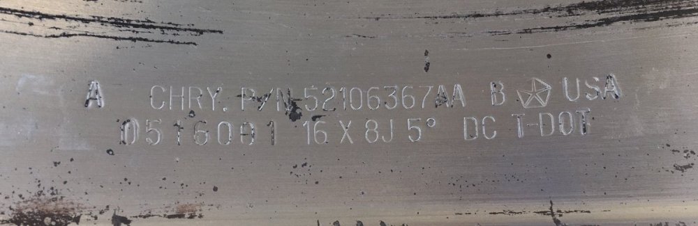

jd1923 Posted September 9, 2023 Share Posted September 9, 2023 Looking for advice, from those of experience with HD tow vehicles, diesel trucks preferred. Thinking on upgrading our 16x8" OEM rims with LT265/75R16 tires, but not sure as the stock rims are Mopar USA manufactured (hard to come by these days). However, there are not a lot of tire size choices for 16" wheels. Dodge and other makes have increased the wheel diameters through the years. I may move to 17" or 18" wheels. This thread is for 2500 and 3500 series trucks ONLY (Ford F250/350). Please NO half-ton trucks or SUVs of any kind. Please reply here with your truck year, make and model and your OEM tire size. Also, please let me know if you replaced your OEM tires and/or wheels with a size you prefer. So many new truck owners are going the other direction, replacing 20" wheels with 18s. Thanks 1 Chris & John in Prescott, AZ | 2016 EII #113 | '01 Ram 2500 Cummins! Link to comment Share on other sites More sharing options...

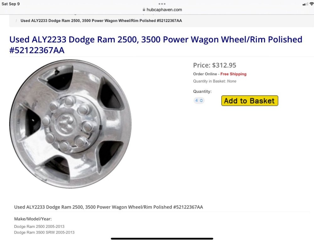

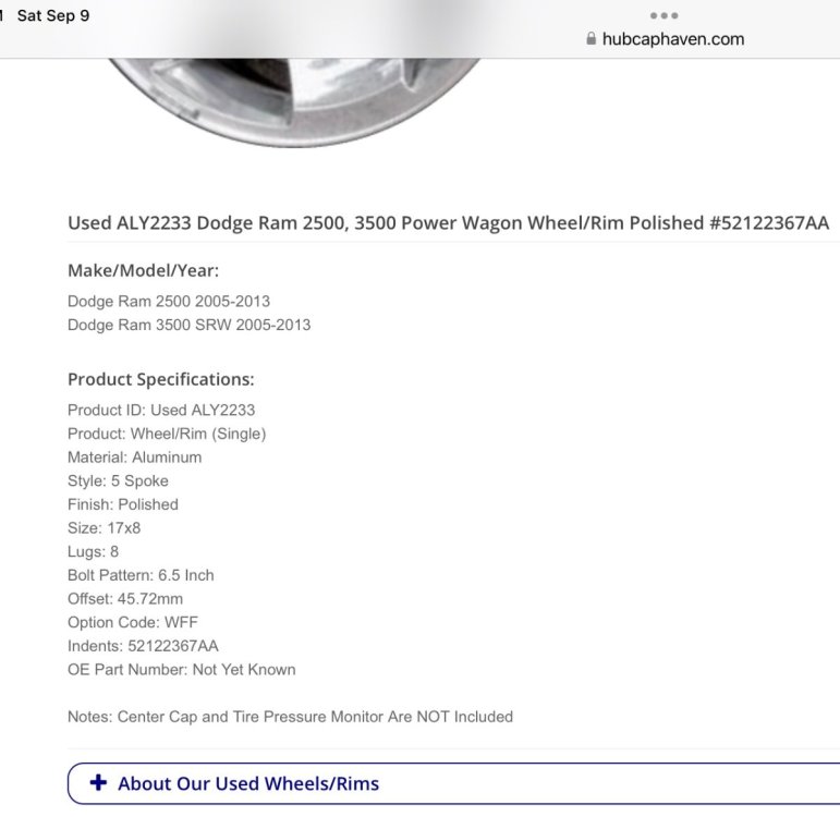

John E Davies Posted September 10, 2023 Share Posted September 10, 2023 I would look for used or reman Power Wagon 17”x8” wheels, for example: They are forged and very high quality. a lot of PW owners change them for some odd reason. If you buy used, a local wheel shop can refinish them for you, one near me said $100 each. Of course that depends on condition, that is for ones that are very clean and straight. I would pick a size close to a PW of your vintage, don’t go larger unless you need the clearance. What is your intent in terms of roads? Do you need an All Terrain or more aggressive? Your Cummins will eat tires if you are not careful in your choice. You have a four speed auto? Be VERY careful about changing the overall gearing, it can move the engine rpm’s out of the sweet spot that gives those wonderful mpgs.. Power Wagon Registry Wheels OEM vs Aftermarket My 2006 Ram 5.9 had stock alloys and stock sized tires. I put on Cooper AT3 LTs and was reasonably happy with them. John Davies Spokane WA 1 2 SOLD 07/23 "Mouse": 2017 Legacy Elite II Two Beds, Hull Number 218, See my HOW TO threads: Tow Vehicle: 2013 Land Cruiser 200, 32” LT tires, airbags, Safari snorkel, Maggiolina Grand Tour 360 Carbon RTT. Link to comment Share on other sites More sharing options...

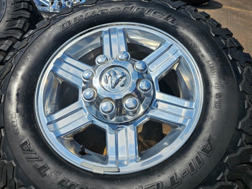

jd1923 Posted September 11, 2023 Author Share Posted September 11, 2023 18 hours ago, Mountainman198 said: My 3500 is a bit newer than yours (next gen as it has 17" wheels). I would not go to a larger wheel on mine as I like taller sidewalls than most new trucks have. I find that a taller sidewall rides better and handles better when towing. If I had your truck, I would stay with the 16's. Keepin it old school, Man! Yes Mountain Man, the other side of my brain is saying, just put good set of tires on my OEM Dodge Premium 16" rims. I would not want 20" with a 60 profile or less but was thinking perhaps a LT275/70R17 vs. what I have in LT265/75R16. Looking at the Cooper specs, all their 70 profile tires will carry up to 3195 lbs. and the LT265/75R16 tire holds 3415 lbs. Will the 75 handle better in towing vs. a 70, or about the same? I also understand that with 17" wheels, I can upgrade to 3rd Gen front brakes and next brake job I will need new rotors (mine has rear drums which limits wheel choice). I like that we have a consensus on the Cooper Discoverer AT3. Their LT and XLT are about the same tires, the XLT has larger sizes, and the outer wall has more AT look to it. I have the AT3 LT in LT265/70R17 on my GX470, because OEM was P265/65R17 and I could get the Cooper AT3 in a Load Range C, which is what I wanted there (not P and not Load E, perfect for the lighter truck). Of course we need Load Range E in a TV. Picking up on JD's idea... I'm not fond of the 3rd Gen 5-spoke wheels, but really like the look of the 4th Gen 6-spoke wheels (see pic). I may have a line on a good set of these. SeaDawg, I do have Pirelli tires on my '84 Goldwing, great tires! Thanks all! 3 Chris & John in Prescott, AZ | 2016 EII #113 | '01 Ram 2500 Cummins! Link to comment Share on other sites More sharing options...

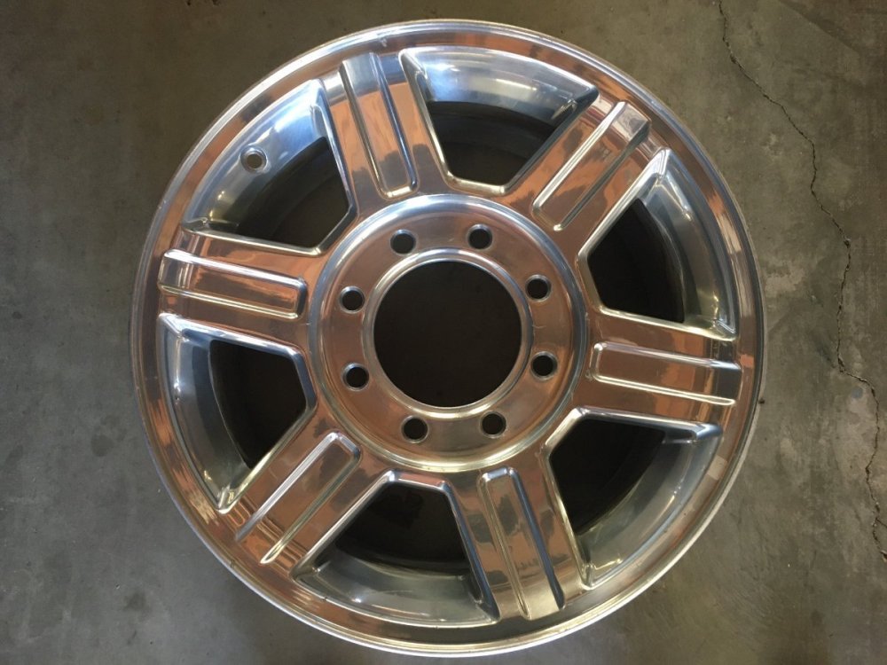

jd1923 Posted September 13, 2023 Author Share Posted September 13, 2023 The wheel pictured above was from an eBay auction. They wanted too much for these (without the tires). I found another eBay auction last night and bought them at a very good price! They will need a little clean-up, but happy to have 17" Dodge OEM forged wheels! (Four center caps are included.) 1 Chris & John in Prescott, AZ | 2016 EII #113 | '01 Ram 2500 Cummins! Link to comment Share on other sites More sharing options...

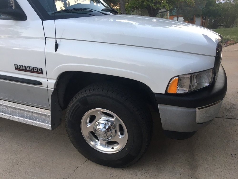

jd1923 Posted September 16, 2023 Author Share Posted September 16, 2023 6 hours ago, MAX Burner said: As noted earlier, we are pleased with the mileage and longevity we've been getting with the Michelin Defender LTX M/S2's since 2017... Yes Art, I remember. I guess I always had that in mind. When I purchased my '03 Ram, back in 2004 barely used, it had the BFG AT tires on it. I replaced them with the Michelin LTX tire of that era, and I can swear they lasted near 100K miles! 2 Chris & John in Prescott, AZ | 2016 EII #113 | '01 Ram 2500 Cummins! Link to comment Share on other sites More sharing options...

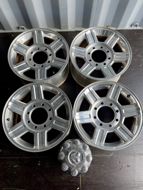

jd1923 Posted September 20, 2023 Author Share Posted September 20, 2023 Just received my wheels yesterday and will soon decide on tires. They look great and more so considering the price. Most eBay vendors want near $300 a rim, center caps sold separately. I found the one auction that had a full set for $500, $100 shipping and $40 tax, an amazing deal for $640 total. I still cannot believe it but they're here now and look good (3 rims and caps are here, 4th expected by FedEx today!). I like the label information. They're not made in USA, like my 2nd Gen premium wheels, but "SUPERALLOY" made in Tiawan, on 9/11 2009. I believe these are forged wheels, and I asked the members of the Cummins Forum to verify. Made in Tiawan is NOT Made in China at all. Tiawan has been making high-quality tools for decades. Craftsman tools, during the 70s and 80s, when first manufactured tools outside of the US, built tools in Tiawan. They were always good, and then later Craftsman turned to China for additional cost savings and their tools turned to junk! Tiawan today is leading the world in high-tech semiconductor manufacturing. See pics... 3 Chris & John in Prescott, AZ | 2016 EII #113 | '01 Ram 2500 Cummins! Link to comment Share on other sites More sharing options...

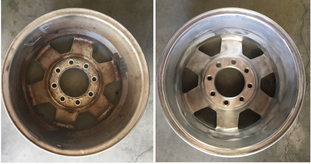

jd1923 Posted September 21, 2023 Author Share Posted September 21, 2023 Had a chance to clean up one today. I got a big old-school Milwaukee grinder with a 7" steel brush wheel. Cleaned up the tire beads too. Here's the before and after! 1 Chris & John in Prescott, AZ | 2016 EII #113 | '01 Ram 2500 Cummins! Link to comment Share on other sites More sharing options...

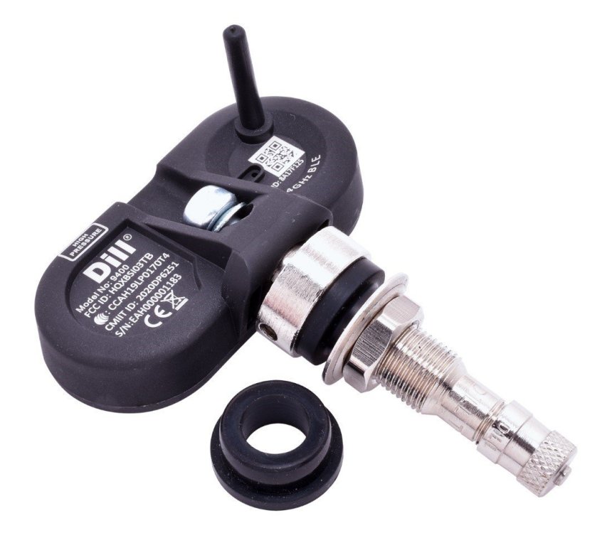

jd1923 Posted September 25, 2023 Author Share Posted September 25, 2023 Holding up on my tire purchase since I want to purchase a TPMS to install in the new truck wheels and our Oliver. I sure have enough other work to do, with the Oliver, let alone the truck and any travel plans will be in the new year. I read some posts here that mentioned Dill TPMS. Did some research and contacted them. They are releasing a new product this October, that seems worth waiting for! What a great reply I received from Dill Customer Service. Here's what Scott said, "Our new system is arriving in October. TireRack.com will likely be the first distributor with parts ready the ship. Please see the attached teaser flyer and User’s Guide. For your truck and trailer you would buy two of P# 1604-V. That gets you eight valve-mounted sensors and eight stems that would be compatible with 0.453” and 0.625” valve holes." You just buy 4, 6 or 8 stems with sensors attached and connect by Bluetooth, and then see your tire pressures on your phone. How great is that? No wiring installation! No proprietary screen on your dash! Can't wait! This is all falling together nicely- Gotta love it! Chris & John in Prescott, AZ | 2016 EII #113 | '01 Ram 2500 Cummins! Link to comment Share on other sites More sharing options...
