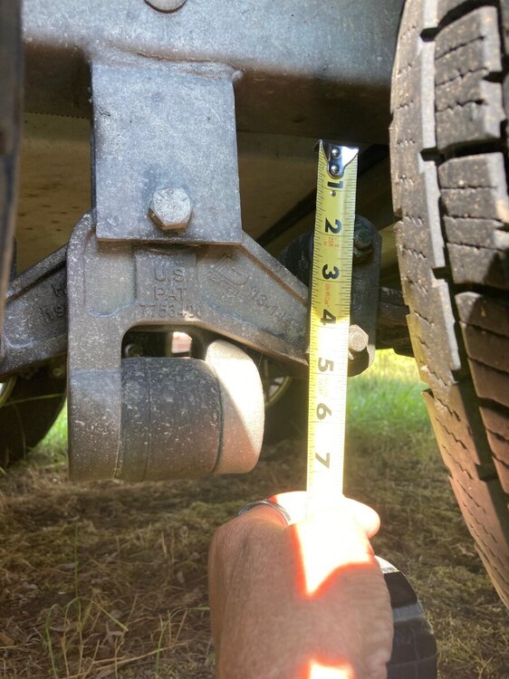

On 8/3/2024 at 11:02 AM, Mountainman198 said:
My Alcans do not hit like yours show, however if they did I think I would taper the square end of the second leaf with a grinder so it would clear.
Let us know how you decide to proceed
I have been away from my trailer since this post but just returned and the first thing I did was inspect the shackles both to measure as well as inspect the gap between the second leaf of the Alcan springs and the dexter equalizer arms. Here is what I found:
-Hull #898 came stock with 2.25” shackles (see pic)
-there was plenty of space between the equalizer arm and the second leaf of the springs (see pic)
-there were no witness marks on the equalizer arms where the springs had made contact
My experience does not mean that every trailer has 2.25” shackles (it appears that at least one E2 had 2” shackles)
IMG_9328.thumb.jpeg.887bd119b9818acfca6136239305ad16.jpegIMG_9327.thumb.jpeg.8d38ef1ac9d80790145b209177ba5a14.jpeg

The EZ Flex kit I installed on LE2 #75 has 2.25" shackles. Assume that's a typo beside the photo saying 2" since you said 2.25" earlier.
The pictures interrupted the text. It has been corrected. Thanks for the alert.

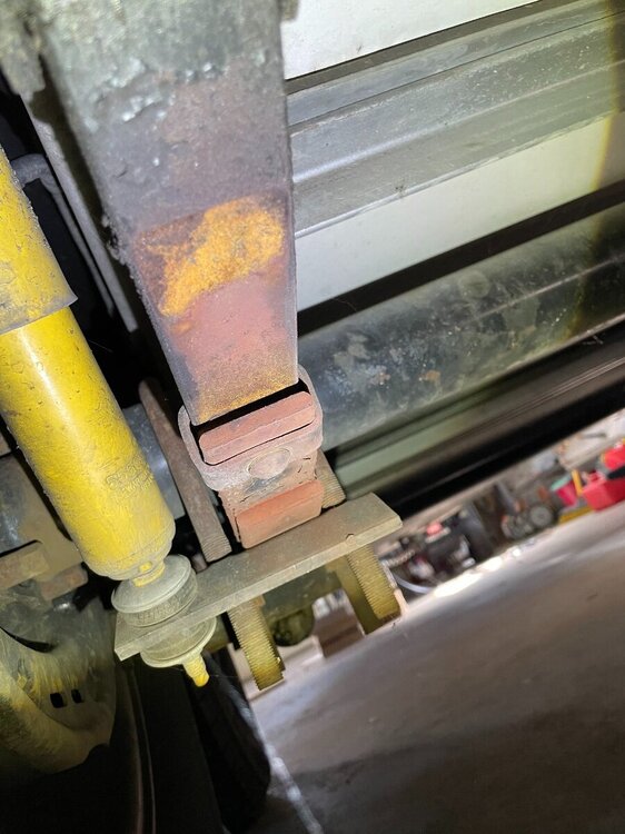

WOW!   We have been sidelined this summer since the aborted eclipse trip and have been attending to other more important issues... So, no camping for us.   But now we are looking at a short trip in October, so I thought it would be a good time to freshen up on recent issues.
And WOW!   What a thread.   Yes.... I read it all.    So, THANK YOU to the brain trust.   It's nice having talented, knowledgeable, articulate, and kind owners to collaborate with.   Really... you guys are awesome.
So, I figured I should get my butt under the trailer for a look see.  First spring looks good... no flattening.    Same for second and third.   Fourth looks good too......   Wait a minute....  The second longest leaf is shorter than it's supposed to be.   Better take a closer look.
See the picture.  The second leaf broke about a half inch shorter than the third leaf.
Guess it's time for a call to ALCAN.  (Sorry GJ)
