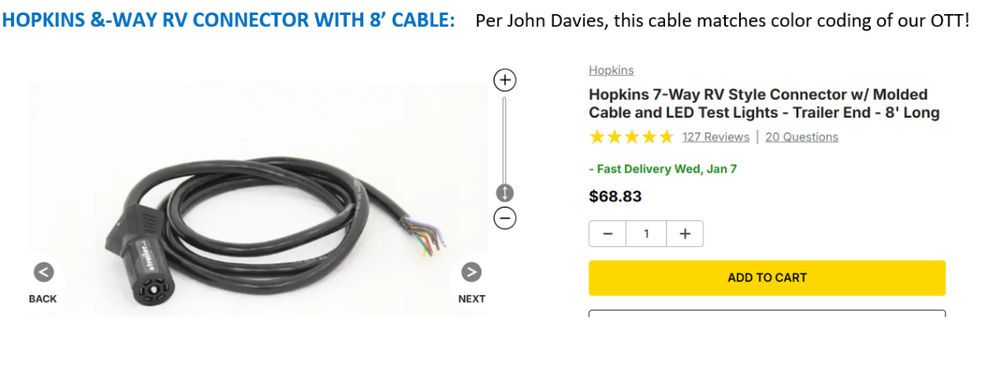

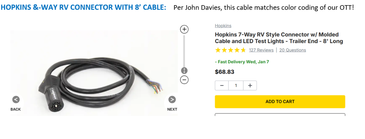

Boudicca: JD is a outstanding standup guy. Comes across some times a bit gruff (Don't we all?), but is pure of heart and giving to a fault. And Chris can sure cook up a wonderfull mountain of pasta as well. I went thru the same process as you, but had the tools and past knowledge to get to the bottom of it. For grins I would suggest you purchase a new seven pin plug for spare parts or use with JD. More than a few ownes like this one if your are going to run the cable back to the J-box as John Davies suggested. If you have a spare few inches in your existing you could just get the 7-pin end. I had those inches and did just the end. Next time I'll have to get the full cable shown below. Amazon.com or Tractor Supply are both good sources for a low of what we need. The cable connections are easy, getting the "Right" wire into the proper peg of the cord is complex. Having the same color to color at the box makes life a lot easier. Good luck. GJ
