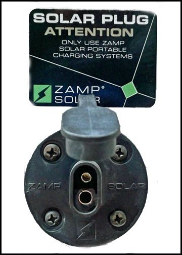

I use the solar accessory plug which is near my 2019 battery compartment for several 12v accessories.  It has a SAE connection that is wired through a fuse to the trailer batteries.  While its SAE connector it set for zamp panels it works for anything you wish.  Just pay attention to polarity as the zamp connecters are reversed from normal SAE. Adapters can be made from that SAE plug to your fridge.
rs=w:1280 Zamp Solar Port On Oliver EII - Note : Top Pin is ( + ) Terminal Bottom is ( - )

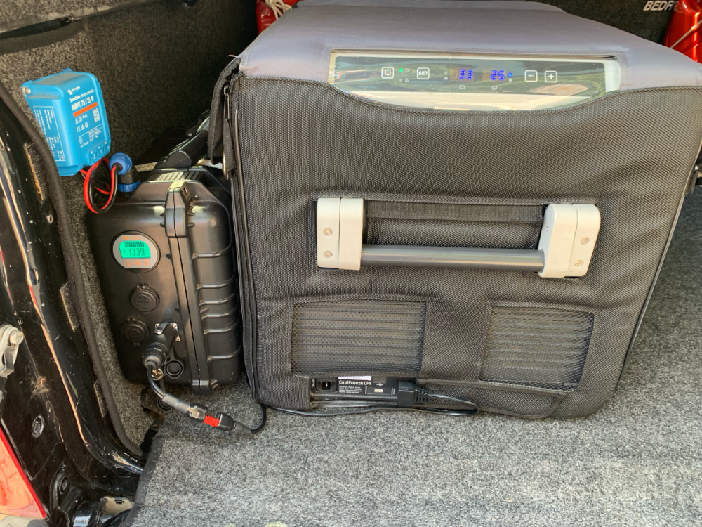

I purchased the Powerwerx plug @Steve Morris highlighted, but returned it because there is no weatherproof way to seal it when in use. Even if mounted inside the propane tank housing there is a chance of moisture intrusion. I keep my Dometic dual-zone in the TV under cap and primarily operate it on a solar portable power station. I’ve never considered taking it out of the TV when at camp; it’s very heavy when loaded, and like keeping it out of the elements and secure from theft.

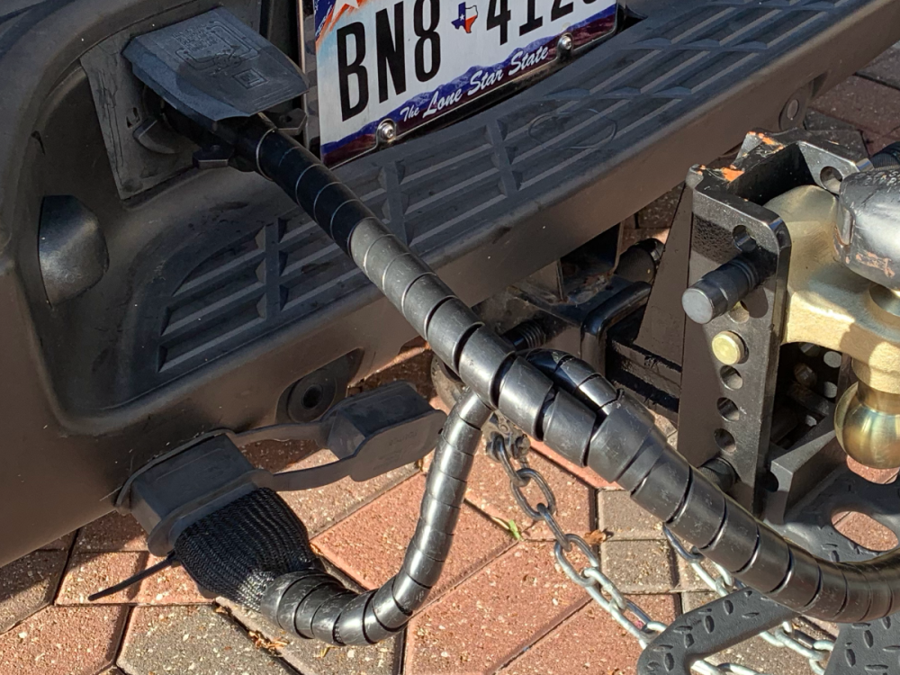

However, as backup I can run it from a bumper-mounted Anderson. Although this particular plug can be fitted with an environmental boot as shown, it is not flush-mount and better suited for a forward rather than a side Oliver mount.
I also use this Anderson to run the Viair.

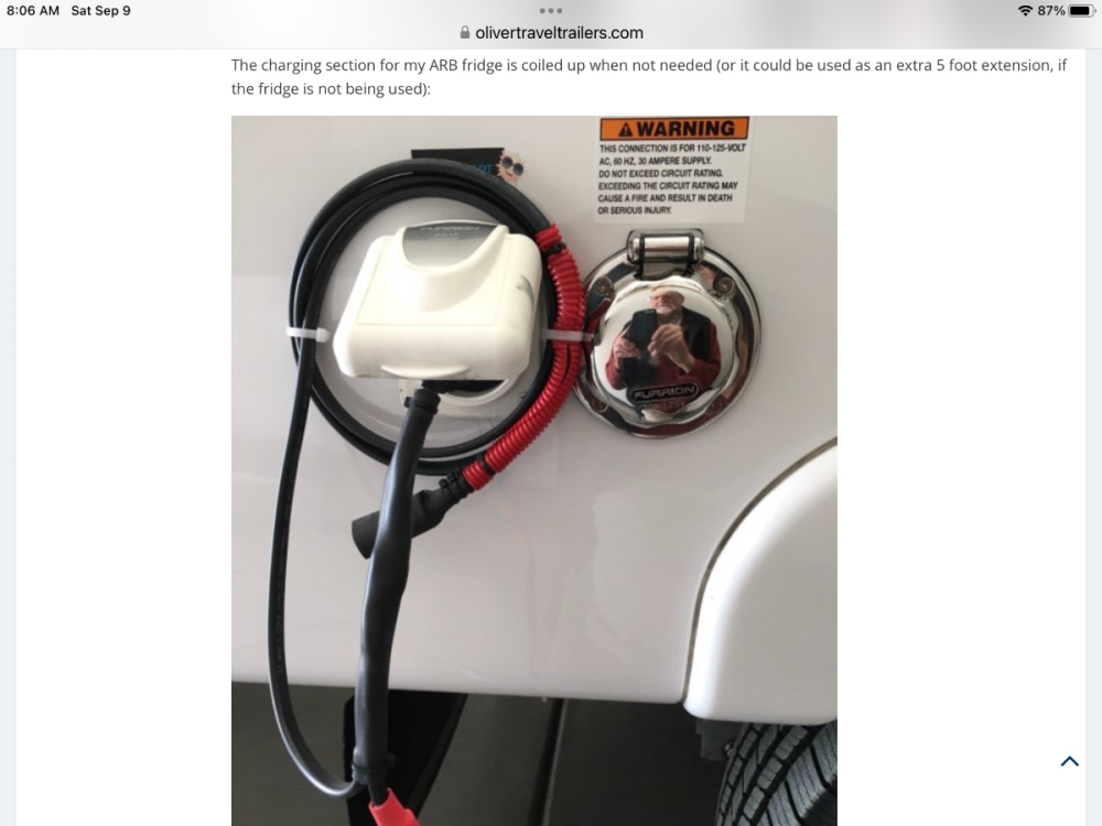

This reminded me of a Furrion Solar Port inlet I believe installed by @John E Davies if memory serves me. I copied this pic for future reference; multi-use for solar and fridge.

The DC/DC connection is the primary purpose of my bumper-mount install, but great for a convenient 12v power source.

For product details, go to powerwerx.com and search ‘environmental boot’.
These boots are completely sealed when installed, front and back. Here is a pic of the ‘source side’ and ‘load side’ boots joined to power the DC-DC in the Oliver, the caps also mate up.

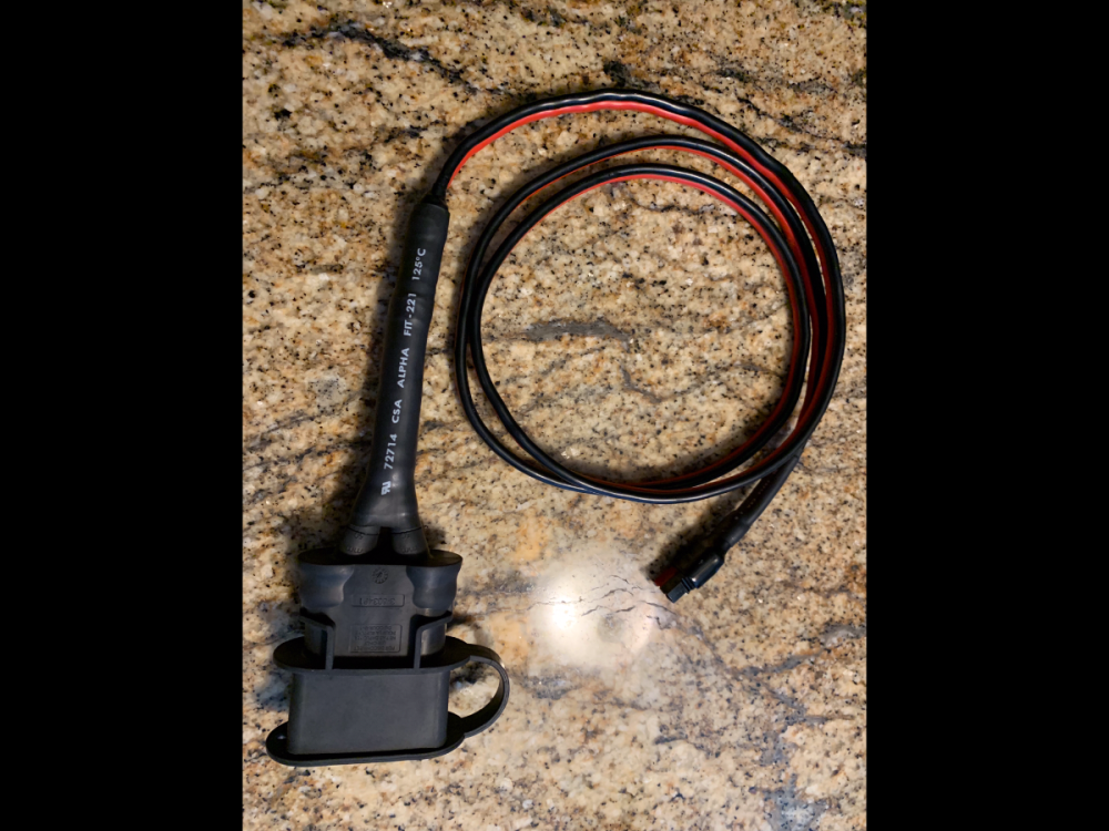

Here is a pic of a plug extension wire (‘load side’ boot) I assembled to enable use of the bumper-mounted Anderson to operate my Dometic dual-zone staged under cap in the TV bed, as necessary.
