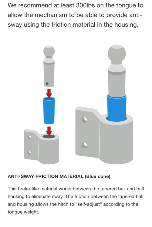

The chains are necessary for the anti-sway function also.  The chains connect to the “whale tail” at the bottom of the hitch ball tapered spindle, and any sway or turning of the trailer causes that ball spindle to rotate against the friction material of the hitch, damping the sway.   If the chains aren’t connected to the whale tail then the trailer bulldog coupler just freely moves on the ball and there’s no anti-sway function.   Here’s a pic from the Andersen website.
Edited by Frank C
Thanks, missed that.  So guess my drive back to Texas from Georgia was an experience of towing with just a normal hitch.
I agree with Frank with a very important additional point. The tapered shank is only held inside the aluminum housing by a snap ring set into a shallow groove. I would highly suggest that if the whale tail is not used, a collar and the safety pin be used it hold the assembly together.

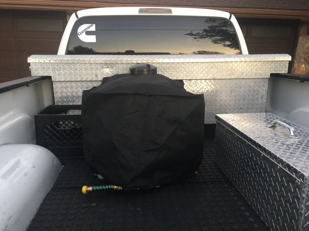

We feel inside storage of the Oliver EII is good with ample room for kitchen, bath, clothes and personal items. Where do you put all the camping items in an SUV? The Oliver has little outside storage. The front bin for generator (we stow a fire ring and cooking grate there). Then you have the awkward trunk. All we keep back there is the shore power cord, hoses, an accessory bag, empty jugs for fuel and radiator emergencies and our campground blanket.
Back of the pickup is needed for lawn chairs, grill and stand, a folding table, tools and much more. To allow boondocking for a full week, we bring extra water too (35-gal tank). The only constraint is the black tank (will just last a week), but no, we're not composting poop. 🤣
Get a pickup truck eventually and make it a 2500! Still use the Anderson, unless you purchase a modern beast of a truck. It will make setup and tear-down quick and easy and if you find something you want to buy along the road, you'll have the room to bring it home.
