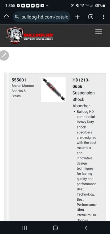

John and Debbie Posted August 10, 2024 Author Posted August 10, 2024 3 hours ago, Mountainman198 said: Seemed to have plenty of available up/down travel with the stock monroes after installing the Alcan springs. I plan to look long and hard at the Bulldog shocks when the monroes wear out I get the impression that the Bulldog shocks are better made. They don't seem very expensive. Is your Monroe shock the 555001. I can look at what the equivalent number is on the Bulldog. Thanks John John and Debbie, Beaverton, Oregon, 2017 Ford Expedition EL 4x4 3.5 liter Ecoboost, with heavy duty tow package. Hull #1290, twin bed with Truma package (a/c, furnace, hot water heater with electric antifreeze option), lithium pro package, picked up November 7, 2022 Alcan 5 leaf springs and Bulldog shocks done May 20, 2025 in Grand Junction, Colorado
Mountainman198 Posted August 10, 2024 Posted August 10, 2024 6 hours ago, John Welte said: I get the impression that the Bulldog shocks are better made. They don't seem very expensive. Is your Monroe shock the 555001. I can look at what the equivalent number is on the Bulldog. Thanks John Yes, stock shock for my trailer is the 555001. Appreciate the lookup of the equivalent Bulldog. 2021 Elite II, Hull# 898 2018 Toyota Tundra, 2003 Dodge Ram 3500 5.9l SRW

John and Debbie Posted August 10, 2024 Author Posted August 10, 2024 5 hours ago, Mountainman198 said: Yes, stock shock for my trailer is the 555001. Appreciate the lookup of the equivalent Bulldog. Here is what I found out. 2 John and Debbie, Beaverton, Oregon, 2017 Ford Expedition EL 4x4 3.5 liter Ecoboost, with heavy duty tow package. Hull #1290, twin bed with Truma package (a/c, furnace, hot water heater with electric antifreeze option), lithium pro package, picked up November 7, 2022 Alcan 5 leaf springs and Bulldog shocks done May 20, 2025 in Grand Junction, Colorado
