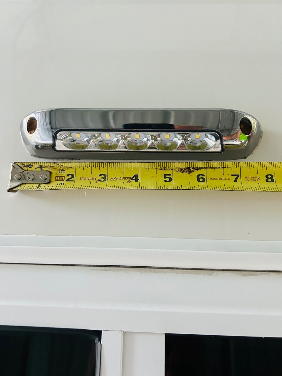

Does anyone know the brand/source for the exterior lights on the EII.  I would like to mount a matching light on my pickup camper shell.

Over the years there have been at least a couple of different patio light fixtures used on Olivers.
Therefore, (as with most things) it would be helpful if you let us know what model and year of Oliver you have.  An easy way to do this is to simply add this type of information to your "signature".

Not sure this is an exact replica of the Oliver porch light, but it appears pretty close.
https://itcshopnow.com/products/assurance-exterior-flood-light?

This one looks pretty close if not the exact one.
ITC -is- one of the suppliers Oliver uses. I purchased table pedestal caps from them, as well as two additional pedestal mounts. I figured I could use them to make a base for the table to use it outside. (Never did)

I have a slightly damaged one and appreciate the source.  Mine is a PLASTIC fixture coated with fake chrome.  It certainly is not worth $44 in my minds eye.   Guess I'll use s small dab of JB weld on the screw hole and re-drill it.
At the Rally I asked Jason about the black gaskets.  He indicated they remove the gasket and silicone the fixture on 3 1/2 sides.  Leaving a weep at the bottom.
