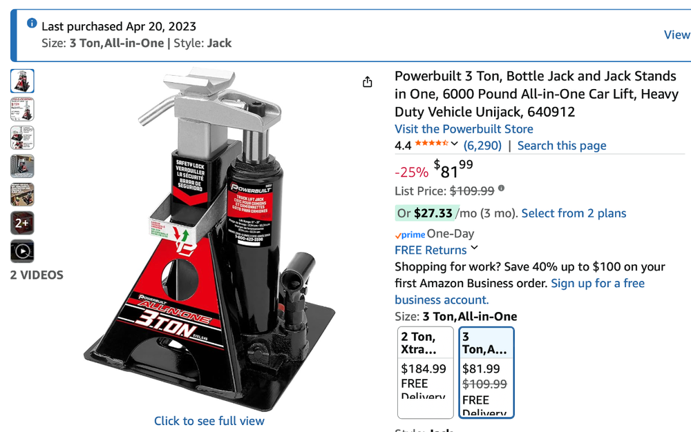

Galway Girl Posted July 6, 2025 Posted July 6, 2025 I carry a bottle jack from Harbor Freight and some "dunnage" boards to stack up for height adjustment as bottle jacks are short. If you have room one of these is great as it also has a catch mechanism that make it lock in place for safety. With this near the front lift point, and the rear jack and dunnage for the rear you can lift one whole side of the trailer if needed. Here's the link to the jack on Oliver Outfitters Guide in amazon. https://amzn.to/3Tm07XU I also have the ramps for quick tire change. Craig 9 2019 Elite II (Hull 505 - Galway Girl - August 7, 2019 Delivery) Tow Vehicle: 2021 F350 King Ranch, FX4, MaxTow Package, 10 Speed, 3.55 Rear Axle Batteries Upgrade: Dual 315GTX Lithionics Lithiums - 630AH Total Inverter/Charger: Xantrex 2000Pro Travel BLOG: https://4-ever-hitched.com Lower 48 + Alaska Achieved in Maine in Aug 2024 on way to Nova Scotia.
Patriot Posted July 6, 2025 Posted July 6, 2025 (edited) This one - https://www.amazon.com/Powerbuilt-620471-6000Lb-Unijack Appears to be similar if not identical to @Galway Girl jack. Edited July 6, 2025 by Patriot 5 2020 OLEII - Hull #634 aka- “XPLOR” 2021 F350 6.7 liter Diesel Lariat Ultimate Tremor aka - “Beast of Burden” Truma Aventa 13.5 AC, Alcan 5 leaf pack, Alcan HD shackles & HD wet bolts, 5200lb never lube axles.XPEL 10 mil PPF front both front corners, 30 lb LP tanks, Sea Biscuit Front Cargo Storage box. ⚡️⚡️11/2025- Lithium upgrade to XPLOR - (2) Epoch 300ah Lithium batteries, Victron 3000W MultiPlus-II, Victron GX Touch 70, Victron Cerbo GX, Victron Smart Solar MPPT, Victron Smart Shunt, Victron Orion XS 1400 DC-DC charger, RV Soft Start. Zamp 90W suit case solar panel for 420W of solar.⚡️⚡️ North Carolina

jd1923 Posted July 7, 2025 Posted July 7, 2025 4 hours ago, Patriot said: This one - https://www.amazon.com/Powerbuilt-620471-6000Lb-Unijack Appears to be similar if not identical to @Galway Girl jack. If you do not have these tools, just buy the one our friend David has recommended, time and time again. Wish I had one, but I have countless old jacks and jack stands. Instead, I carry a bottle jack and jack stand in the TV and every truck I've ever owned. If it was me, somebody needing a jack, I'd buy one of these for safety purposes and go ahead and buy two if you ever plan to work maintenance on your Oliver! This combo tool was not available when we were younger. Enough said! 🤣 2 Chris & John in Prescott, AZ | 2016 EII #113 | '01 Ram 2500 Cummins!

Ronbrink Posted July 7, 2025 Posted July 7, 2025 14 hours ago, Patriot said: This one - https://www.amazon.com/Powerbuilt-620471-6000Lb-Unijack Appears to be similar if not identical to @Galway Girl jack. Yep, I carry two! 2 Ron and Brooxie | Clear Lake (Houston), Texas 2020 OLEll, Twin, 579: No installed solar, dual 30# propane tanks w/GasStop safety devices, Renogy 40A DC-DC charger, 460Ah LFP battery bank/Victron SmartShunt, auxiliary Cerbo-S GX/Victron 30A Blue Smart IP22 Charger combo, interior mounted Hughes Autoformer, twin independent sliding Lagun mount tables, extended dinette table and pantry landing, tongue-mounted hoist, Beech Lane refrigerator Ventilation/Evaporate Coil fans, metal valve stems with TST cap sensors and signal repeater, Waste Master sewer hose management system, Dreiha Atmos 4.4 A/C upgrade/Ceilo Breez Max thermostat, FlagpoleBuddy Starlink Mini suction mount kit. 2019 GMC Savana 2500 Cargo Work Van: Explorer Limited SE, Low-Top 7 Passenger van conversion, 6.0L V8 Vortec, 6-Speed Automatic, RWD; Air-Lift LoadLifter air suspension/WirelessAir compressor; Bilstein B6 4600 Series shocks; metal valve stems for TST tire pressure monitoring system; Buyers Products cargo containment boxes/DC Cargo securement system; rear bumper DC-DC Anderson power cable outlet; 100Ah 12V portable power station/Dometic CFX 75L Dual Zone cooler; front 2” receiver hitch/QuikrStuff Mach2 double bike rack; Mechman 320A high output alternator; Starlink Mini/Veritas Vans magnetic mount.

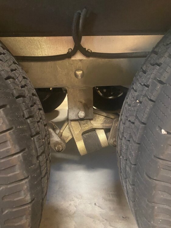

Tideline77 Posted July 7, 2025 Author Posted July 7, 2025 (edited) edit to add my confession, I raised the Oliver off the slab in the shop using both rear leveling jacks and the front jack , while I had it up about 3-4” the tires on both sides sagged back down to touch the floor…….i was stumped, apparently that was the shackle flip 🙄🙄🙄. Now I have one shackle on port and starboard flipped it dawned on me this afternoon reading about shackle flip this was a failed attempt to put the Oliver on car dollys so I could shoe horn her sideways into its storage spot in my workshop. I continue to impress myself with my accomplishments ————————————————————————————————— Please …….Explain to me how to determine if you flipped a shackle ? And how you used a curb to flip it back ???. does this happen on the 2022 models with the bigger axle and springs ? I think I have one side flipped after I used the leveling jacks to raise the trailer……. but I raised both sides 😵💫😵💫😵💫 thank you Edited July 7, 2025 by Tideline77 Robert E 2022 LE II , LIthium Pro, 2018 F150 XLT 4WD 2.7 EcoBoost , 355 gears, tow package,36 gallon fuel, factory brake controller, transmission cooler
Ronbrink Posted July 7, 2025 Posted July 7, 2025 35 minutes ago, jd1923 said: It will work, but the Oliver has an issue with the shackles flipping and this occurred using this jack. I bought my Rapid Jack prior to taking Oliver ownership and soon learned afterwards about the shackle flip issue. I’ve since had opportunities to try it out, but the stabilizer jacks were less troublesome and thus, the preferred method for lift to change a tire. Not one to let good money go to waste, started using it for the front stabilizer support. 1 Ron and Brooxie | Clear Lake (Houston), Texas 2020 OLEll, Twin, 579: No installed solar, dual 30# propane tanks w/GasStop safety devices, Renogy 40A DC-DC charger, 460Ah LFP battery bank/Victron SmartShunt, auxiliary Cerbo-S GX/Victron 30A Blue Smart IP22 Charger combo, interior mounted Hughes Autoformer, twin independent sliding Lagun mount tables, extended dinette table and pantry landing, tongue-mounted hoist, Beech Lane refrigerator Ventilation/Evaporate Coil fans, metal valve stems with TST cap sensors and signal repeater, Waste Master sewer hose management system, Dreiha Atmos 4.4 A/C upgrade/Ceilo Breez Max thermostat, FlagpoleBuddy Starlink Mini suction mount kit. 2019 GMC Savana 2500 Cargo Work Van: Explorer Limited SE, Low-Top 7 Passenger van conversion, 6.0L V8 Vortec, 6-Speed Automatic, RWD; Air-Lift LoadLifter air suspension/WirelessAir compressor; Bilstein B6 4600 Series shocks; metal valve stems for TST tire pressure monitoring system; Buyers Products cargo containment boxes/DC Cargo securement system; rear bumper DC-DC Anderson power cable outlet; 100Ah 12V portable power station/Dometic CFX 75L Dual Zone cooler; front 2” receiver hitch/QuikrStuff Mach2 double bike rack; Mechman 320A high output alternator; Starlink Mini/Veritas Vans magnetic mount.
jd1923 Posted July 8, 2025 Posted July 8, 2025 2 hours ago, Tideline77 said: I raised the Oliver off the slab in the shop using both rear leveling jacks and the front jack , while I had it up about 3-4” the tires on both sides sagged back down to touch the floor…….i was stumped, apparently that was the shackle flip 🙄🙄🙄. Now I have one shackle on port and starboard flipped it dawned on me this afternoon reading about shackle flip Please …….Explain to me how to determine if you flipped a shackle ? And how you used a curb to flip it back ??? When changing a tire lift ONLY the side needing changing. First have the jack up as high to the body as possible and have the space filled with blocks of some type. Doing this, you should be able to get both tires on one side several inches off the ground but only go high enough to remove the wheel. I remember John E Davies wrote a post on the shackle flip years ago which made me aware of it. I believe he had a way to flip it back in the shop, but the simple way is to slowly on an angle tow your Oliver up a curb on the affected side. The other side can just go up the driveway. Service station entrances work well for this. The flipped shackle should flip back. If it doesn't, try again. The one time it happened to me it flipped right back first try. You will hear it and see the leaf springs sitting straight again. 2 Chris & John in Prescott, AZ | 2016 EII #113 | '01 Ram 2500 Cummins!
Ronbrink Posted July 8, 2025 Posted July 8, 2025 11 hours ago, Tideline77 said: edit to add my confession, I raised the Oliver off the slab in the shop using both rear leveling jacks and the front jack , while I had it up about 3-4” the tires on both sides sagged back down to touch the floor…….i was stumped, apparently that was the shackle flip 🙄🙄🙄. Now I have one shackle on port and starboard flipped it dawned on me this afternoon reading about shackle flip this was a failed attempt to put the Oliver on car dollys so I could shoe horn her sideways into its storage spot in my workshop. I continue to impress myself with my accomplishments ————————————————————————————————— Please …….Explain to me how to determine if you flipped a shackle ? And how you used a curb to flip it back ???. does this happen on the 2022 models with the bigger axle and springs ? I think I have one side flipped after I used the leveling jacks to raise the trailer……. but I raised both sides 😵💫😵💫😵💫 thank you I feel your pain! I made the novice mistake of using the rear stabilizers to lift all four tires off the ground to level the trailer for a night’s stay, still connected to the TV. Slept great, other than being awakened once to a loud thud. When getting ready to depart, the realization hit me like a ton of bricks. All four shackles had flipped at the Dexter E-Z Flex equalizers, no bueno! With jack in hand and hours later, toiling in the Texas summer heat, all was back to normal. We learn by our mistakes and that of others. 2 Ron and Brooxie | Clear Lake (Houston), Texas 2020 OLEll, Twin, 579: No installed solar, dual 30# propane tanks w/GasStop safety devices, Renogy 40A DC-DC charger, 460Ah LFP battery bank/Victron SmartShunt, auxiliary Cerbo-S GX/Victron 30A Blue Smart IP22 Charger combo, interior mounted Hughes Autoformer, twin independent sliding Lagun mount tables, extended dinette table and pantry landing, tongue-mounted hoist, Beech Lane refrigerator Ventilation/Evaporate Coil fans, metal valve stems with TST cap sensors and signal repeater, Waste Master sewer hose management system, Dreiha Atmos 4.4 A/C upgrade/Ceilo Breez Max thermostat, FlagpoleBuddy Starlink Mini suction mount kit. 2019 GMC Savana 2500 Cargo Work Van: Explorer Limited SE, Low-Top 7 Passenger van conversion, 6.0L V8 Vortec, 6-Speed Automatic, RWD; Air-Lift LoadLifter air suspension/WirelessAir compressor; Bilstein B6 4600 Series shocks; metal valve stems for TST tire pressure monitoring system; Buyers Products cargo containment boxes/DC Cargo securement system; rear bumper DC-DC Anderson power cable outlet; 100Ah 12V portable power station/Dometic CFX 75L Dual Zone cooler; front 2” receiver hitch/QuikrStuff Mach2 double bike rack; Mechman 320A high output alternator; Starlink Mini/Veritas Vans magnetic mount.

Tideline77 Posted July 8, 2025 Author Posted July 8, 2025 (edited) 😔 I don’t know where to start to correct my flipped shackles, the trailer is tucked in its storage spot and I won’t be pulling it out until November. i can access both sides using the jacks or I can snag the combination jack/ jack stand at HFreight Edited July 8, 2025 by Tideline77 Robert E 2022 LE II , LIthium Pro, 2018 F150 XLT 4WD 2.7 EcoBoost , 355 gears, tow package,36 gallon fuel, factory brake controller, transmission cooler
johnwen Posted July 8, 2025 Posted July 8, 2025 7 minutes ago, Tideline77 said: 😔 I don’t know where to start to correct my flipped shackles, the trailer is tucked in its storage spot and I won’t be pulling it out until November. i can access both sides using the jacks or I can snag the combination jack/ jack stand at HFreight Hi Tideline77....the first and only time it happened to me I didn't know what to do so I called and talked to Hannah in service. She said run the nose jack all the way down. I did and nothing happened. So she said to run the nose jack all the way up and be prepared for a loud pop. And sure enough the shackle popped back into place. Of course raise the rear jacks when you raise the nose so no binding. Good luck, John 2 2022 Oliver II #996 "Bessie", 2019 Silverado LTZ 5.3, Veterans https://wenandjohnsadventure.com/
Tideline77 Posted July 8, 2025 Author Posted July 8, 2025 Thank You my port side rear is flipped and starboard side front is also flipped 1 Robert E 2022 LE II , LIthium Pro, 2018 F150 XLT 4WD 2.7 EcoBoost , 355 gears, tow package,36 gallon fuel, factory brake controller, transmission cooler

Moderator+ ScubaRx Posted July 10, 2025 Moderator+ Posted July 10, 2025 On 7/8/2025 at 1:03 PM, Tideline77 said: I don’t know where to start to correct my flipped shackles, the trailer is tucked in its storage spot and I won’t be pulling it out until November. i can access both sides using the jacks or I can snag the combination jack/ jack stand at HFreight You'll likely not be able to get it fixed in the shop. As soon as the middle shackle flips up, the other end will flip down. You can go back and forth like this for hours if you're enjoying the frustration. Just leave it alone until you're ready to travel in November. I won't hurt it to sit that way. Pull it over a 6 inch curb, listen for the bang and move on. 6 Steve, Tali and our dog Rocky plus our beloved dogs Storm, Lucy, Maggie and Reacher (all waiting at the Rainbow Bridge) 2008 Legacy Elite I - Outlaw Oliver, Hull #026 | 2014 Legacy Elite II - Outlaw Oliver, Hull #050 | 2022 Silverado High Country 3500HD SRW Diesel 4x4
