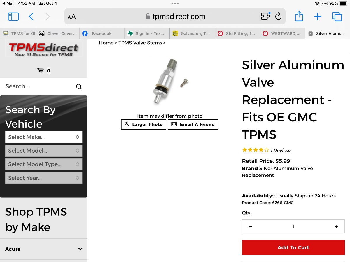

Steph and Dud B Posted October 3, 2025 Posted October 3, 2025 6 hours ago, Patriot said: We have used this system for several years and are very happy with it. I cannot imagine towing our Oliver without it. https://www.amazon.com/TST-507-TPMS-Cap-Sensors We've used the TST system for many (10+) years. We replaced the stock rubber valve stems with steel ones first. (These fit our 2022, YMMV: https://www.oreillyauto.com/detail/c/xtra-seal/tire---wheel/tire-valves---caps/tire-valves---cores/aede909cf322/xtra-seal-bolt-in-valve-fits-rim-hole-diameter-5-8-inch/xts0/17428 ) Definitely get a TPMS, regardless of brand. 1 3 Stephanie and Dudley from CT. 2022 LE2, Hull #1150: Eggcelsior. Tow vehicle: 2016 GMC Sierra 6.0 gas dually 4x4. Our Oliver journey: Steph and Dud B's RV Screed Where we've been RVing since 1999:
