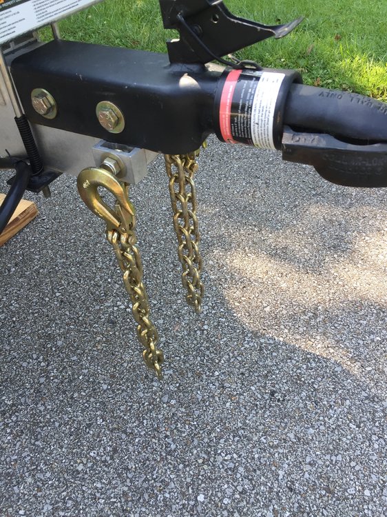

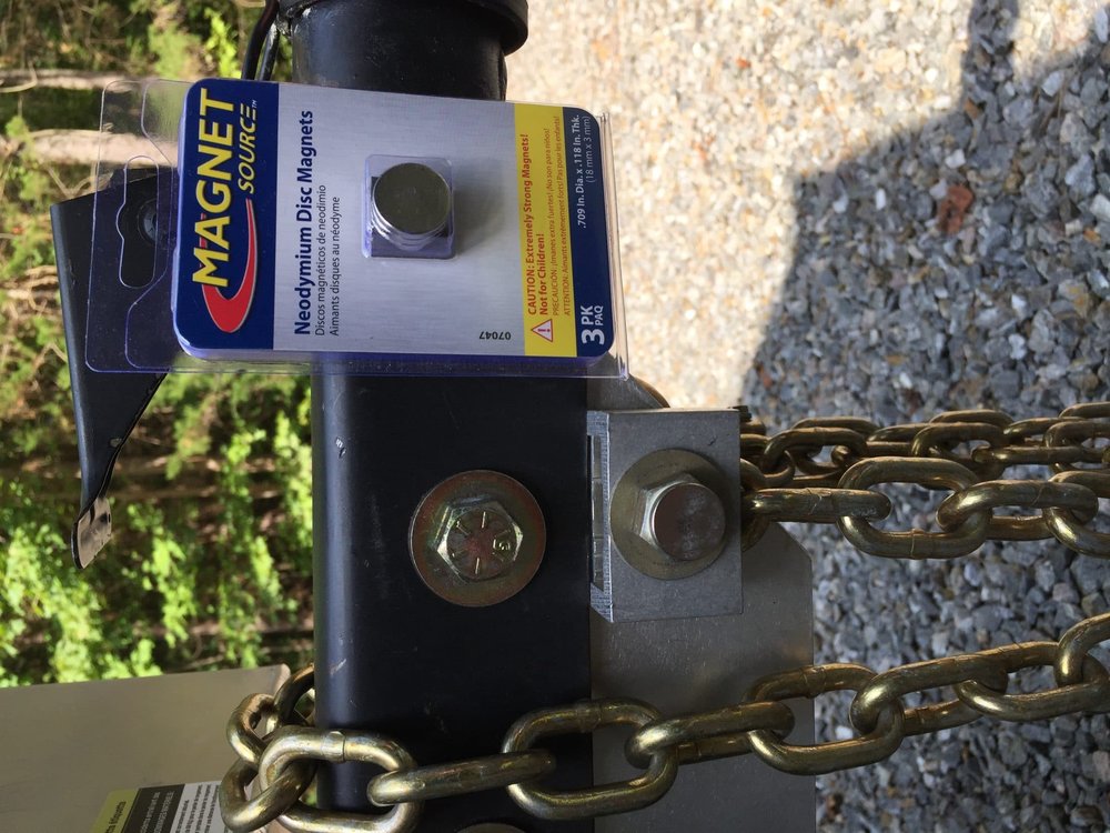

bhncb Posted July 28, 2019 Posted July 28, 2019 The hook and chain grade and size can vary depending on the rating target. The grade 70 x 1/4" I used are rated for 7-12K trailers. A Grade 30 X 3/8" or grade 43 x 5 /16" might be similarly rated. 1
Townesw Posted August 4, 2019 Posted August 4, 2019 The hook and chain grade and size can vary depending on the rating target. The grade 70 x 1/4″ I used are rated for 7-12K trailers. A Grade 30 X 3/8″ or grade 43 x 5 /16″ might be similarly rated. Are those hooks being held by magnets? Need more info please on how you have those chains secured to the tongue. Bill and Martha 2018 LEII Hull 313 Original owners 3/14/2018 2019 Chevrolet 2500HD Duramax
Moderator+ ScubaRx Posted August 4, 2019 Moderator+ Posted August 4, 2019 It appears a large rare earth magnet is glued to the head of the retaining bolts holding the safety chains. Very clever solution. Steve, Tali and our dog Rocky plus our beloved dogs Storm, Lucy, Maggie and Reacher (all waiting at the Rainbow Bridge) 2008 Legacy Elite I - Outlaw Oliver, Hull #026 | 2014 Legacy Elite II - Outlaw Oliver, Hull #050 | 2022 Silverado High Country 3500HD SRW Diesel 4x4

bhncb Posted August 4, 2019 Posted August 4, 2019 Yep they’re just some magnets (see picture) I found at a local hardware center. Put a dab of Marine Tex epoxy and centered on bolt heads. They work better than I expected. 1
