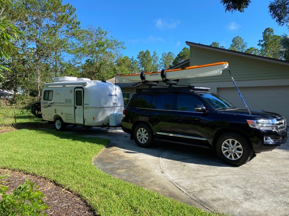

We tow our Casita Spirit Deluxe with a '19 LC200 but are considering either an LEII or a Kimberley Kruiser.
Would love some input regarding "offroading" with the Ollie.  One of our goals is to venture beyond the pavement jungle into more dispersed areas.  We don't intend to go rock crawling, but would like the ability to traverse fire roads, gravel, and rutted/bumpy access roads.  How well does the LEII handle these "roads".  @John E Davies, this question seems to be in your wheelhouse.  @mossemi, we're practically neighbors (we're at Gunn Hwy and Van Dyke Road).

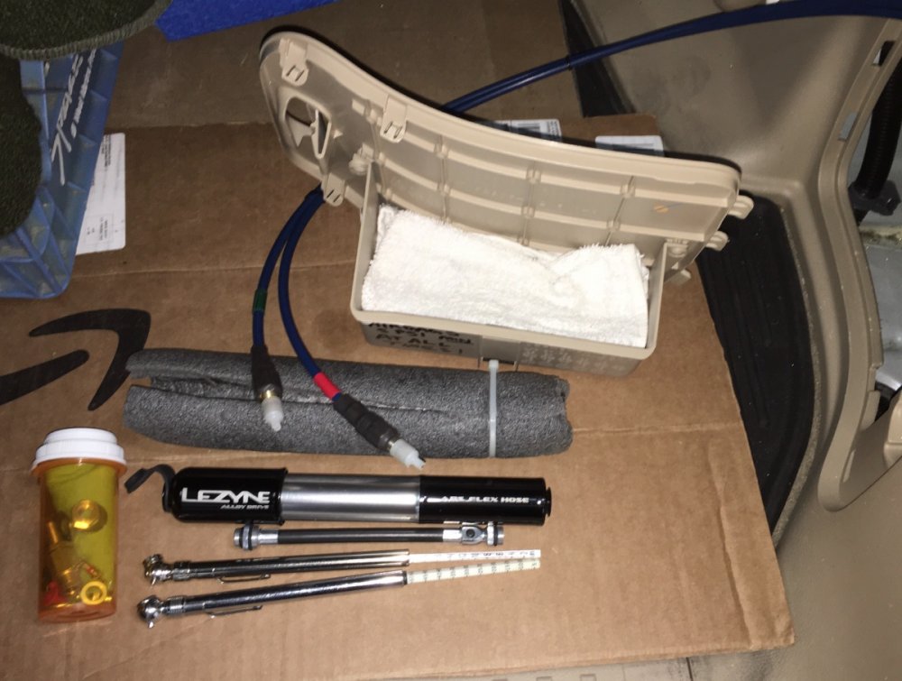

We're getting the LC ready for spring and decided to go the air bag route. I remember @John E Davies mentioning he uses a manual pump for his. A couple questions:
Do the Firestone bags come with a hose fitting compatible with your pump?
What pump are you using?
I'm also just going to have the shop change the oil and was curious if anyone runs 0W-30 or 5W-30 instead of the caps 0W-20. Our 2019 manual specifically mentions using a higher viscosity oil if the engine will be under "extreme load conditions," but most people (including my dealership) don't know or care about that suggestion. The topic has come up a few times on IH8MUD as well.
I'd love to hear from those that actually use their LCs to tow.
Thanks!

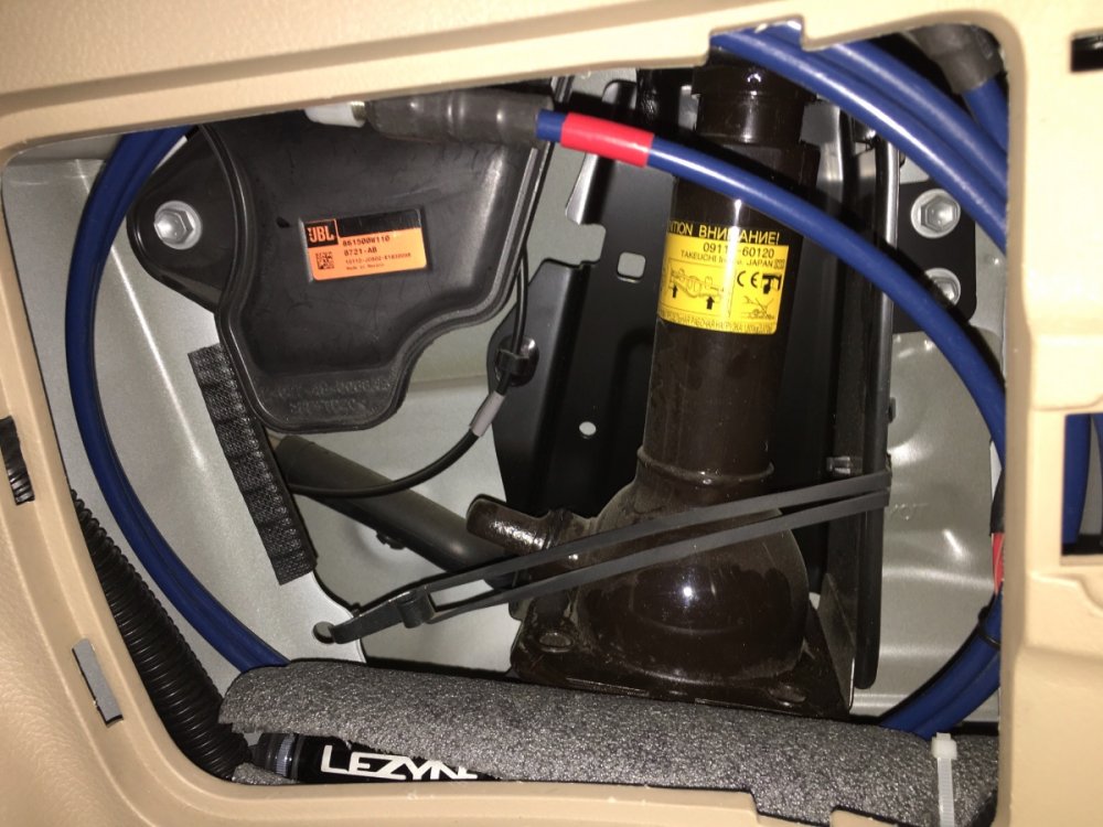

My Firestone airbags came with individual schrader valves that could be mounted externally under the bumper. I asked the tech to run them up into the right rear fender well, at the jack. I added colored tape to ID them, Red Left, Green Right. When not towing, I leave them coiled up in there, when towing I leave that access cover off and run the ends out to where I can reach them easily. There is about two feet of excess length, plenty to allow the valves to lie on top of cargo like my generator.

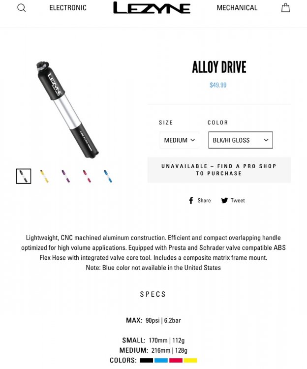

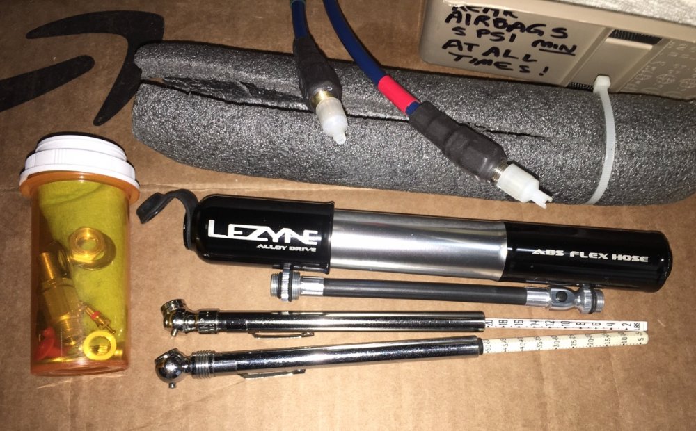

I use a compact low pressure mountain bike pump and two gauges, this one for adjusting at the low end (they want 5 psi at all times to prevent pinching damage).
Milton S-917 2 to 20 psi gauge
And this one for adjusting the high end:
Milton S-921 5 to 50 psi
The pressure you need while towing depends on the tongue weight, I was running 12 psi when the trailer had a TW of 620 pounds. and since I lightened it up to 480 pounds, I backed off to 10 psi, and I leave the Andersen chains almost slack. For towing a trailer with no WD hitch like a Uhaul rental it would be higher.

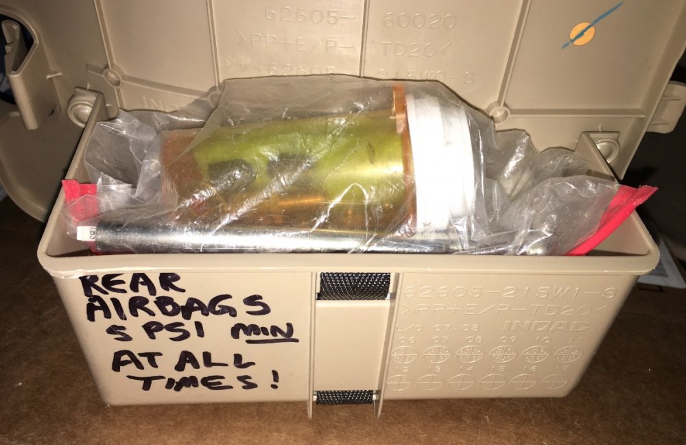

The gauges and spare valve caps and cores, and an extra schrader valve, fit in a 1 quart zip bag and when NOT towing, they ride in the little cubby inside the jack cover, and the pump gets covered by some foam water line insulation and tucked in the bottom of that compartment next to the jack.  When towing I leave them out in the open so I can adjust pressure without having to shift any cargo.
You can drive the truck with 10 psi in the bags and no trailer, but it rides VERY rough and the butt sits high, so if you plan to drive any distance, especially on unpaved roads, lower the pressure to the minimum. They specify 5 psi, but I am actually using 4 psi, a very little change of air pressure at the low end makes a big difference to the ride. Going from 5 to 4 psi is a 20% change. Going from 20 to 19 psi is only a 5% change.
An onboard pump and gauges would be very nice, but every connection and splice gives you a potential leak point. I prefer to have a very minimal number of  splices.
For inflating, the bike pump takes about thirty pumps per side, then I disconnect and reduce the pressure to the correct psi using the gauge.
I hope that answered your questions, and more. 😬
