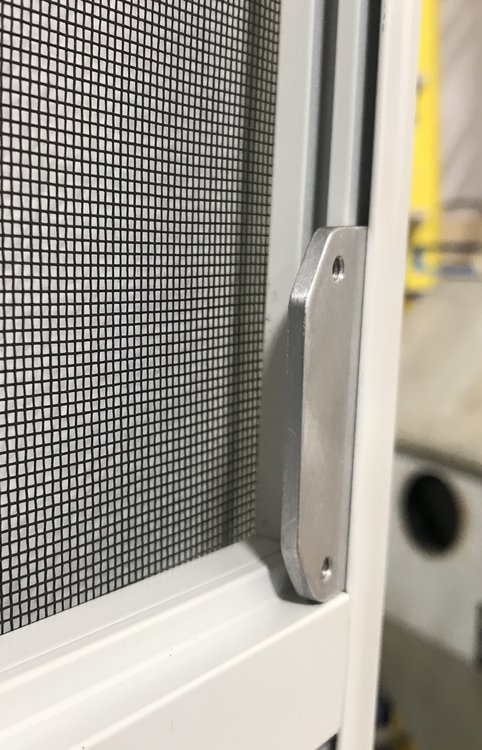

Bill -
I'm not sure about "a cleaner installation", but, I would think that it is a bit stronger.  Those four small screws holding the handle on in the typical installation are screwed into such thin aluminum.  I always try to remember to tell "guests" to not put too much pressure on that screen door handle - the aluminum door simply is not strong enough to handle any real weight.  At least your design helps spread any weight over a larger area.  Besides, it is simply cool.
What a wonderful solution you devised! I have that same handle but have been too afraid to drill into the door to install it.  If you do make some to sell at the rally I would certainly buy a pair!

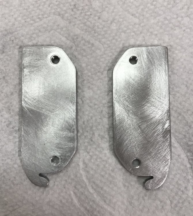

Thanks Mark. I know those folks over at G&H. I may run it by Barry and see what he can do it for. I made these two with a hacksaw, files and emery cloth. Certainly wouldn't want to make many that way.

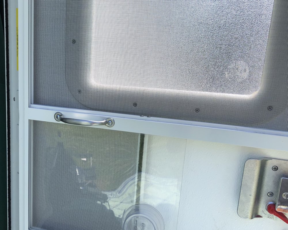

At the Oliver Rally several people commented on my low tech solution to the door handle problem.
The handle was $2.50 at Ace Hardware, and I used two sheet metal screws. I decided on this solution after reading Topgun2's post about the screen door handle, and that the bar did not have the strength to support someone when getting in or out of the camper.

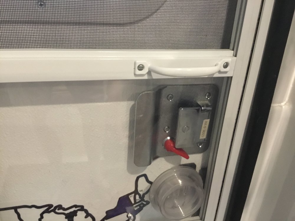

I did the same thing last year. Home Depot only had white handles, so that’s what I got. A little retro, reminds me of our screen doors when I was a kid.

Interesting that each of you chose a different side of the screen door to install the handle.
Thank you for making us a set and installing our screen door bar at the rally! It really does make the door sturdier ?.
Yvonne & Doug
Hull #223
Mike and Carol's placement of the handle near the latch means that it takes less force to close the door.
My placement of the handle near the hinge means that I don't have to lean out very far to grab the handle.

This mod of Bill's no drill door handle made the Oliver Newsletter. We love ours and it looks and works great. I guess Oliver liked it too!

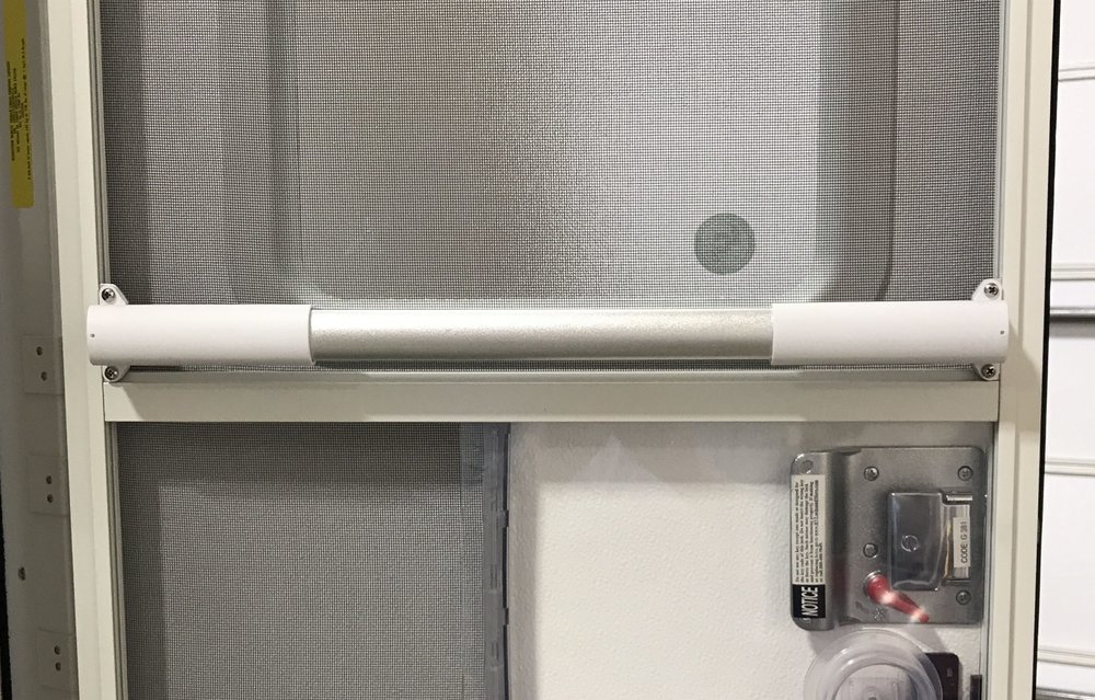

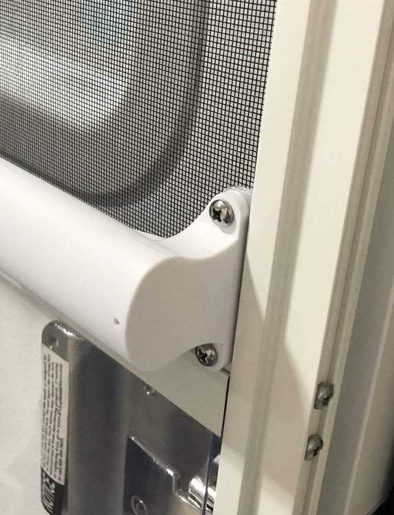

To add to the previous installs,  its not NO drill, but its clean and simple.
https://www.amazon.com/gp/product/B0012GTVVA/ref=ppx_yo_dt_b_asin_title_o00__o00_s00?ie=UTF8&psc=1
I picked one of these up, its a clean install.
Seems sturdy enough, solid.
[attachment file=screen door bar.jpg]
1/8 drill bit, a little blue painters tape for protection, and a Phillips screwdriver. About five minutes.
RB
I do not know how to rotate this once its in the forum?
RB -
I did the same as you - really easy and quick.  However, make sure that you warn people to NOT use the screen door handle for support when getting in or out of the camper.  I'm certain that both the handle and the door could not stand too much pressure - that is what the inside and outside handles that were already on the Oliver are to be used for.
We've had ours installed for nine months now.  Still as solid as day 1 and our son is not gentle with it at all.  Very happy that Bill made and sold these.
