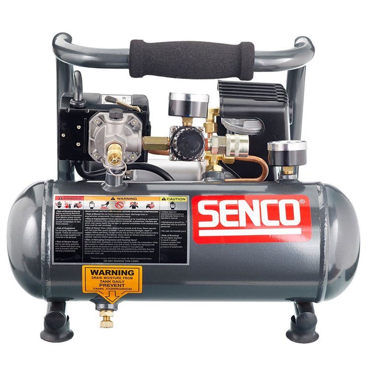

I use a small compressor by Senco found at lowes. It’s small lightweight has a 1gal tank nice carry handle. I think it has 150psi max pressure don’t quote me on that. It’s used for nail guns works great for tire inflation. It will run to keep up with filling tires with low pressure but does the job. Cost around $150. There are many options out there for compressors small also look at off road  portable they also have compressed air tanks that hold 3500 psi but getting them refill is a pain. Lot of options good luck.
I looked it up its 125psi max and now at Home Depot for $129
