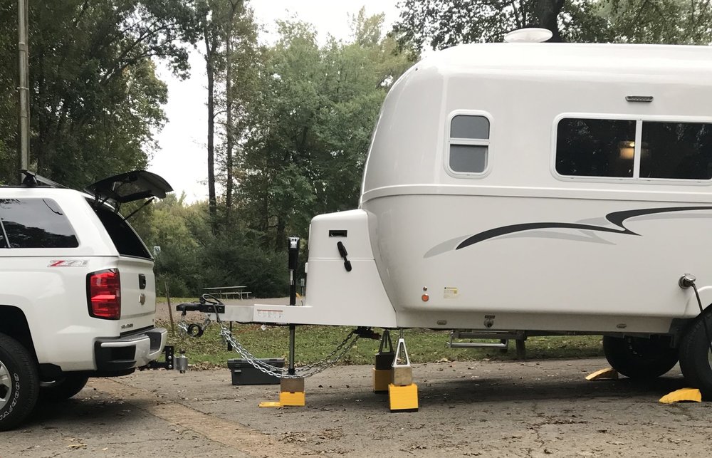

snowlakemike Posted March 30, 2019 Share Posted March 30, 2019 Snowball's photo could well be of my unit, Hull 64. The two front jacks were installed by the previous owner at some point in response to his wife's complaint (same as your wife). I agree they are an eyesore. I agree that there is some degree of risk in having them sticking out from the frame. They DO, however, help to greatly decrease trailer movement as you walk about the diniang and bath areas. That said, we never bother to deploy them unless we are to be parked a week or greater. The little rocking in the Ollie as delivered by the factory, does not bother us. 1 Mike and Elizabeth Smith Snow Lake Shores, MS 2016 Ford F150 3.5 EB, max tow (20,900 miles pulling Ollie since Sept 2016) Link to comment Share on other sites More sharing options...
Overland Posted March 30, 2019 Share Posted March 30, 2019 Could be, Mike. That would have been last April at the factory when I snapped that shot. I was thinking about it the other day and thinking that if you selected just the right sized bolts for mounting the jacks, that it's possible they would just break off if hit rather than damage the frame. Still, it would make me nervous. I bonked our steps once, turning from a paved road with a low shoulder onto gravel, and took good chunk of asphalt out of the road in doing so. It did no damage to the trailer other than slightly ding the mount to the steps. I probably wouldn't have been as lucky if the road had been concrete. Link to comment Share on other sites More sharing options...

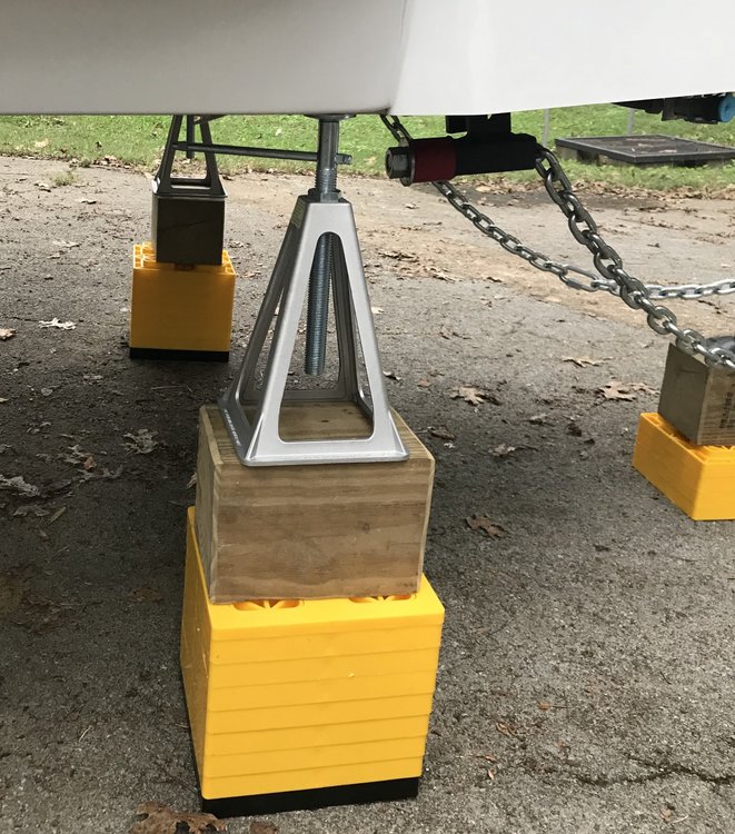

Townesw Posted April 7, 2019 Share Posted April 7, 2019 Last fall we parked in a really steep campsite with the tongue high off the ground. I had purchased a pair of Camco screw type stabilizer jacks on the way to this campsite. I rigged them as shown in the photos. I only snugged them up against the frame so as to stabilize the camper, not to take weight off of the front jack. With these stabilizers in place and the rear jacks extended the trailer was very stable for the 4 days we were at that campsite. I will continue to use these as shown, probably not for “one night stands” but for extended stays in one campsite. I would not use these as jack stands, only stabilizers. They are very light but work well in this application. Bill and Martha 2018 LEII Hull 313 Original owners 3/14/2018 2019 Chevrolet 2500HD Duramax Link to comment Share on other sites More sharing options...
