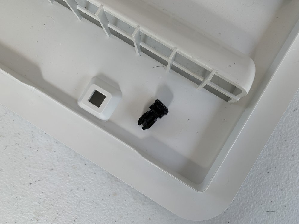

Not sure this is the best topic category to place this suggestion, but since you folks are discussing refrigerators, here goes.
I just noticed my 2019 Oliver LE2 (Hull#444) Norcold Refrigerator outside vent door was missing one of the two plastic vent door clamps.  I found this on Amazon and suggest folks order a spare or two unless someone has devised a better way to keep the vent door in place.
KWR
FYI: Not that this requires any special skills or tools but, if you never installed one of these just know it’s a one trick pony. Once installed, they won’t come back out without breaking.

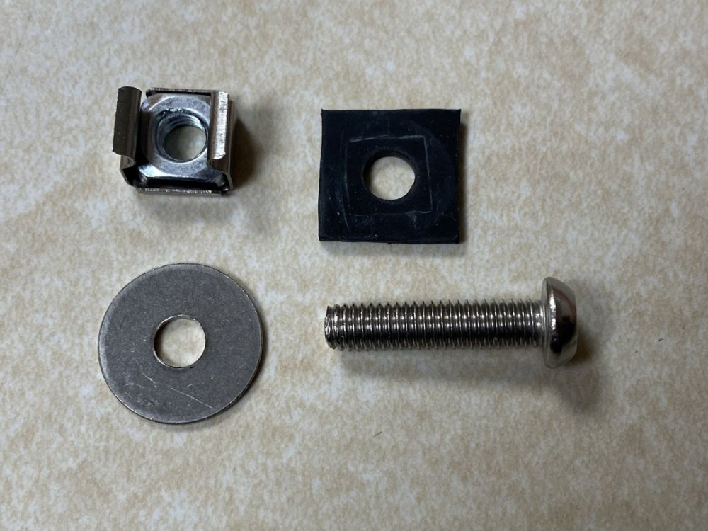

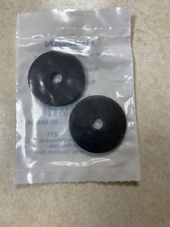

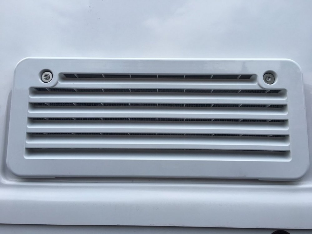

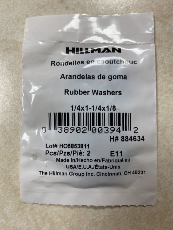

IMG_6783-a.thumb.jpg.8e505f837eca4aa2c5739255b26fa885.jpgIMG_6782-a.thumb.jpg.fdcf19d4a3aef35435283df9a5c0ecb0.jpgIMG_6780-a.thumb.jpg.a633140ccca59a9bce1782c2f947dbd8.jpgIMG_6781-a.thumb.jpg.5bcee9502fec6f14dcdc127fe4d54902.jpgIMG_5187-a.thumb.jpg.ec9e0a8a951d2c80f9b3e4c6aafde4b0.jpgIMG_4897-a.thumb.jpg.c0356bc65712abe173955584ce89322f.jpgI have also lost a few of those black plastic retainer clips for the refrigerator vent covers somewhere "on the road"...
I was able to replace them with a more reliable fastener - a cage nut, machine screw flat metal washer and flat rubber washer.
I happened to have in-stock some M6 cage nuts designed to fit into a 1/4"x1/4" square punch-out in the side rails of a 19" computer server rack. They fit perfectly into the square hole in the refrigerator vent trim ring (inserted from the inside) designed to capture the black plastic retainer clip.
Since my cage nuts are metric, I had to use metric machine screws. You can just as easily use inch-sized cage nuts and machine screws.
The upper and lower vent covers require slightly different washer sizes and machine screw lengths as detailed below.
Upper Vent: M6-1.0x20mm machine screw, 6mm or 1/4" x 3/4" diameter steel flat washer, similar size round rubber flat washer.
Lower Vent: M6-1.0x25mm machine screw, 6mm or 1/4" x 5/8" diameter steel flat washer, similar size square rubber washer.
Flat washers and machine screws are stainless steel. Rubber washers are cut down to fit from a larger rubber washer. If you want you can select machine screws with security heads (security torx, security hex, etc...).
CAUTION: Do not tighten machine screws too much - they will crack the bracket with the square opening in the trim ring that holds the cage nut in place (don't ask me how I know this LOL). Snug but not real tight. The rubber washers are there for this purpose. Periodically check machine screws to make sure they haven't self-loosened.
I am happy to report they also work on the Dometic RM2454 vent covers as well.  Although I didn’t lose one, I did break one on my upper vent.  My refrigerator exhaust fan does not start when I turn it on, so I remove the cover and spin the blade and it starts running.  The fan issue is on my list of things to do but the button is replaced.
