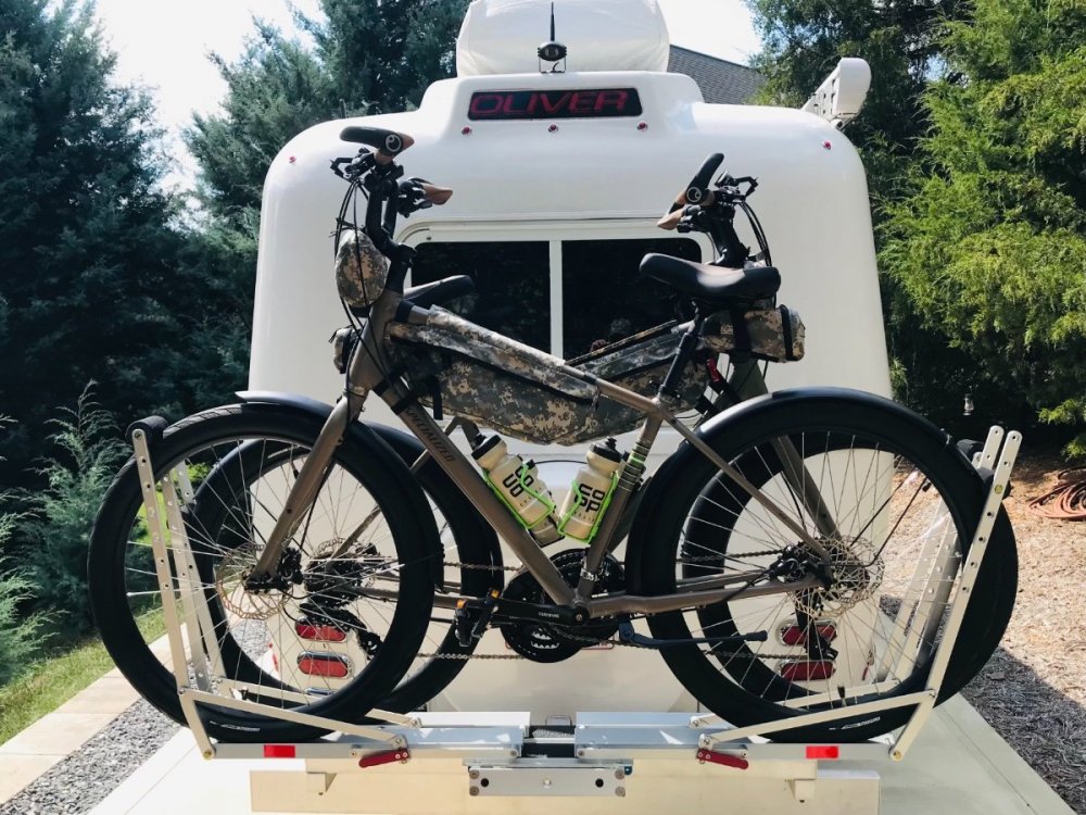

The Oliver LEll owner I have spoken with the same rack and mod actually carries (2) much heavier ebikes with a total weight on the rack of 130#. He recently put 1000 hard miles on his Ollie with bikes loaded and there are no visible signs of aluminum fatigue, cracking etc. Zero issues with the 1Up Super Duty rack which is encouraging news.
This mod is absolutely worth keeping an eye on for sure. Just like all the other inspection checklist areas on the Ollie, I will inspect it before, during and after a trip.
A great question would be with over 800 plus Ollies on the road, how many actually use the bike rack and for those that do how many catastrophic failures have occurred with the bike rack?  I have not read about any reported failures which is a good thing!

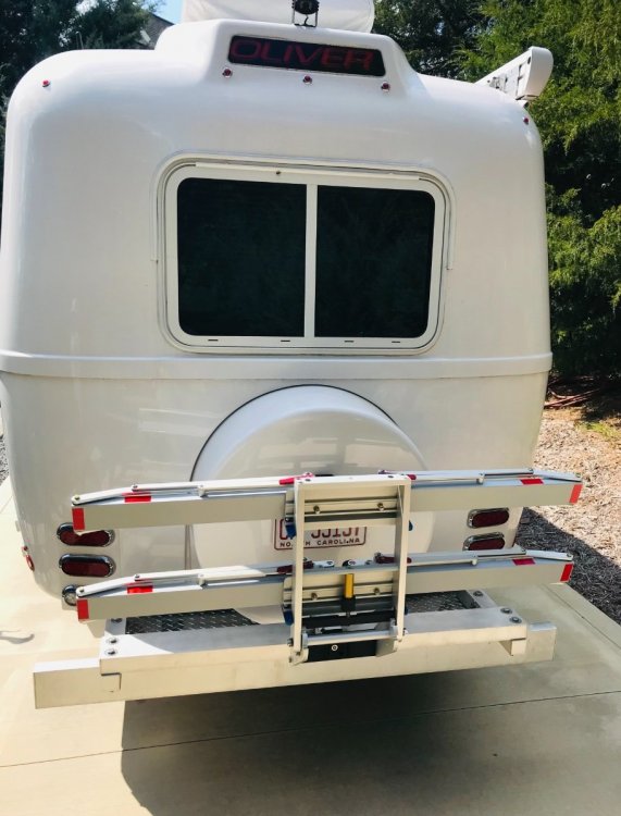

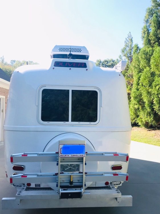

1 Up USA “Super Duty” bike rack installed. A fine product including fit and finish.
Mounted to Oliver bike rack.
Rack folded up when not in use.

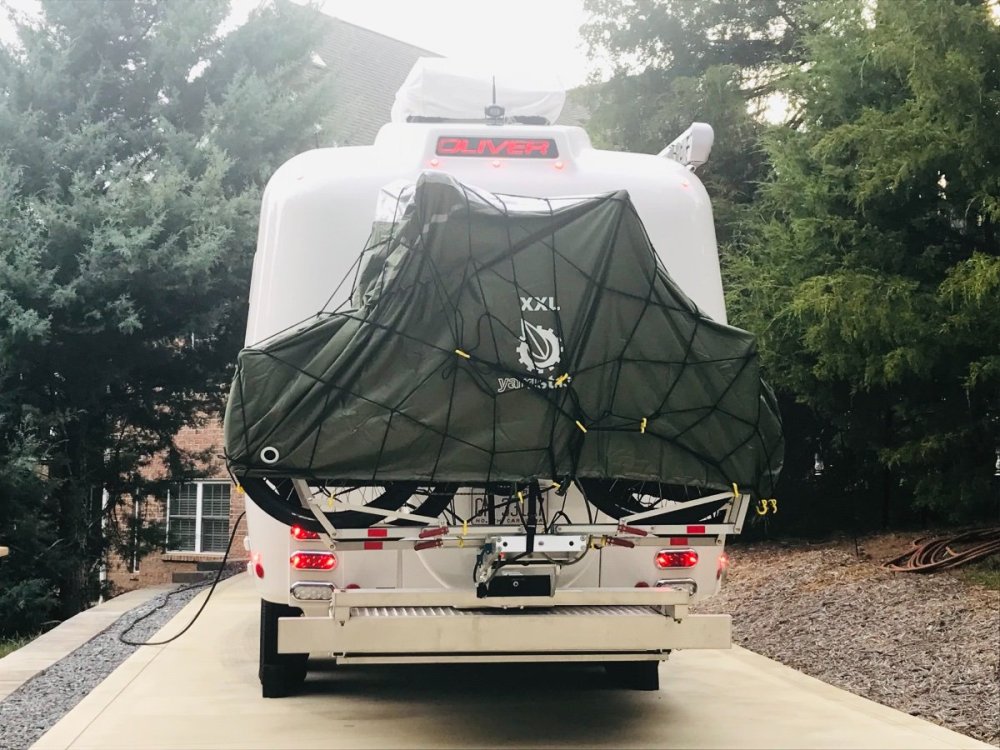

Added a “Yard Trash XXL bike cover and elastic cargo net to snug the cover up to the bikes. This should help keep the bikes clean. No issues with real tail light visibility even with these covers on.
I installed the 1Up USA a license plate relocation kit. Nice quality and now zero visibility issues with my plate. We will leave this bike rack permanently  installed on our Ollie. We like taking our bikes when we  travel.
Rack deployed -
Rack stored or when not in use -

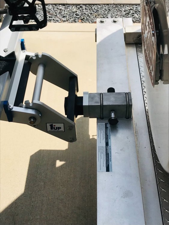

On 9/29/2021 at 5:05 PM, Patriot said:
Why did you decide to paint those parts? What primer/ paint did you use? Is there any rack motion at all at the connection? Thanks.
The rack arrived exactly as pictured, I did not paint anything. There is no motion in the rack connection, it’s a very solid mount.
I meant the sleeve, which is u-bolted to the Ollie rack….. it sure looks black to me.
I’m glad there is no motion, that is very good.
JD -
I believe that it (the color) is being caused by the lighting in the photo.  Note the color of the aluminum where the "1up" sticker is located - much the same color as you are referring to on the sleeve.
59 minutes ago, topgun2 said:
JD -
Bill, JD,
That is correct, lighting in the photo caused it to look a shade darker.
David

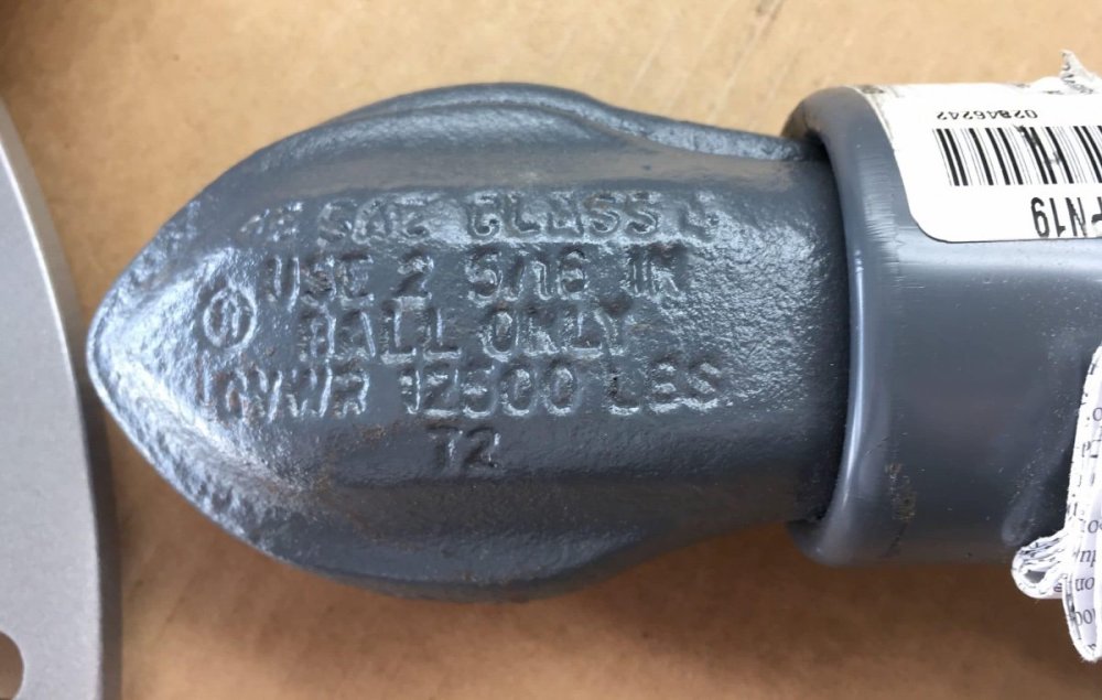

The problem is that all bike racks (I've found) that are "RV approved" require a 2" receiver.  If you use an adapter for a 1.25" receiver, it voids the RV delineation.  I was told by service at Oliver that the chocking down of their receiver was a result of some dummy using the older 2" receiver to tow a car behind the trailer.  I understand their concern but the stickers they currently attach to the receiver area clearly states the weight and usage limitations.  By supplying a 1.25" receiver, Oliver is charging $800 for a unit that should not be used for what it is intended to do.  Safe or not, they are minimizing their liability by maximizing ours
That is a pretty harsh statement, but I happen to agree with you 100%. Stickers can easily be removed in a few minutes, Oliver should instead provide a proper heavy wall 2” receiver, and STAMP or LASER ETCH DEEPLY the weight and use limitations into the top surface of the receiver. Then let the user decide what to plug in there. An owner may say, “Oh, the label came off, I did not know!” It is pretty hard to say that with deep cut letters, you would literally have to grind them off…..  Let the customer accept all liability for what gets plugged in…. just like this coupler.
I personally think that the receiver part should be stainless steel, but at this point in the discussion, that is splitting hairs.
As a side note, IMHO somebody stupid enough to tow a car or trailer behind an Ollie will just add an extra step down adapter anyway, regardless of the receiver hole size. Making an engineering change like this one based on one fantastically dangerous customer makes no sense to me at all.
Oliver can't fix STUPID.  So why treat all of as if we are?  I'm with you JD!

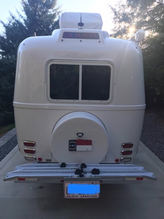

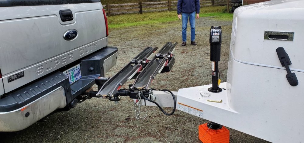

1653712954_1UPbikerack.thumb.jpg.94ef29cc25482ea9b6ae3b85fd950210.jpgI've posted this previously, but in case you haven't seen it.  We use this hitch with our F350 towing an Elite II.  Hitch is rated for 7,500#.  This will not work if you have the tongue accessory box on the trailer.  Only once have we had a radius turn clearance issue, but it is easily solved by folding the rack up (which can be done with the bikes still loaded), or you can take the bikes off the rack and fold it up, if necessary.  Bikes stay relatively clean mounted here.
Patriot - did you use the "stock" Oliver receiver or did you take the 1.25" off and replace it with a 2"?  Really like this setup and while we normally carry our bikes under the truck topper, this would be a nice option to explore.

Brian,
I used the stock Oliver receiver and have had zero issues. We had the 1.25 insert removed by a local machine shop.
Hope this helps!
Patriot
I too had a machine shop remove the insert for our two inch bike rack. It has been rock solid. A7F5E059-495A-438E-9557-33C01FFDDE51.thumb.jpeg.00ced2f41674d082f59a4d9083dc5a83.jpeg
