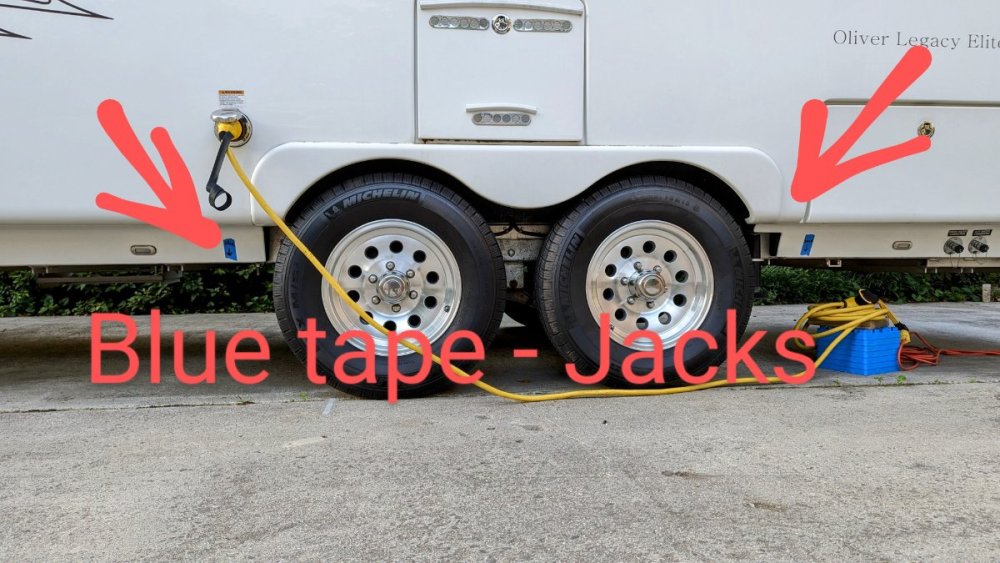

Moderators Wayfinder Posted May 10, 2023 Moderators Posted May 10, 2023 In 1 hour I go to the tire shop to get a new tires have marked what I think is the best place for jack points. Based off of your pictures. My 2016 doesn't appear to have extra metal under the frame, but these points match your descriptions. I've also noted potential damage to propane lines on the passenger side. 1 Chris 2016 Legacy Elite II o-o Hull #110 o-o "Rock'in 110" o-o Twin Bed (sometimes converted) o-o 5-leaf Alcan Springs (installed Feb 2026) 2020 RAM 1500 Limited 5.7L Augusta, Georgia
