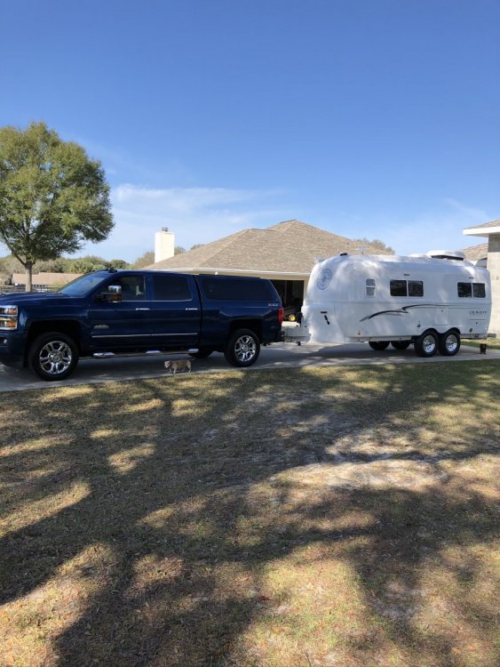

Landrover Posted February 22, 2020 Posted February 22, 2020 No worries on its capability at all. 1 Grant 2022 GMC Denali 2500 HD 2019 Elite 11😎
