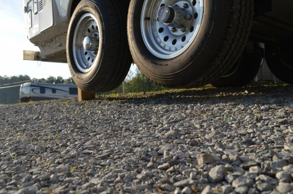

I have given this information to hundreds of Oliver owners over the past 12 years.  Don't ever run your jacks all the way down to the ground.  Always place a block or pad on the ground and let the jack foot sit on that.  We use a 6" piece of treated 4x6 stood on end under each rear jack. This accomplishes two things:
# 1 - Depending on the height of the your block/pad, it takes much less time to lower and raise the jack.
#2 -  When you drive off after forgetting to raise one (or both) the rear jacks it will simply slide off the block/pad without bending the lower leg. Repair will cost you about $500 each and, unless you're pretty handy, a trip to Hohenwald.  I made it 10 years before lowering one jack in the rain one night (I have remote jack switches inside) because I was too lazy to go outside and get wet putting the block under it. It was absolutely the one and only time I had failed to heed my own advice and it bit me in the ass the next day when I started to drive off. It is a matter of when, not if. Luckily I was at home when this happened. If I had been on the road when this occurred, I would have been stuck. The leg can not retract when it is bent back at a 45 degree angle and I wouldn't have had a reciprocating saw to cut the bottom off to be able to move on.
This is good advice given to us 4 years ago by Steve. We use legos and blocks to keep jack movement to just a few inches. I also have lines marking the up position so we don’t raise jacks to the click-click-click point. Had a jack come off the track once doing that and had to get the jack handle out to get it going again.
This was taken at Gros Ventre Campground at Grand Teton last year. You can see the block on the legos and the jack down just a few inches.
Horrors of horrors!  Is that a picture of an Oliver with its wheels off the ground and only being supported by the rear "leveler"?😁
Great advice regardless of the position of the wheels.  Less battery power used, less stress on the jack motor, less stress on the moving parts of the jack and (potentially) less stress on the frame.  Add in that it is safer, probably more stable - due to lack of torque on the jack tube and potential strength of the supporting blocks and might even help in that "when, not if" situation of driving off without raising the jacks.

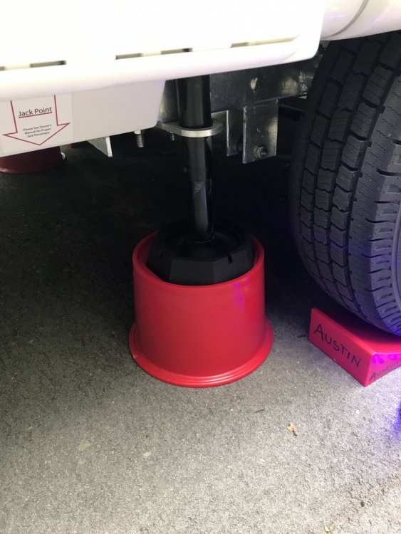

Looks like 6” snap pads are back in stock on July 15th on Amazon, just an FYI, we like ours.
Edited by Patriot
@Patriot  What is the red cylinder?
Ray and Susan Huff
1UP-USA Heavy-duty bike rack
Here-
