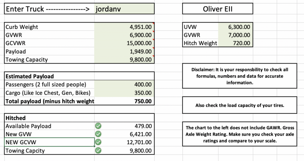

jordanv Posted August 28, 2020 Author Share Posted August 28, 2020 (edited) How would you guys feel about towing a 7,000lbs Elite II with the following vehicle specs. Again, we would be towing along many places, uphill, downhill, etc. 2019 Chevy Silverado 1500 Max Tow weight = 9,800 LBS The GVWR is 6900 LBS The max payload is 1949 LBS It has a 5.3 liter V-8 and an 8 speed transmission. GCWR is 15,000 LBS. Also has an integrated trailer brake controller. The way I see it... Max Payload = 1949 lbs Tongue Weight = 750 lbs (ish) Passenger Weight = 300 lbs (ish) Cargo Weight = 500 lbs (ish) Generator Weight = 150 lbs (ish) ------------------------------------------ Weight Left over = 249 lbs 80% of (9,800) Max Tow Weight = 7840 lbs So it seems as long as we keep under the payload, and keep our trailer under 7840 lbs, this would give us a good + safe wiggle room to tow an Elite II with this Chevy. Edited August 28, 2020 by jordanv add weights 2021 Oliver Legacy Elite II - Twin Bed - Hull 762 | 2018 F150 3.5L Ecoboost V6 w/ Max Tow package Link to comment Share on other sites More sharing options...
Galway Girl Posted August 28, 2020 Share Posted August 28, 2020 Jordan, I would feel ok in many situations, but not in others. The data below says you are OK from a payload perspective. But that's only part of the story. My personal experience with a 7000 GVW rated truck is that steep downhill grades get a bit white knuckle as the Truck and Trailer are very close to the same mass. The "FEEL" of towing depends on the setup, where and how you tow. If you're out on the road more than 50% of the time, and in mountains a lot, you may want a bit heavier Tow Vehicle...and pair it with a Diesel Engine to provide additional down hill exhaust braking assistance. If you are a flatlander you might be ok but still wind can become a problem. (Sorry for the generalizations). In the data table below, I made some assumptions and put data into the Keep Your Daydream towing calculator (xls). The calculator needed data for Passenger Weight and Cargo so I put in numbers for 2 full sized adults and 300lbs of cargo in the rear. If you add accessories they would also show up in the cargo area. For example, my short box fiberglass canopy weighs another 250 lbs. If you want to download the XLS go to the You Tube Video and check in the comments section. Video: XLS - http://www.keepyourdaydream.com/payload/ OLLIE Calculator.xlsx 2 2 2019 Elite II (Hull 505 - Galway Girl - August 7, 2019 Delivery) Tow Vehicle: 2021 F350 King Ranch, FX4, MaxTow Package, 10 Speed, 3.55 Rear Axle Batteries Upgrade: Dual 315GTX Lithionics Lithiums - 630AH Total Inverter/Charger: Xantrex 2000Pro Travel BLOG: https://4-ever-hitched.com Link to comment Share on other sites More sharing options...
