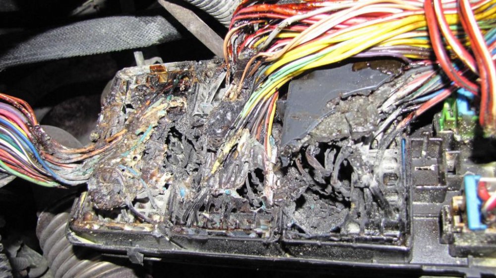

NCeagle Posted January 25, 2021 Posted January 25, 2021 (edited) 10 hours ago, John E Davies said: A fuse will not blow when the breakaway switch is activated when everything is working correctly, because the normal current flow is less than the fuse rating. The fuse is there to protect the wire if it should short out to ground, such as if a mouse chews through the insulation and the conductor touches the aluminum frame, and the wire suffers a severe current overload. The fuse pops, the wire is saved. If the same thing happens without a fuse, the wire overheats and literally melts somewhere. And your emergency brakes don’t work in either case. You still have to find and fix the problem, you just don’t have other burned stuff also, or, the worst case ever, have your beautiful Ollie burn to the pavement... Most people do not understand, a fuse protects the wire, not the device at the end of it. Your stereo shorts out, the fuse blows, the wire is safe, you replace the stereo and replace the fuse... no worries. Electrical fires are not to be taken lightly, use Google to look at some pics of “automotive electrical fire images”. Like this one: John Davies Spokane WA Wow - what a dramatic image. Interestingly, that's also what the battery could look like after the travel trailer broke free from the TV and crashed and burned - all because the emergency brakes didn't work due to a blown fuse that isn't supposed to be there. I think I'll wait for OTT to issue a safety recall if it's not correct as is. Edited January 25, 2021 by NCeagle 1 2020 Elite II, Hull 688 --- 2021 Silverado 2500HD, 6.6L Duramax Diesel

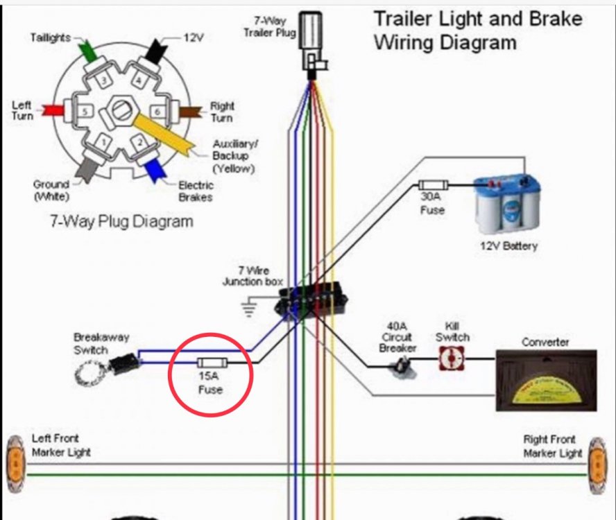

John E Davies Posted January 26, 2021 Author Posted January 26, 2021 1 hour ago, mjrendon said: I also looked a the wiring instructions for several other break away switch manufacturers and none of them showed a fuse in their instructions for their switches. Yep, I agree, but I did find this one with a fuse from an unverified source. But only this one.... John Davies Spokane WA 1 SOLD 07/23 "Mouse": 2017 Legacy Elite II Two Beds, Hull Number 218, See my HOW TO threads: Tow Vehicle: 2013 Land Cruiser 200, 32” LT tires, airbags, Safari snorkel, Maggiolina Grand Tour 360 Carbon RTT.
