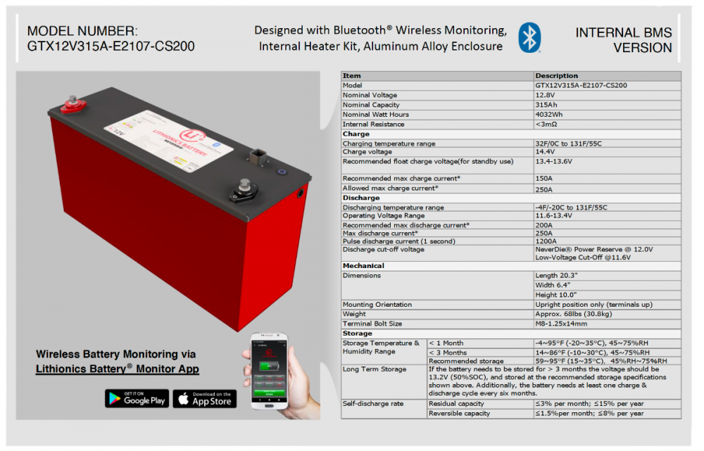

Pix from the data sheets to quick compare:
Up to 3 of these Lithionics G31's fit in the battery bay of the Oliver.
The Oliver specific version slightly higher watt hour rated.
897372407_ScreenShot2021-04-29at5_23_13PM.thumb.png.c8d06ea09a83b4d9e9aba808d89df4fe.png
Two of these Fit in the Battery Bay as part of the Platinum LI Package.
These same batteries are used in Winnebago Class B's and other Motorhomes..
688014070_ScreenShot2021-04-29at5_23_36PM.thumb.png.739459ac1b2c6d8ba4b29d3ab6cc9e16.png

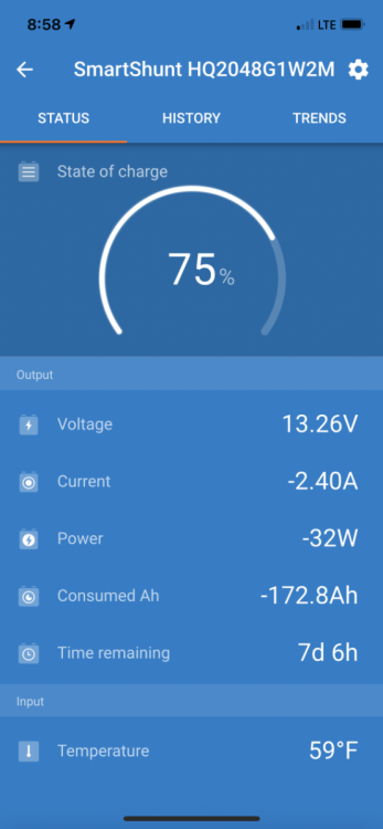

Here's our State of Charge data for the dual GTX 315's in our trailer (Hull 505) over a few days of boon-docking at Kalaloch on the WA Coast.
  • NO Generator Use, No Shore Power.
  • 340W Solar on Roof and 30A Zamp Controller On Board
  • No direct fully sunny days
Power Uses:
  1. Ran the max fan at night on low for air circulation and most of the afternoons
  2. Used the microwave sparingly to do some popcorn.  Didn't do the Oven.
  3. Did NOT run AC as in our setup we have a 2000W inverter, not connected to the AC.
  4. Watched TV  (we have a DC powered TV) each night for about 2 hours (streaming from downloads on the tablet.)
  5. Ran 2CPAPS all night for 8 hours.
  6. Did NOT run the generator nor hook up to any shore power.
DATA:
Starting AH: 630AH Total Capacity (both batteries)
8:00 AM Day 1 was 100% Partial Sun
6:40 AM Day 2 was 90% Rainy Day
6:13 AM Day 3 was 83% Rainy Day
8:27 AM Day 4 was 75% Departure Day
Total Used AH: 154AH   or 52AH/day
Remaining AH: 236+240 = 476AH (sum of both batteries)
I estimated with the dual 315A Batteries we could last 12 total days in overcast conditions like those we experienced with our normal power use model.
My guess is if we had the 390AH Battery Set we could maybe last about 7 days.
So that means the Dual 315's enable about 5 more days of off grid camping given our use model.
*Your use model may be very different*
We'll be testing full sun as we travel in Aug-October and we will post an update.
Hope that data helps some folks!.
