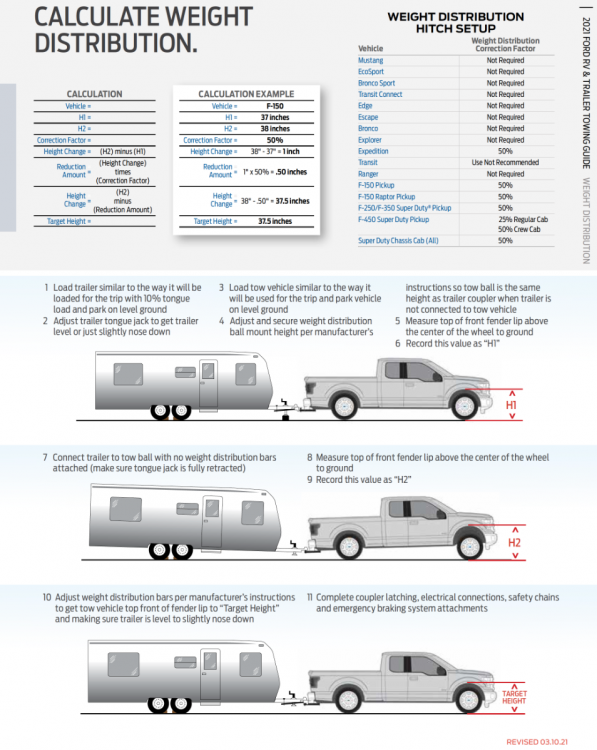

Ford's towing guide states that a truck towing a trailer with a weight distribution hitch should be adjusted lower the total rise caused by the loaded trailer to 1/2 of the difference between the unloaded and loaded weight of the truck.
202493778_ScreenShot2021-05-30at6_35_13AM.thumb.png.4947a419ca823b9b909b583c716458e1.png
I did this with my F150 and the EII and found that loaded/unloaded front wheel well height difference to be 2.5 inches.
I tightened my chains until I brought that difference down to a bit under 1 inch and found that the front steering was better and the bounce was much less.
With the LE2 on the ball and WD attached, the back end lowers a couple of inches...23 1/4 to the top of the BDog.
The front end moves a small amount from 37 4/16 to 37 7/16. I'll measure again after i tow a while.
