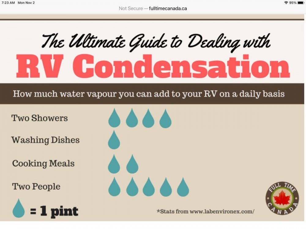

Ventilation is key to keeping interior humidity in check.  At night, we crack a window, front and rear, and leave the ceiling vent open.  You could also run the vent fan on exhaust (pulling air out).  At the lowest setting (10%) you hardly hear the fan, and it uses just a few amps.  Definitely run the fan (on air out) while cooking or using the shower.
We did purchase this mid-sized dehumidifier, not knowing if condensation would be an issue.  We took it along on the trip home from Tennessee, in case needed, but did not use it; while on the road, condensation was manageable with heat and ventilation.  Perhaps it would have been more problematic if we were spending more time inside, but the majority of the trip was on the road; it's nice that you can leave the MaxxAir fan vent open while traveling.
When we arrived home it was raining with 85%+ humidity (PNW).  Once she settled in our driveway, the Ollie's interior humidity was in the upper reaches of desirable (I don't recall exactly, but near the outside humidity).  We utilized the dehumidifier, propping the mattresses on their sides to prevent moisture collecting despite the fact that we have the hypervent mats (more on those later).  In two days the humidity was in the 50% range.   Since then we have controlled humidity without the use of the dehumidifier.  I did hang a dehumidifying pouch in the closet and a tub of dehumidifier crystals in the basement.  Now that summer has arrived, the cabin humidity has been satisfactory just with the vent and windows open.
I suppose you could use the dehumidifier while camping, but unless weather conditions are extreme (mostly in regards to freezing temps) humidity can easily be managed with ventilation and heat; we like to keep our travels as fuss-free as possible.  While closed up for periods of inactivity, the dehumidifier is good insurance against condensation issues.  Realize, however, that most of the surfaces inside the Ollie (unlike other RV interiors) are impervious to moisture, the mattresses/cushions being the most vulnerable.  This is why condensation is more evident than it would be in an RV with wood cabinets, carpet (walls, floors, and basements), and wallpaper, all of which absorb a fair amount of accumulated moisture.  Cushions can easily be brought indoors for storage; the mattresses not so easily.  Here lies the necessity for the Hypervent pads under the mattresses or sleeping cushions.
