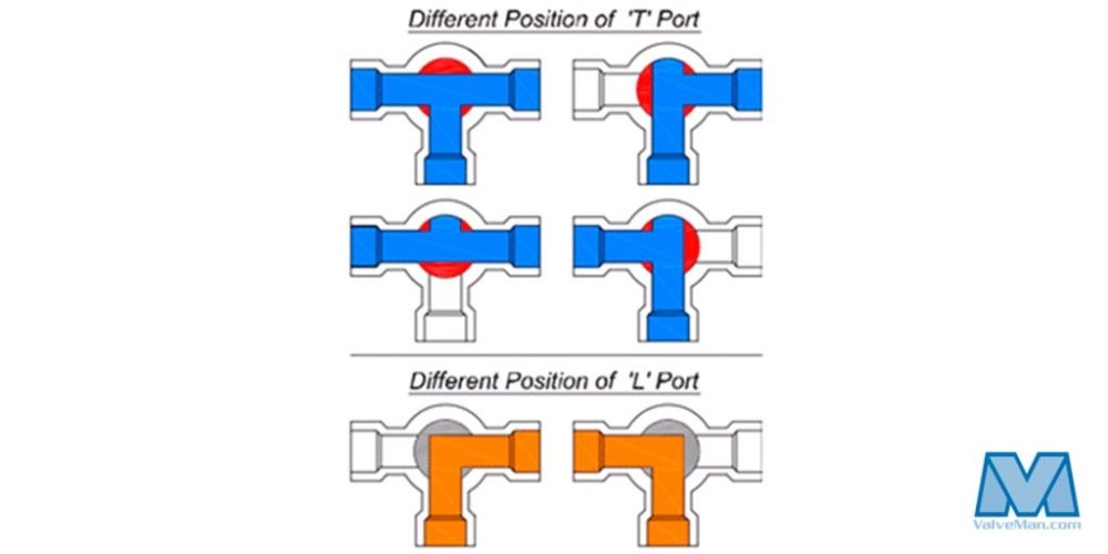

John E Davies Posted November 8, 2021 Posted November 8, 2021 I have not done this, it is just rattling around inside my head. for the shower lines I would install a pair of L Port bypass valves, like the water heater one, close to the existing fresh drain (aka near the furnace) and also tee those isolated sections there into the water tank drain line, between that valve and the belly opening. You could add two regular valves there, open them the in the winter and close them when you need the shower to be working. Yes, you still need a way to blow out the dead end shower section, you could make a simple adapter hose to screw on the end of flexi hose outside, and blow back into the trailer. By leaving the drain valves open, any seepage past the isolation valve would hopefully drip out the belly rather than go uphill to the shower. But I don’t think that would be 100% certain. I haven’t actually drawn this out, getting the valves oriented correctly is important. I think it would work. Three way valves are a little tricky to understand, this might be informative. John Davies Spokane WA 1 SOLD 07/23 "Mouse": 2017 Legacy Elite II Two Beds, Hull Number 218, See my HOW TO threads: Tow Vehicle: 2013 Land Cruiser 200, 32” LT tires, airbags, Safari snorkel, Maggiolina Grand Tour 360 Carbon RTT.

GAP Posted November 9, 2021 Author Posted November 9, 2021 On 11/8/2021 at 10:56 AM, John E Davies said: I have not done this, it is just rattling around inside my head. for the shower lines I would install a pair of L Port bypass valves, like the water heater one, close to the existing fresh drain (aka near the furnace) and also tee those isolated sections there into the water tank drain line, between that valve and the belly opening. You could add two regular valves there, open them the in the winter and close them when you need the shower to be working. Yes, you still need a way to blow out the dead end shower section, you could make a simple adapter hose to screw on the end of flexi hose outside, and blow back into the trailer. By leaving the drain valves open, any seepage past the isolation valve would hopefully drip out the belly rather than go uphill to the shower. But I don’t think that would be 100% certain. I haven’t actually drawn this out, getting the valves oriented correctly is important. I think it would work. Three way valves are a little tricky to understand, this might be informative. John Davies Spokane WA Informative for sure so thanks on that John. The thought of performing these type of plumbing tweaks is a bit intimidating. My situation is pretty unique, I guess, as most folks seem to stay clear of extended length below freezing tripping. For short stretches, bottled/jugged water and a composting toilet works well but anything more then a few days, a shower moves from the "kinda nice" box to "kinda got to do it". I have been told by quite a few winter trailer users that they have no problem with the blow out system in their rigs but those aren't Olivers and I'm a little gun shy about experimenting with mine. Obviously, waking up and re-winterizing with pink, multiple times during the winter, without access to a heated garage, is a dubious situation. I saw that Oliver used to have guidelines for blowing out posted, as a video, on their site. Have reached out to the shop to further explore and am absolutely going to experiment. Will report back with updates as things unfold. Gerry SOLD: 2021 Elite 2, Twin Bed, Lithium & Solar, 3000W Inverter SOLD: 2022 Ford F150, 3.5L V6 EcoBoost, 4x4 Supercab, Trailer Tow Package
