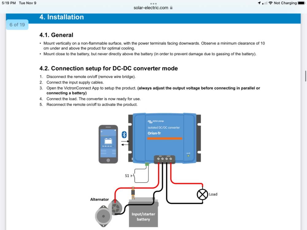

Have you researched the installation instructions for the Victron charger? I did, and that is (one reason) why I chose the Redarc. The Victron must be mounted vertically with at least 10 cm clearance top and bottom, that is difficult to do under the seats. I do not know the height of that particular unit, but my Victron 35 amp solar MPPT charger fits that way, but is not ideal, but it also sits right on top of a four inch diameter vent hole…..
https://olivertraveltrailers.com/forums/topic/5329-how-to-victron-mppt-solar-charge-controller-underneath-the-street-side-bed/
My Redarc is horizontally mounted on top of an aluminum plate with big holes in it.

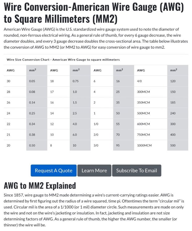

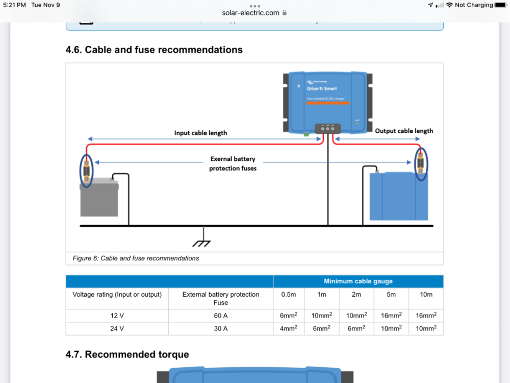

Then there is the wire needed, the Victron needs 6AWG from truck battery to Ollie battery, so you must run all new wires. If you are going to all that trouble, you might as well make them even bigger and put in a higher amperage unit of some kind. Why stop at 30 amps? I picked the Redarc 11A unit because it is the biggest output I could find that did not require stringing new heavy cables all over the place; however one of my Ollie wires was actually undersized, and I had to replace that section.
I suggest that you study the Redarc offerings, they have a 50 amp dual input one that ALSO functions as a solar MPPT controller. It is very robust and can be mounted in any position, anywhere, even underneath the frame (with waterproof butt splices). BUT you must run suitable heavy gauge cables everywhere, that unit requires 4AWG, and use a suitable Anderson 75 amp or bigger double Powerpole connector at the bumper.. https://redarcelectronics.com/products/dual-input-50a-in-vehicle-dc-battery-charger
https://cdn.shopify.com/s/files/1/2204/8993/files/BCDC1250D_Instruction_Manual.pdf?529
https://redarcelectronics.com/collections/in-vehicle-dual-battery-chargers
But mounting it outside the hull would completely solve your heat gain worries, especially when charging off the truck when natural wind flow would be excellent. I do think the battery box needs better venting, it should be wide open to the interior, and the door should be sealed and insulated. I addressed this in this thread.

Forgot this, you should research your F150 charge wire size and amp (fuse) capacities. They are likely pretty decent, but most likely nowhere close to 4 AWG.  My LC200 has a 40 amp fuse in that circuit, I don’t know the gauge. I bet it is no bigger than 10 AWG.

  • My F-150 Lariat, SCrew, 3.5 EB, FX4, MTTP comes with fuse #43 that is a 25 amp slotted M-Class fuse.  Unfortunately, when Ford went to the aluminum body, the wire size to the 7 pin was reduced.  Granted fuse #43 will protect the wire, but it's voltage drop is significant enough that I do not believe it could also feed a 30 amp load to the Lithiums.
  • I have noticed that during the past four seasons using L/A batteries, the 7-Pin trailer connection has significant heat generated discoloration for both the Charge Wire and Ground Wire connections.  (And yes I do use di-electric grease to control corrosion).  My opinion is that the existing Ford and Oliver electrical wires (Out and Back) are undersized.  As does several other Ford and Oliver owners.
  • Research into this lead me to use a "Non-Isolated" DC to DC which requires running both a + and  - cable to the trailer systems.  It's wiring diagram is slightly different than the one you posted.  Good news is it will also significantly improve the return ground path between TV and Ollie.  My measured distance for running these electrical home runs approaches 50 feet out and 50 feet back.  Although 6 AWG stranded copper could be used,  I, BatteryCables USA, and the Victron Forum felt that using the larger 4 AWG was the proper choice.  (Not to mention that's what Galway Girl determined as well.)
  • I think we can agree that all DC to DC chargers require careful attention as to how their "waste heat" is dissipated.  After all, this WAS the point of my creating this  thread.   For the VO at least I could find published specifications that quantified the input power and output power needs.  The difference between the two is waste heat that must be dealt with.  For the Redarc I was not able to locate such data.  My experience is that when a manufacture does not want such a comparison to be made, they don't provide the specification data to do so.  -1 for Redarc.
  • Regardless, as a PE with extensive heat transfer professional experience, I prefer the fact that the VO is addressing the heat build up issue front on.  Large heat sinks and their optimal vertical placement of heat sink cooling fins for heat dissipation was noted.   +2 for VO.  However, as you indicated, this negatively impacts the number of suitable locations for installation.  So, - 1for VO.
  • I am sure your hole in the plate is a good idea to help out the Redarc in this regard, but where are it's external heat sinks?  Or do they need a supplemental cooling fan or artificial airstream to keep their cool?  Not evident from what I can see from their limited pictures or descriptions that I could find.  -1 Redarc.
  • In summary, I thought that since about the only time I will be using my VO will be when I am traveling, why not put it vertically in the front dinette under seat area.  With the cushion and hatch cover removed there appears to be space for heat flows up and out of the under-seat area without providing any additional heat to the OEM street-side bunk area.  So, maybe a +1 for Geronimo for creativity.
