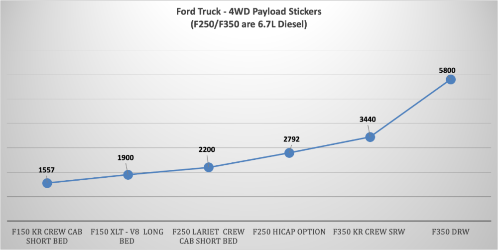

Oh...here's a chart I made while shopping for Fords.
It shows the PAYLOAD sticker (from door) numbers for various configurations.
* Note that a stripped down  F150 (XLT) can have a 1900 LB payload in the longed configuration.
* The F250 High Capacity Option adds another 592 lbs of Payload .
* Jumping from the base F250 to the F350 adds 1240 lbs of payload.
For most folks towing an Oliver EII the sweet spot is probably a F250 or F250 + High Capacity Option.

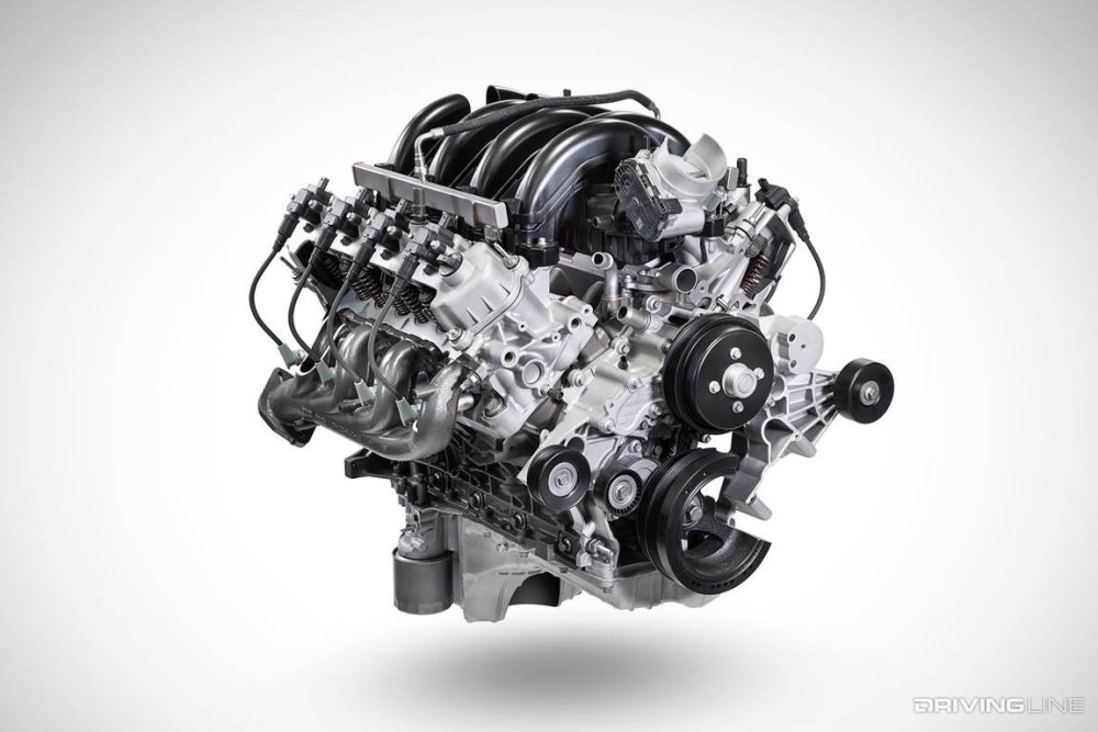

I suggest that you research the Ford HD trucks with the 7.3 liter “Godzilla” gas motor. It has almost diesel power characteristics, is super simple and cheap to maintain, and will pull either Ollie easily.
https://www.drivingline.com/articles/godzilla-truck-is-the-73-liter-v8-ford-f-250-a-throwback-big-block-muscle-pickup/

50 minutes ago, John E Davies said:
Hill Descent is used at a walking pace, it uses the ABS as a sort of low speed cruise control, for going down really steep hills. It won’t work at highway speeds. I much prefer to just engage 4 Low and shift manually, it is much less chaotic for the passengers  that way.
Thank you, John.  Interesting option should I decide to go the big gas truck route.

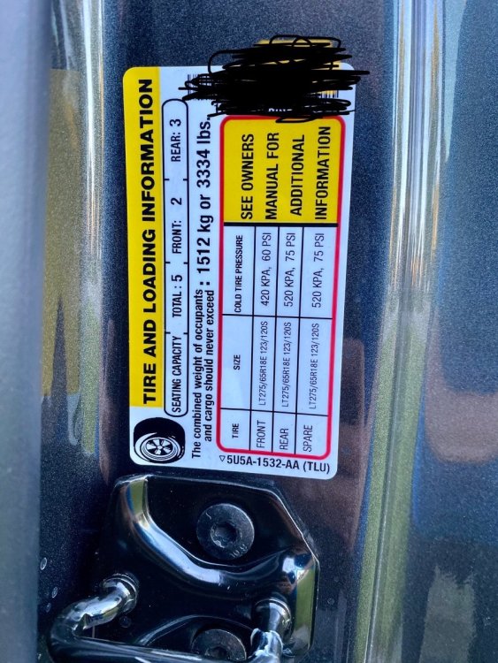

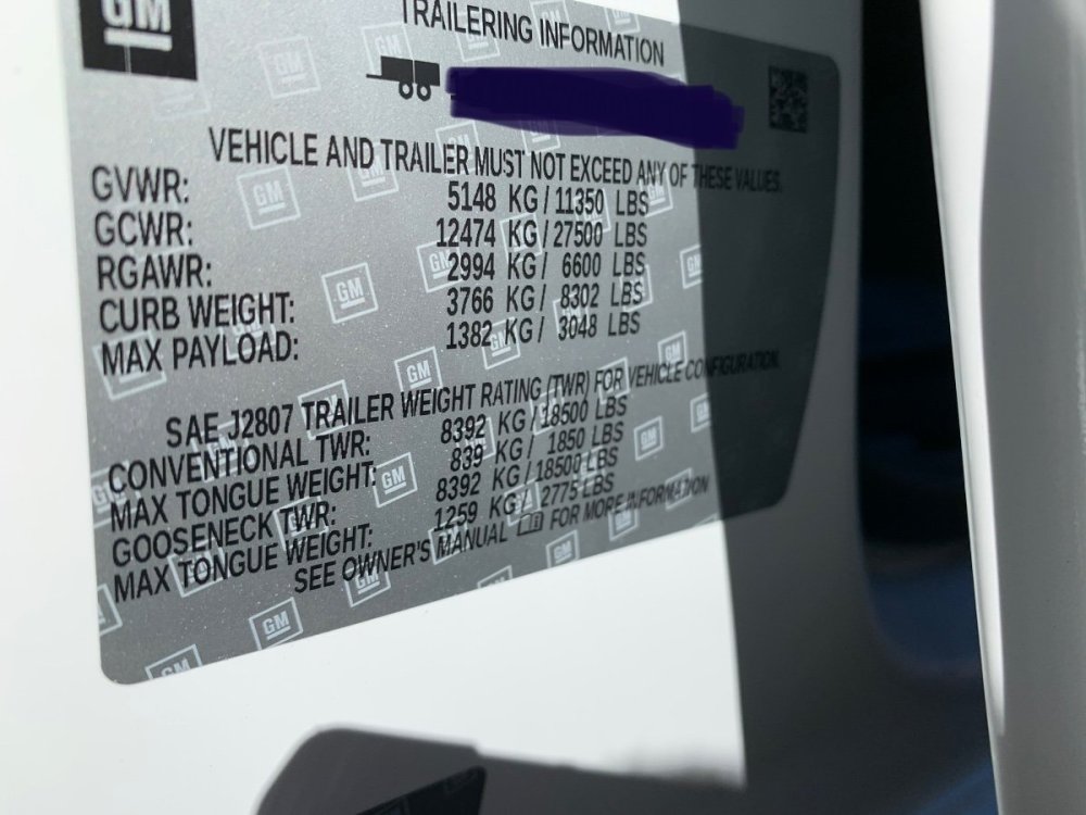

Payload aside it’s important to realize that the curb weight of a heavy duty pickup is at least 30% higher than a half ton. That weight increase comes predominantly from stronger structures (frame, axles, brakes, etc) and drivetrain.  The extra strength of these components really does make a difference when towing a trailer.
Did you actually lay eyes on the sticker that stated “3,760 lbs payload?” That seems awfully high for a fully tricked out (Denali) 2500.
According to GM they are weighed after the build.  It’s nice to see all the ratings on the sticker I’ve haven’t seen this before. The redesigned frames are impressive. 2022 GMC  Denali 2500 Duramax 18500 towing 3700lbs payload vs 2017 highcountry 2500 Duramax  13500 towing 27900 payload, big difference.
My 2500 AT4 is just over 3000.AFEBAD3C-6D22-42A5-BB0C-18BF4F6B4FC1.thumb.jpeg.803423791cd2f903d284b64195e13c83.jpeg
Thanks for the question.  I did not see the sticker when I posted that it had 3,760 lbs payload.  I got that number off of a GMC webpage.  After you asked the question I contacted the seller and asked him to send me a photo of the door sticker, which he did.  The door sticker shows the max payload is 3,339 lbs.
