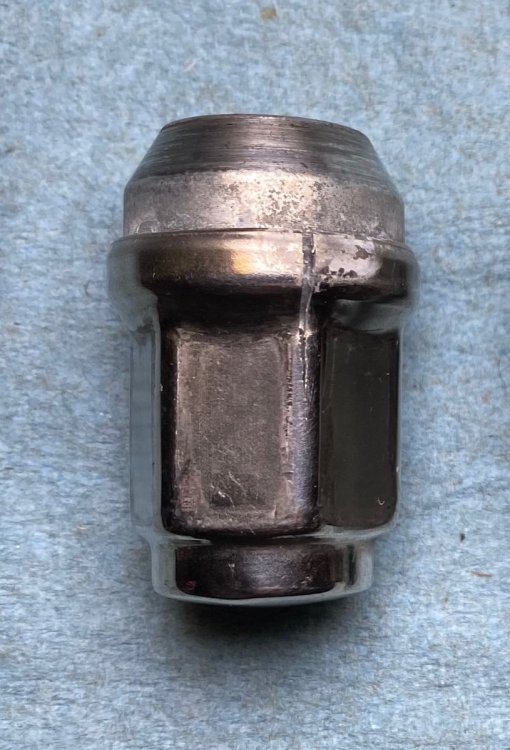

Frank C Posted May 6, 2022 Posted May 6, 2022 I found several lug nuts with the cracked stainless clad cover (see pic) when I did my wheel bearing service recently. So I replaced all of my lug nuts with Gorilla lug nuts from Summit Racing. So far they’ve worked great. https://www.summitracing.com/parts/gor-41187htb 2 2
