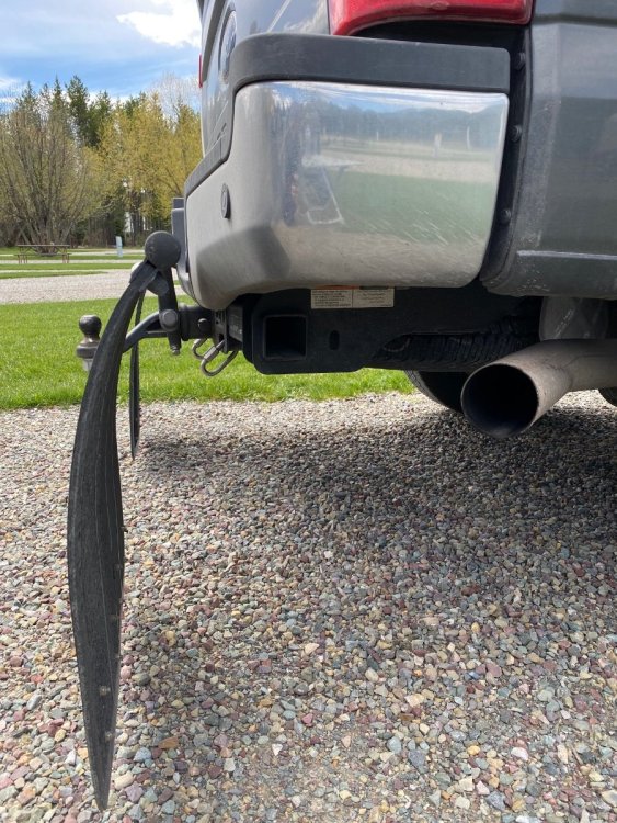

Here’s a photo of my Rock Tamers, mounted, as John described, at an angle so they sail back a bit at speed and deflect rocks downward.  I’ve towed our Elite II over 20,000 miles now and so far the Rock Tamers have protected the front of the Ollie very well with no chips or dings at all.  I do travel mainly on paved roads though, the only place I typically encounter significant amounts gravel is usually at the campgrounds and that’s low speed limits on those properties (5mph) so not much gravel thrown up there.   Other Ollie owners seem to prefer more protection due to more travel at speed on unimproved roads, boondocking/forest service/CoE/BLM camp areas, abandoned rock quarries, combat zone minefields, etc.

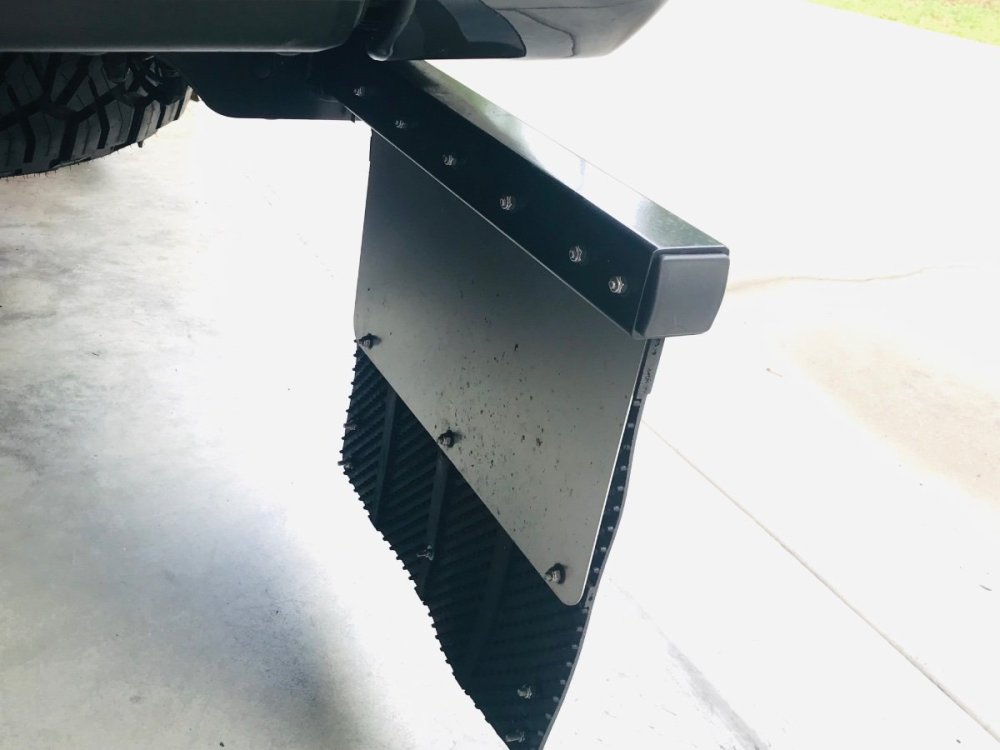

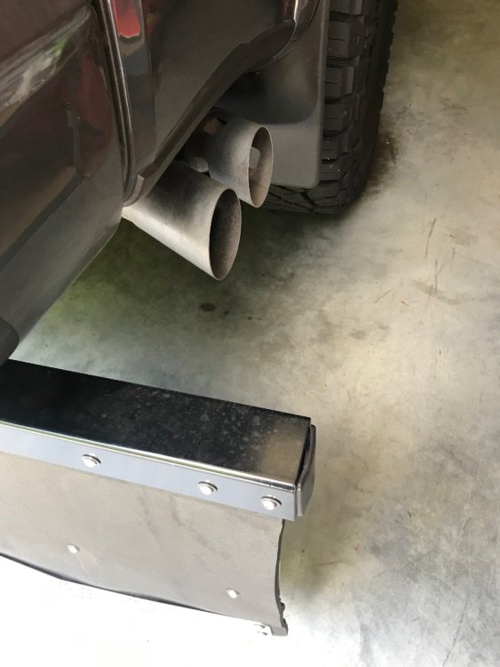

I had the Livelymachine shop fabricate these “Rock Stoppers” for our F 350 and have been extremely pleased with the design and performance and most of all a clean Ollie. Constructed of powder coated aluminum tubing and all stainless fasteners these are high quality.
They are also custom fit to the F Super Duty trucks for a clean install on the side openings of rear hitch and can be easily removed if not towing. The aluminum face plate In front of the rubber flap deflects debris and stones as and also facilitates rubber flap anit sail. I have zero sailing issues with this product.
If anyone is interested or you have questions about pricing contact Lively machine @Livelymachine.com.
After a recent camping trip - a clean front and XPEL 10 mil PPF did its job a long with Rock Stoppers performed great.

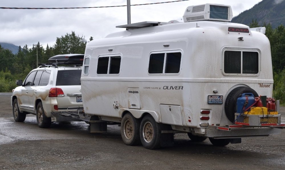

Do you carry spare plates? I can’t tell, but it appears that they are bolted to the flap supports. If so they are going to be really vulnerable and short lived, aluminum is not durable for that purpose. Stainless steel would be a better choice and it could be bent back into place a couple of times after the inevitable collision when backing, or with a piece of road debris like a tire carcass or piece of wood. If I had those they would be trashed within a month. Mudflaps need to have some flexibility!
And I would like to add that this is not just for boondocking, if you travel in a state that does “chip sealed” road work, you need stone protection. Even a few miles of fresh oily chip seal will make an ugly mess of any unprotected Ollie and TV. And you will acquire a new list of swear words. This shows a worst case scenario - 50 miles in steady rain in BC:
(The back of the Land Cruiser did remain clean.)
Link to comment
Share on other sites
That is one dirty rig. Are those those red fuel jug gas bombs on the rear bumper?! 😳
Spare tire cover?
Love my Rock Stoppers!!

For your fabricated Rock Stoppers, doesn’t that mounting location on the side openings of the hitch (the square tubing section below the bumper) put the flaps REALLY close to the exhaust pipe?   Or is that aluminum plate on the front of the flaps also functioning as a heat shield?  The Rock Tamers mount far enough back to avoid heat issues.
Link to comment
23 minutes ago, FrankC said:
Doesn’t that mounting location on the side openings of the hitch (the square tubing section below the bumper) put the flaps REALLY close to the exhaust pipe?
I had zero issues during an amazing long Western NC to Maine and back trip even with the random diesel regen heat. So my answer is no exhaust heat issue on these flaps. They worked great and would absolutely purchase again. I ordered a set of the rock tamers, but returned them. I just prefer the custom clean look, solid fit and finish and simplicity of the install of “Rock Stoppers” instead.  Plenty of clearance for exhaust heat.

7 hours ago, Patriot said:
It appears you need to really wash your SUV and Ollie, are those red fuel jug fire bombs on the rear bumper?! 😳 Did you loose your rear spare tire cover? Wow! 😳
Yes, definitely, but there wasn’t a car wash within maybe 400 miles (Stewart/ Cassiar Hwy, BC, about half way to White Horse YT.) But it rained for a week longer, so washing wouldn’t have done any good.
Yes, two genuine Wedco NATO jerry cans, 12 gallons total... No fireballs yet. Ever seen a Jeep with cans on the back? Same concept.  No worries. Don’t do this with plastic jugs. Since I removed the rack, I now carry an ebike there and a single NATO can inside the LC200.
No, I permanently removed and wrapped  the spare cover the day after I got it home from Hohenwald.

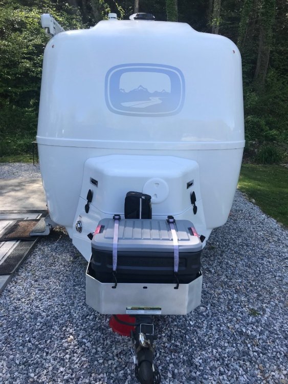

My Rock Stoppers have worked excellent on all gravel roads. In fact most if not all the CGs we visited last season had gravel roads and I can’t imagine towing without them. With the install of the 10 mil XPEL PPF I feel like I have done all I can do to keep the front of our Ollie looking decent.
See a recent photo of our Ollie above.
