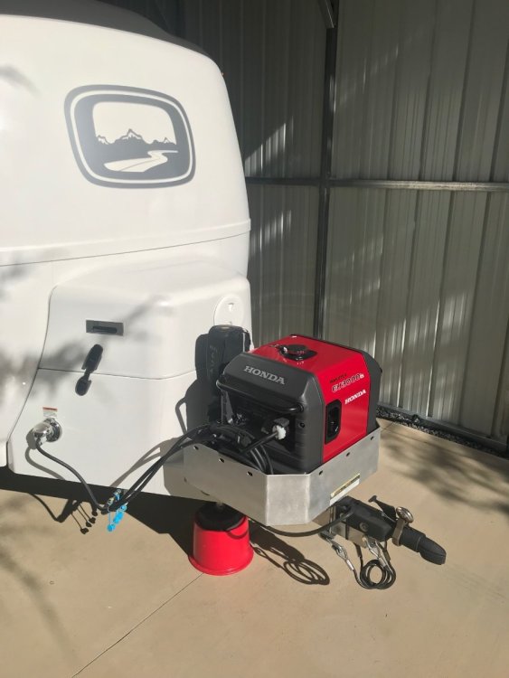

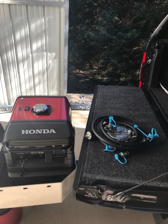

Guest Posted August 30, 2022 Posted August 30, 2022 Not sure why you think the Honda 2000i won't fit into the front basket - we carry two Honda 2200i generators there. As to the ability to start the Truma A/C with one 2000i, I'm not sure. What I did discover on our recent trip was that use of the "ECO" mode does not work well during the startup of our Houghton A/C. I think the Truma may have a lower inrush current than the Houghton - which has a much lower startup current than the stock Dometic. Our experience was with both Honda generators paralleled and both in ECO mode. When I switched it off, the generators worked fine.
bbrault Posted August 30, 2022 Author Posted August 30, 2022 Sorry, I was referring to the Honda 2200i that won’t fit. The specs size I got for the Elite I basket size is 26.75 x 14.375 x 7.75 (L x W x H) in. I don’t see how you can fit the 2200 or 2 2000. You possibly have an Elite II?

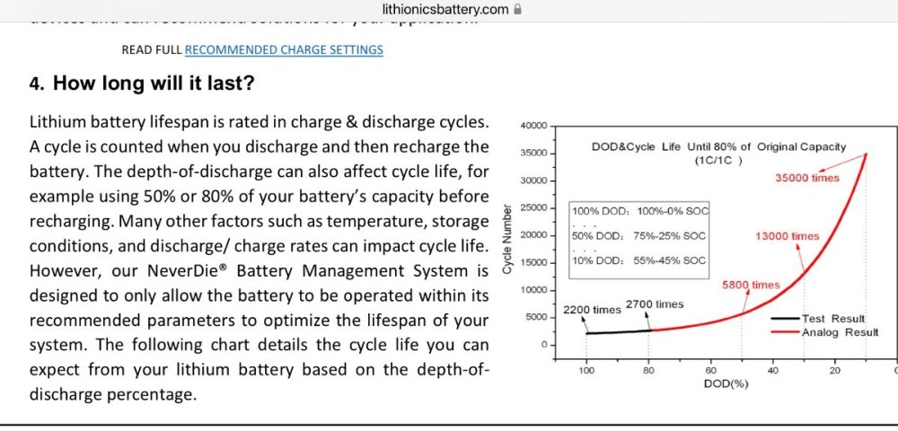

bbrault Posted August 30, 2022 Author Posted August 30, 2022 Dave and Kim Several reasons 1- The AC will drain your Lithium in an hour or so. 2- A 1000W generator would then take 4-5 hours to recharge your Lithium. 3- Your expensive Lithium will only take a few hundred charge/discharge cycles. I cannot think of many good reasons to run the AC on Lithium except for short exceptions and mostly to help start the AC and then run it from a Generator if the Oly can do that. Thats what I am trying to find out. 2

Moderator+ ScubaRx Posted September 3, 2022 Moderator+ Posted September 3, 2022 On 8/30/2022 at 6:31 PM, bbrault said: 1- The AC will drain your Lithium in an hour or so. 2- A 1000W generator would then take 4-5 hours to recharge your Lithium. 3- Your expensive Lithium will only take a few hundred charge/discharge cycles. Let me expand on this a bit. 1- The AC will drain your Lithium batteries if used for too long, but it won't do it in an hour. 2- A 1000W generator can output a maximum of just over 8 Amps. If you've used 360 amps out of your batteries running the AC for several hours it will take this generator nearly two days to recharge your batteries. 3- LiFePo batteries can take thousands of cycles. 5 1 Steve, Tali and our dog Rocky plus our beloved dogs Storm, Lucy, Maggie and Reacher (all waiting at the Rainbow Bridge) 2008 Legacy Elite I - Outlaw Oliver, Hull #026 | 2014 Legacy Elite II - Outlaw Oliver, Hull #050 | 2022 Silverado High Country 3500HD SRW Diesel 4x4

John E Davies Posted September 5, 2022 Posted September 5, 2022 On 8/30/2022 at 4:31 PM, bbrault said: 3- Your expensive Lithium will only take a few hundred charge/discharge cycles. This is incorrect for all brands of lithium RV batteries. I don’t camp a lot of days, but toward the end of my second season with 200 AH of Battle Borns, they have only had 15 actual cycles…. because I rarely run the State of Charge very far down. Usually the panels catch up each day after a minimal discharge overnight. For a residence that has daily deep cycles from its solar installation, the cycles can add up very fast indeed. Going by the above chart an Ollie owner could expect six YEARS of once a day deep discharges before it deteriorates to 80% of its original capacity. I expect my BB batteries to essentially outlive me 😬 This is just one reason switching to Lithiums makes so much sense for owners when their lead acid batteries die, especially if they expect to own the trailer for more than three or four years. John Davies Spokane WA 4 SOLD 07/23 "Mouse": 2017 Legacy Elite II Two Beds, Hull Number 218, See my HOW TO threads: Tow Vehicle: 2013 Land Cruiser 200, 32” LT tires, airbags, Safari snorkel, Maggiolina Grand Tour 360 Carbon RTT.
