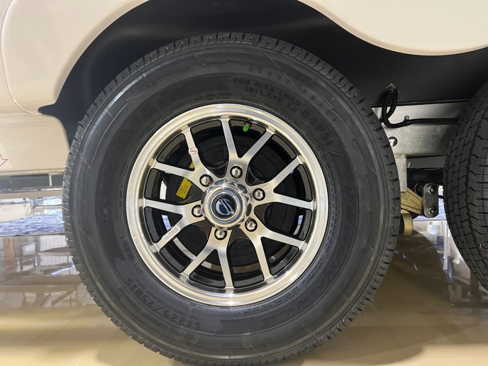

Moderator+ ScubaRx Posted October 18, 2022 Author Moderator+ Posted October 18, 2022 5 hours ago, ChrisMI said: I noticed they changed the wheels a few months back as well. I’m curious what the new 15 inch wheels will look like. Not sure I agree with Oliver’s choice to go smaller… I took this photo this morning of one of the Elite II’s on the showroom floor. Rodney says this is the tires and wheel’s they will be using on the 2023 models. He did say that their existing stock of 16” wheels and tires will be used first. So, it may be as late as March of ‘23 before the new models will start to be delivered with the new sets. 1 8 Steve, Tali and our dog Rocky plus our beloved dogs Storm, Lucy, Maggie and Reacher (all waiting at the Rainbow Bridge) 2008 Legacy Elite I - Outlaw Oliver, Hull #026 | 2014 Legacy Elite II - Outlaw Oliver, Hull #050 | 2022 Silverado High Country 3500HD SRW Diesel 4x4

John E Davies Posted October 18, 2022 Posted October 18, 2022 5 hours ago, ScubaRx said: John, the new wheels will still be 6 bolt on 5.5”. Grrrrrrrr. 😤😤😤😤😤😤😤 Idiots. I have opened a ticket asking why they continue to use this b*****d bolt pattern, and what is the brand and load rating of that spoked wheel. Maybe I can find a 5 on 4.5 version. Unless they changed to 5000 pound axles on the LE2, is that a possibility? That would be really weird, downsizing the wheels and tires and upsizing the axles. John Davies Spokane WA 2 SOLD 07/23 "Mouse": 2017 Legacy Elite II Two Beds, Hull Number 218, See my HOW TO threads: Tow Vehicle: 2013 Land Cruiser 200, 32” LT tires, airbags, Safari snorkel, Maggiolina Grand Tour 360 Carbon RTT.
