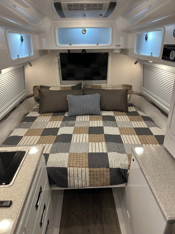

Hi there,

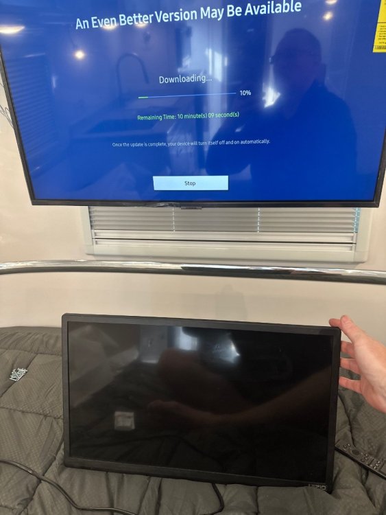

I actually replaced mine the first week of ownership last month. I replaced with a Samsung QN32Q60AAFXZA 32 inch.  It just fits, you may need to tinker with the vesa mount screws a bit, I had to trim two screws from my collection of misc screws in my garage to get it to work, the screws from the Visio TV to the mount will not fit right. From there you will need an hdmi extension cable, I found one on Amazon that was 6inches and it did the trick. You will need to adjust the mount bracket slightly lower and then tighten the screw locks on the bar as the last step so that the tv will not hit the shade but clear the upper cabinet. Took about 45 mins to do just to get the right screw fit.
Jjnps that looks awesome and I’m impressed you made it fit.   Looking at your suggestion and CRMs track method. Thanks for posting!

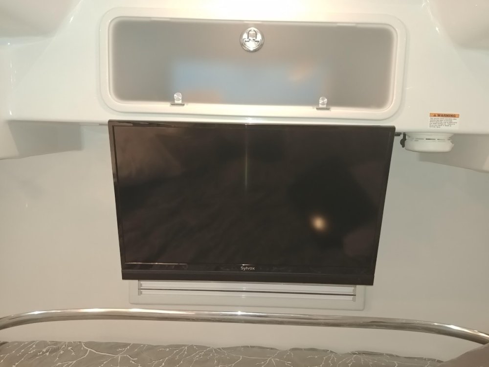

Hi everyone!

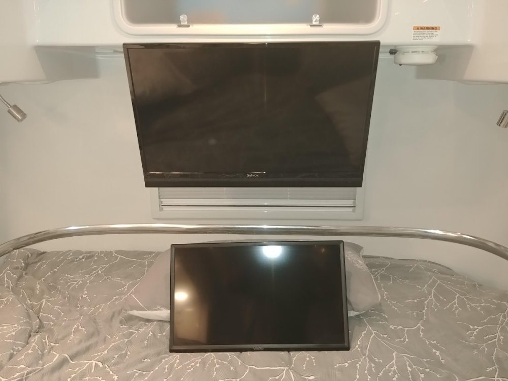

I upgraded to a 32 inch. I installed a Sylvox 32" (made in china, but cant find one made in the US.) Its a smart TV with all the bells and whistles. its also a 1080 dpi, so its sharper then the original Vizio. It is also a 12 volt/DC so I don't need to run the inverter to watch tv. I needed a new adapter plate I purchased from Mount-it! (an MI-782), the same people that made the original mount. (an MI-4211). Just bolted the mounting plate to the old stand and then attached the TV to that. It swings up out of the way just fine, and is much nicer to watch then the old 24". I have a 2021 Elite II with the standard floor plan. Got any questions, Id be happy to help out.

12 Volt! That's great. Where did you find it. I was already contemplating eventually replacing the original TV with a 12V, so bigger is even better. Thanks!
Nevermind, I found it: https://www.amazon.com/SYLVOX-Powered-Television-Integrated-Speaker/dp/B0BN2WV3TZ?th=1

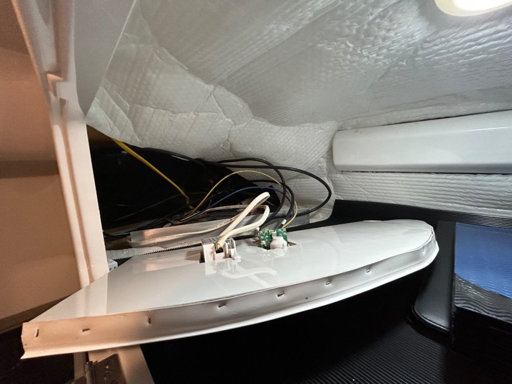

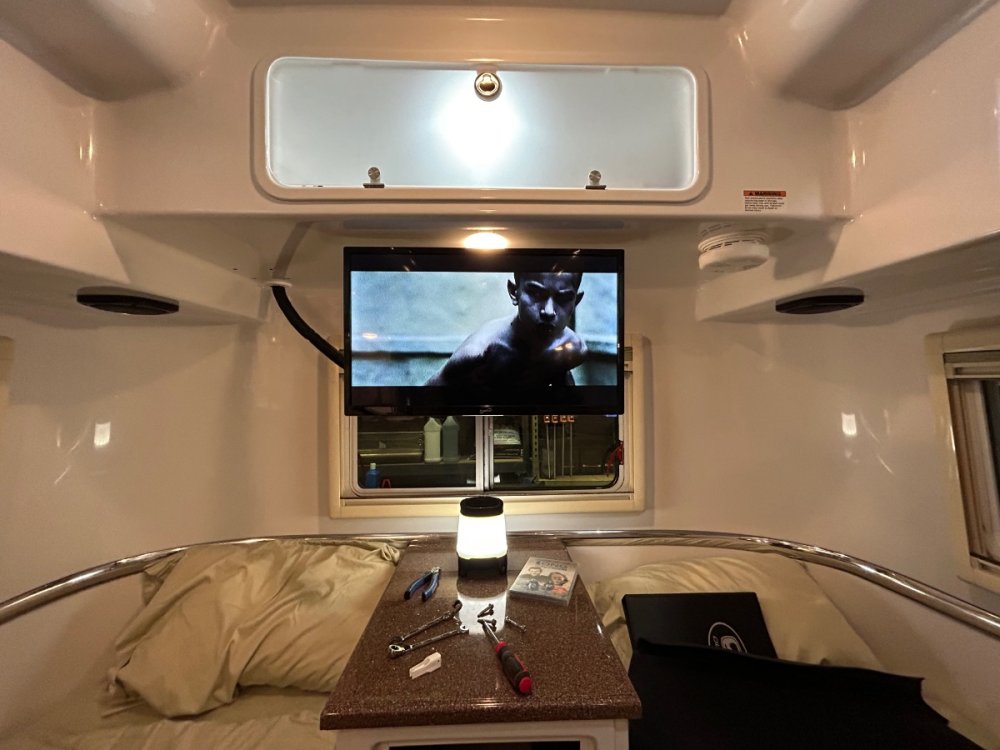

The "center mount" TV hardware arrived from Oliver (thanks to Ryder!) last week.  So, we removed the curbside/aft corner vertical TV mount on our rig a couple days ago.  We mounted the new hardware just aft of the LED light over the nightstand.  I've still got the power & HDMI cables routed through the original hole, but thanks to mossimi, I'll cut a new hole aft of the TV mount (less conspicuous) and use moss' 2" plug that he sent me to cover the original cable hole.  I was amazed how random the wiring was behind the bulkhead in the aft storage compartment.  Cleaned a lot of that up.  Also, the wiring set up had 2 massive (L, R, Video) cables from the TV through the original hole - one of which ran back to the Furrion controller - we removed them both, not needed.image.thumb.jpeg.8eaf014557c71b5b272638b1913a947b.jpeg
Quite a mess back there.
We ordered a new 27" viewing size "Smart TV" to replace the original Furrion model (which the DVD player was INOP).
Tucked up nice and neatly.  I've got some white wire/cable loom ordered to replace the black mesh that Oliver uses.  I think the white loom will look more appealing than the black stuff... IMHO.  We've also ordered a 12VDC Furrion subwoofer which can connect to the Furrion AV/Radio Controller which should liven up the tunes a bit whilst sipping on a nice chilled margarita...
