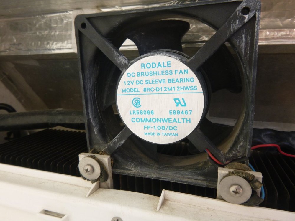

rideandfly Posted March 3, 2023 Posted March 3, 2023 Here's our 2015 LE2 12V fan for a three way Dometic refrigerator that has a temperature controlled on/off switch and a on/off switch on the main panel at the entrance door. 2 Bill 2015 LE2 2024 F-350 6.8L

John E Davies Posted March 3, 2023 Posted March 3, 2023 The Dometic 3 way did not have a fan originally. At some point it started to come with one pre-installed by the factory, so Oliver no longer added a separate fan and circuit. That is how it is in Hull 218, delivered in April 2017. Unfortunately the Dometic fan is located right in the middle where you cannot access it to clean or replace it when it starts to screech. You can barely see it with a flex borescope… You can disconnect the fan’s power wire from the circuit board, I ran my fridge that way for years, but I no longer recommend that you do that. If the fridge has never been out for inspection, you should do it now and not later. The Oliver Dometic installation is STUPID ENGINEERING, frustrating for the owner and above all it is a very serious fire hazard. Fact not opinion. Please read this thread: https://olivertraveltrailers.com/forums/topic/8865-fridge-fires-if-you-have-an-older-hull-you-really-need-to-pull-out-that-fridge-now/ John Davies Spokane WA 1 SOLD 07/23 "Mouse": 2017 Legacy Elite II Two Beds, Hull Number 218, See my HOW TO threads: Tow Vehicle: 2013 Land Cruiser 200, 32” LT tires, airbags, Safari snorkel, Maggiolina Grand Tour 360 Carbon RTT.
rideandfly Posted March 3, 2023 Posted March 3, 2023 3 hours ago, John E Davies said: You can disconnect the fan’s power wire from the circuit board, I ran my fridge that way for years, but I no longer recommend that you do that. If the fridge has never been out for inspection, you should do it now and not later. John, Thanks for the photos and link. For the folks that have a 3 way Dometic refrigerator fan located where your fan was located, what if they disconnect power to their existing fan leaving that fan in place and install a new 12V fan & auto switch where located on earlier LE2 campers, with manual switch at the main switch panel at the entrance door? Bill 2015 LE2 2024 F-350 6.8L
