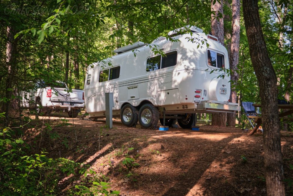

This is what I dealt with this week.  First time, and was nervous about it.  I used four large solid chocks.  Two are simply 4x4s wrapped in rubber non-slip material, that other are purchased heavy duty solid rubber triangle chocks.
And, I hate to ask, but better safe than sorry, do you see anything terribly wrong with what I've done in the pics?

I have been in that situation, one time only, and I hated it. There was no other site available and the nearest other CG was up a long steep nasty dusty gravel road
Wheel ramps or big rocks are best, if there are any around, use them to elevate the lowest side as far as possible, USE A SPOTTER.
Chock the downward sides of all four tires. Kick or hammer them in tight.
* Let the trailer roll back solidly against the chocks! * If you don't do this, it will bind up the ball and the trailer will roll back when it disconnects.
Unhitch but leave the safety chains attached until you are sure it is all stable.
Level the trailer.
Go to the host or park ranger and complain heavily, there is no reason for a developed site to be like this. Ours was in Great basin NP, we had it paid for three nights. The next day we left it and went to the nasty CG and found a more level spot.
Discretion is better than valor. If you think the situation is dangerous, leave.

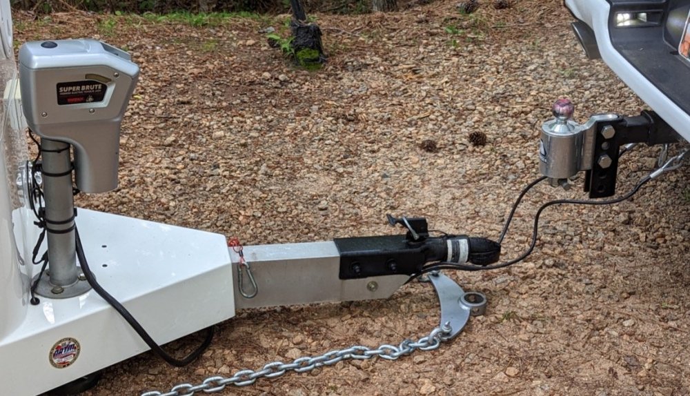

I have felt the need to tie the truck to trailer only once but the runaway chains are positioned just right for the job - they are built to handle the load of a Legacy II making a run for it.
I carry a milk crate full of 2 X 6  blocks.  I use three under all my jacks to act as a shear-plane.  Should for some reason the trailer moves, I'll hear a clunk and recall that I failed to use my check list.
In your hill park picture, I see you are doing your best to keep Ollie in place.  You even have a block to act as your shear-plane if it moves.  Bravo!
The two suggestions would be to:
A.  Use a line and tie off your brake emergency cable to a tree.  If the trailer moves at least your Ollie brakes will activate.
B.  Bring more 2 X 6 blocks and shorten up the lever arm of the jacks as much as possible.   GJ says:
"Jack up Ollie as you need, but keep the jack extensions as short as your pre-planning will allow"

Leave at least one of our safety chains connected until AFTER you have chocked and leveled Ollie.
When preparing for departure, back up to Ollie and first connect one of the safety chains.
As I have stated before:  "Nothing like having a 6,000 pound anchor!"

@Geronimo John and everyone, thanks for the reminders. More 2x6s are needed. With careful design and planning it might be worth making several of the interconnect, so in my case this week, I could have assembled a ramp-like solution to at least reduce the slopping affect. The upper most plank could have a "stop" block (make from oak) glued and screwed to the very end so you know you cannot easily to too far.

The only thing I would change here is to turn the HF chocks over. The ridged side should be on the ground and the slightly concave side should be against the tire. In another of your subsequent posts it is clearer than these photos that they are upside down.
Also, when breaking camp, raise those rear jacks before raising the tongue. Keep the chocks in place until completely hooked up. You don't want to make the front jack try to lift the whole weight of the trailer and you certainly don't want the trailer at the bottom of the hill.
I think you made poor campsite into a completely workable one.  We've run into this same problem in various spots, especially at Quartzsite.

I broke down camp just like you said, raised jacks, slowly, and kept safety chains connected to truck and was ready to pull brake pin too if needed.  But, it was steady as a rock.
