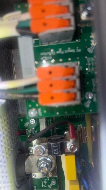

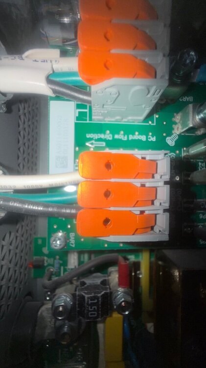

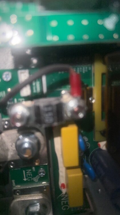

Rivernerd Posted August 4, 2023 Author Posted August 4, 2023 This is an update to the continuing saga of shutdown issues with our Xantrex Freedom XC Pro 3000 Watt inverter. In short, several days after the first hard reboot, we again began to get inverter shutdowns under heavy load. A second hard reboot also produced good short-term results, but did not "stick" long term. Earlier this week, Jason Essary authorized me to drop the Low Battery Cutoff (LBCO) level from the default 12.0V advised by Lithionics to 11.5V. I then ran another 4-minute test using 12V battery power through the inverter to run the microwave at 100% (with a pitcher or water inside to protect the microwave), at various SOC levels from 97% down to 22%. Although the Xantrex remote continued to report DC voltages as low as 11.8V during this test, the Seelevel "Batt" gauge reported DC voltages no lower than 12.2V. And most important, my trusty multimeter reported actual battery voltages (at the battery bank) no lower than 12.7V, with the microwave on full power at 22% SOC! So, under 11500+watt load, there was a 0.4V variance between the DC voltage perceived by the inverter and that perceived by the Seelevel monitor, while there was a 0.9V variance between the voltage perceived by the inverter and actual DC battery voltage verified with a multimeter. To me, this confirms that those expensive Lithionics batteries are not at risk under these conditions, since actual DC voltage did not drop below 12.7V. It appears to me that setting the LBCO at 11.5V compensates for the fact that, when under heavy load, our inverter misperceives the actual battery voltage by as much as 0.9V (12.7V actual -11.8V perceived=0.9V). It still concerns me that our Xantrex inverter misperceives DC voltage when under heavy load, but this new "workaround", i.e., setting the LBCO artificially low, enabled me to run heavy wattage loads on inverted power even at lower SOC levels, as the system was designed to do. With the LBCO set at 11.5V, even though the Xantrex inverter perceived DC voltage of 11.8V, there, of course, were no inverter shutdowns or LBCO "[01]" warnings. With that setting, it appears we can use high-wattage appliances on inverted power at least down to 22% State of Charge (SOC). This is encouraging. My wife and I are boondocking this weekend. We plan to use high-wattage appliances, including a hair dryer and the Truma AC, as needed. I will update this thread after that "real world" test . 3 Hull #1291 Central Idaho 2022 Elite II Tow Vehicle: 2019 Tundra Double Cab 4x4, 5.7L with tow package
Coddiwomple Posted August 4, 2023 Posted August 4, 2023 For the Elite 1 Folks...... I too have been working with Jason E on this and have an Elite 1 with the 2,000 watt inverter. After changing the LBCO to 11.5 volts through the app and testing multiple times (4 cups water for 4 minutes in microwave), I was able to succesfully use the microwave all the way down from 100% SOC to 14% SOC with no alarms or overload cutoff. Happy with results. 2 David & Martha from North Plains, Oregon. 2023 Elite 1 Hull 1382 "Coddiwomple" with full Truma & Lithium Pro packages. 2002 Toyota Tundra 4.7L. DC-DC Victron Orion XS 50 amp. Truma soft start.
