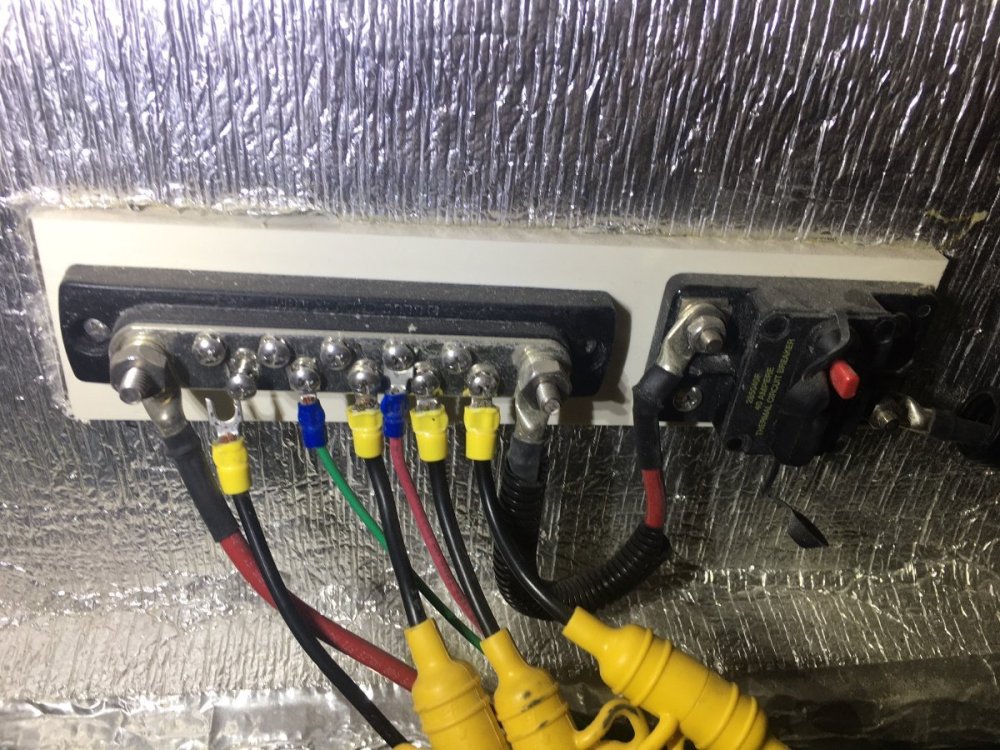

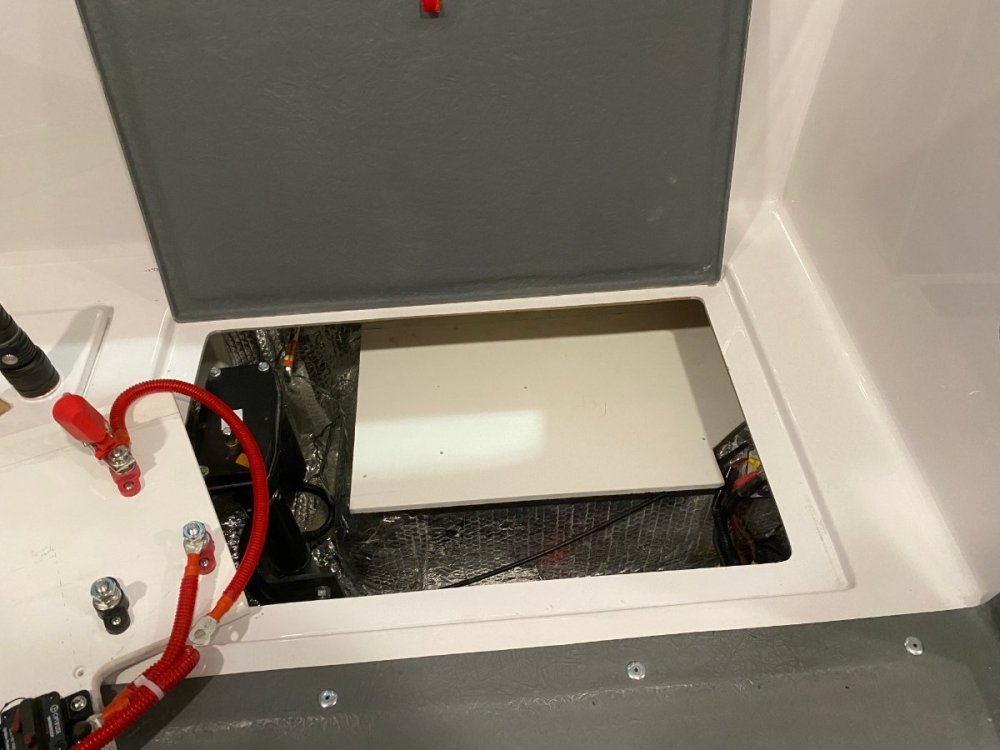

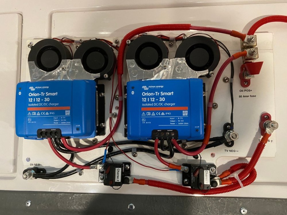

Here is what my install looked like. I epoxied a 1/2" marine white board to the  wheel well. Attached everything to a piece of 3/4" marine board and then attached the 3/4" board to the 1/2" board.  Space was definitely at a premium.  My test showed each charger at 38Amps before warm up. After one hour one charger was  34Amps at 96degrees F, and the orther 32.5 amps @ 100degrees F.  Victron rates the 12-12/30 at 104 degrees F. Anything over 104F the Amps decrease below 30 F. I have heard as low as 25 degrees F
each pair of fans positive lines are connected to the Optifuse breaker. So I can turn off either of the chargers and associated fans from the other charger.
This is the  1/2 base.

I am familiar with that policy, so we’ll leave yesterday behind.  Your DC - DC layout looks like it’s well thought out and executed.  Keep us posted on your real world experiences and thank you for the 'show and tell'.
Wow @2008RN this is awesome! You have a very well thought out design, hardware laid out nicely and personally I cannot wait to see your DC-to-DC gear mounted, working and to hear of your results!
The cooling fans reminded me of a thought I've had before. Perhaps @Ronbrink can chime in too, who worked his DC charger installation --
Is there a difference in where you locate the charger(s)? Should the charger be closer to the alternator or closer to the batteries, does it matter? Of course, when you install an inverter, it must be as close to the batteries as possible! Does position matter in the DC-to-DC design? (closer to starter or house batteries?)
My first thought on this installation would be to install the charger up front near the starter batteries. There's generally room in pickup trucks just in front/under the battery. Victron hardware is design for boating, should be mostly waterproof. If mounted up front it would cool while towing, no fans required. This way, there would be little concern if this hardware would cause harm to the $$$ Oliver (less overall risk).
Let me know what you think. You have researched this and I'm learning re your application. Thanks
The DC-DC should be mounted as close as possible to the batteries, at a location where there is sufficient room for proper ventilation. If proper ventilation is an issue due to the mounting location or size of the unit(s), then fans are often used. Although 2008RN made good use of valuable real estate at the rear wheel well below the street side bed, there is not much clearance between it and the hatch lid when closed. Knowing this, he took extra precaution in adding the fans to provide adequate ventilation to his superbly installed dual-unit setup. I my installation, 1/2” plywood was adhered to the fiberglass within the interior rear dinette seat hatch, just below the battery box enclosure (reflective insulation at upper righthand corner of pic). I have not experienced a heat issue with use of this 40A unit, even when traveling last summer to West Texas with daytime temps in excess of 110°.
