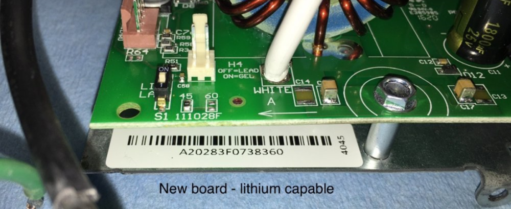

dewdev Posted February 27, 2024 Posted February 27, 2024 2 hours ago, Geronimo John said: Progressive Dynamics PD4045 LiCSV Upgrade.docxProgressive Dynamics PD4045 LiCSV Upgrade.docx 1.55 MB · 5 downloads Some of the 2018 OE2's PD Converters have a LI switch that allows use with Litho's. Below is a picture of the LI/LA switch and a hard copy of John Davies procedure to upgrade the PD if you don't have the switch as well. Geronimo John: Thanks for Posting John Davies procedure. 2 2018 Oliver Elite II, Twin Bed, Hull #354, new Lithonics batteries and Xantrex Freedom XC 3000 Pro Inverter in 2025 2024 RAM 1500, 4 x 4; Gas. 5.7L V8 Hemi MDS VVT Torque; 3.21 rear axle ratio w/TIMBREN spring rear suspension addition Maine
ADKCamper Posted February 27, 2024 Posted February 27, 2024 Thanks for the link... my PD converter does not have the LI/LA switch. I could replace it with one that does. I've been debating whether it makes sense to move the converter out of the fuse/breaker panel to a separate device. This *might* be something like a Victron Phoenix Smart IP43 Charger so that I could control & monitor converter-based charging activity with the Victron app. Apologies for the thread creep... 2 Tom & Holly 2018 Oliver Legacy Elite #409 - 320W rooftop solar, 300Ah Epoch LiFePO4, Victron BMV-712 & Smart Solar MPPT 100/30, Progressive Dynamics PD4060CVS 60Amp Lithium-capable Converter, Xantrex PROwatt SW 2000 inverter, Bulldog HD1213-0656 Shocks, Falken Wildpeak H/T02 235/65R16C 121/119R; Tow Vehicle: 2026 Silverado 2500, 6.6L Gas, 4x4, Dbl Cab, Std Bed.

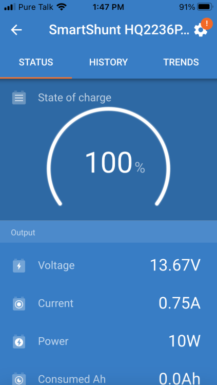

ADKCamper Posted February 29, 2024 Posted February 29, 2024 14 hours ago, ScubaRx said: You can do that with what you already have. Not sure how to do that, other than to take the total charge current (from the smart shunt via the Victron app) and subtract (in my head... I hate to do that LOL) the present solar charge current (again, from the Victron app) to compute the converter charge current... assuming there are no 12v loads active at the same time (which would result in 2 unknowns in the equation SolarChargecurrent + ConverterChargeCurrent -Active12vloadCurrent = TotalChargeCurrent). Tom & Holly 2018 Oliver Legacy Elite #409 - 320W rooftop solar, 300Ah Epoch LiFePO4, Victron BMV-712 & Smart Solar MPPT 100/30, Progressive Dynamics PD4060CVS 60Amp Lithium-capable Converter, Xantrex PROwatt SW 2000 inverter, Bulldog HD1213-0656 Shocks, Falken Wildpeak H/T02 235/65R16C 121/119R; Tow Vehicle: 2026 Silverado 2500, 6.6L Gas, 4x4, Dbl Cab, Std Bed.
jd1923 Posted February 29, 2024 Posted February 29, 2024 1 hour ago, ADKCamper said: Not sure how to do that, other than to take the total charge current... Agreed, I always see one Amp number, the net of -A being used and +A from any charging source. It would be nice to read Amps in and out individually. We have an old shunt as part of the Blue Sky solar charger installation. So, if I was good at reading their panel, I imagine it reads solar charge data alone. You can install multiple shuts to segregate systems for this purpose. I installed a Victron SmartShunt at the battery ground, so this reading is a net IN and OUT Amps. The pic shows an afternoon reading, shore power unplugged, solar has the batteries fully charged. There is a net +0.75A of the incoming solar, less the outside courtesy lights (we leave them on 24x7 to deter rodents), electronics and other parasitic draw. 1 Chris & John in Prescott, AZ | 2016 EII #113 | '01 Ram 2500 Cummins!
