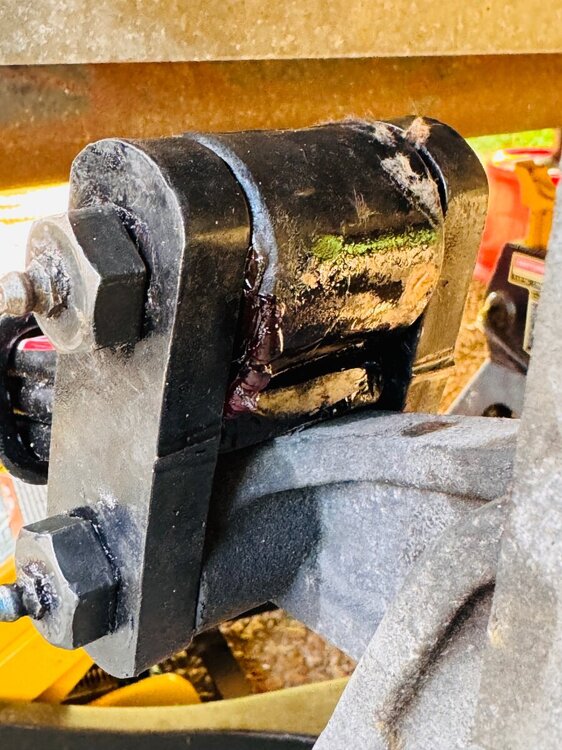

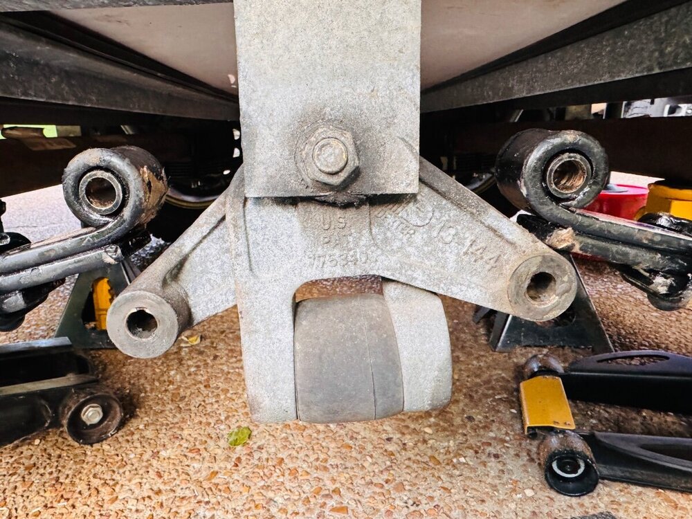

Update to shackle issue installing ALCAN leaf springs.
Received the 2 1/4 in long shackles and installed today. Installation went straight forward but when I was greasing the assembly I noticed that when fully articulated the 4th leaf was still hitting the arm of the EZ-flex. So I called Lew and after some discussion he recommended to just keep an eye on it and that he didn't think it would cause any issues since so many other people had many miles on theirs with no reported issue. Also, offered the option using a cut-off tool to take a 1/2 in or so off the length of the leaf. Didn't go that route. Yet!
I am interested in what others may notice upon maintenance if theirs hit when fully articulated. @Mountainman198 @MAX Burner and many others. My axles are 3500 lb  3 in diameter axles so may not be the same for everyone.
My trailer is back together with new tires, shocks, and springs. Finally.
IMG_9861.thumb.jpeg.6e6749b8c7bb93d10051ed29bda6811e.jpegIMG_9851.thumb.jpeg.dcc1a3a35e39bd836f824e95a90906d1.jpeg
My Alcans do not hit like yours show, however if they did I think I would taper the square end of the second leaf with a grinder so it would clear.
Let us know how you decide to proceed
My question is why doesn’t yours hit. Do you have the same EZ-flex and 2 in or 2 1/4 in shackles. Does your 2nd leaf extend to the eyelet like mine?
I re-used the stock shackles. Did you do the same or are your shackles “other”?
2021 Elite II, Hull# 898
The original Dexter HD 2 in shackles first. Leaf hit the arm, unable to install.
Lew sent out 2 1/4 in shackles, able to install but still barely hit.
Going to use it and watch for issues. May end up cutting 2nd leaf.
Next time you do maintenance check your full articulated clearance. It is not obvious in the neutral position.
