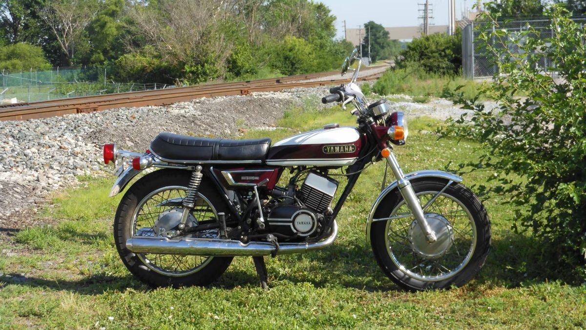

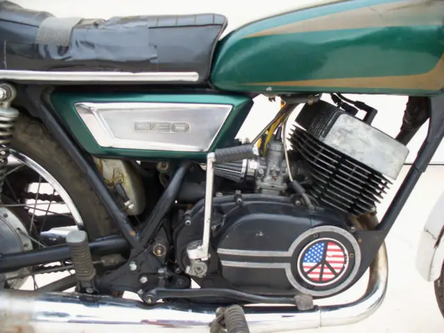

I really want to travel with this bike, my 1970 Yamaha R5! Though it needs everything done. I have all the parts it needs including new seat foam and cover, NOS taillights, carb kits, etc. Somehow I just found this picture online and it is the exact bike I own, same seat tears, America Flag Peace sticker on the side cover, bought in Florida 9 years ago for $900. I'd put some enduro tires on it for trail riding. This is a 350cc 2-stroke that can get up to highway speeds in just a couple of heartbeats! Second pic is an example of restored R5!

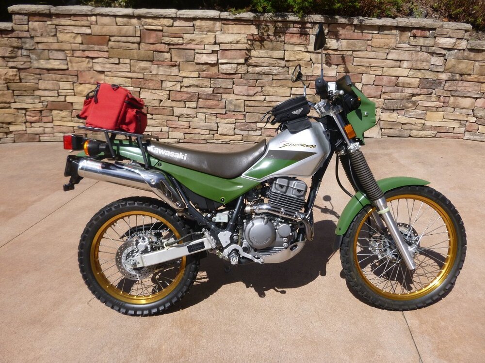

4 hours ago, Geronimo John said:
And a big box on the rear.
You mean  - like this?
