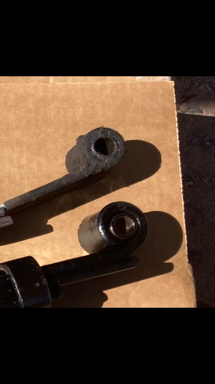

Question, are the Alcan wet pin bronze bushings (assume bronze) thicker (larger OD) than the Dexter bronze bushings? The Dexter bronze bushings are so delicate, during installation in the springs, it was easy to damage them. I may have missed this point in this thread.

14 minutes ago, rideandfly said:
Question, are the Alcan wet pin bronze bushings (assume bronze) thicker (larger OD) than the Dexter EZ Flex bronze bushings? The Dexter bronze bushings are so delicate, during installation it's easy to damage them. I may have missed this point in this thread.
Installing the bronze bushing on a Dexter 5 leaf spring coated with castor oil:
Yes. While I.D. Remains the same as stock, the bushing wall thickness on the Alcan is greater than the dexter ( Alcan is bottom in attached photo while stock dexter-supplied spring is on top).
  • Love 2
You were the first to get the Alcan springs.  Lew also said his wet bolts are specially made and have more space for the grease with no taper inside.  Something like that.
Thanks, this is another plus for Alcan over Dexter springs.
When I installed the Dexter EZ-Flex system on Ollie several years ago, I did not like how delicate the Dexter bronze bushings were in the springs.

We’re in Grand Junction this morning with the guys at Alcan installing new 5200 pound axles and new springs! I also noticed that heavier bronze bushings are used in the Alcan springs. The Dexter bushings are sintered bronze AKA Oilite bearings. These thin wall type bearings are the wrong application for use in a rough bore because they are so brittle. Typically they should be pressed into a finished bore then final reamed to correct final diameter. Anyway, the Alcan bushings are machined from bronze bar stock and are the correct application.
Is the comparison of a 1750 pound bushing to that of a 3000 pound bushing logical?

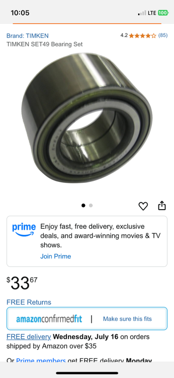

Okay, risking banishment from the planet and the inevitable public humiliation, my one and only update on my recent axle and spring upgrade. We are in the midst of a 3 1/2 month western trip. Granted a good deal of the trip was planned around a visit to Grand Junction Colorado we have made a complete trip out of that one appointment. I firmly believe that Oliver’s decision to change axles from the 3500 pound version to the 5200 pound version is one of the best decisions made. Nothing like extra capacity. Also the heavier springs are also a great benefit. I have noticed reduced rocking during travel. My original springs had relaxed quite a bit because I had only about an inch or less of clearance between the U bolts and the frame. There is now around an inch and a half to two inches of clearance which is probably a little more than what was originally there.
I have done a little research on the Nev R Lube Dexter axles with very limited cell service so more research to come. The bearings used for the 5200 pound axles are also used for the 6000 pound axles. So there is a little bit of extra capacity there. I also found out (not totally confirmed yet) that the bearings are also used for front and/or rear axles in several smaller cars. I also found out (not totally confirmed yet) that the Timken bearing used is a standard Set 49 bearing sold at every auto parts store for a fraction of what Dexter charges. The bearings are fairly easy to replace using a standard automotive wheel bearing press kit. So can be done on the road if needed. The bearing press is available at Harbor Freight and Amazon and I’m sure dozens of other places as well. Of course all the above information is to be confirmed once we get home in August sometime. Others are more than welcome to join in the research.IMG_3086.thumb.png.7b39787b5b692bf8ab65f87fe61bf9a3.pngIMG_3087.thumb.png.47351ecefb0b56e2efb0b8d2a3c80f44.png
