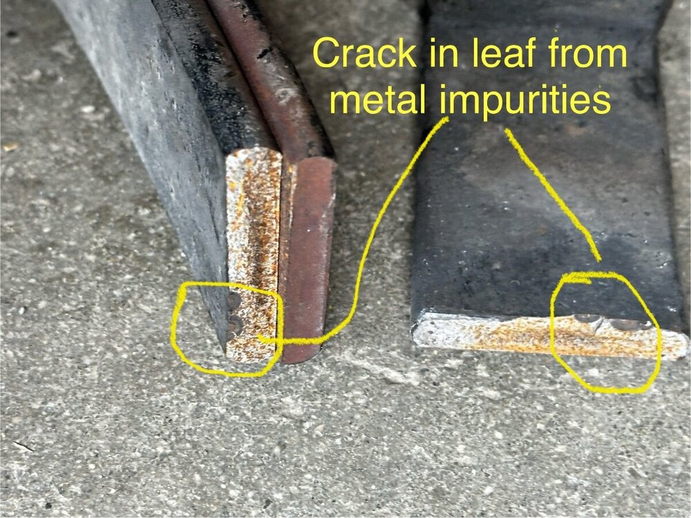

Upon returning to the trailer I noticed that the steps were much closer to the ground.

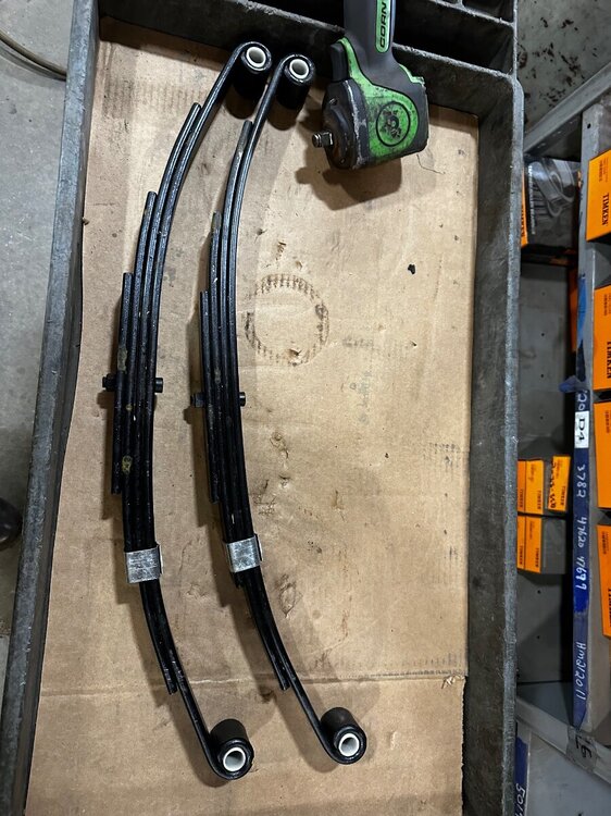

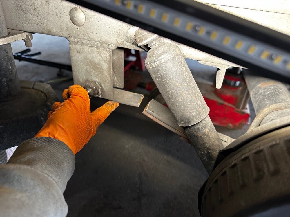

Upon further inspection I found (After 5 years and about 65000 miles ) Hull 505 EII finally broke a leaf spring.
it was the curb side rear and sheared just where the first and second leaves meet.

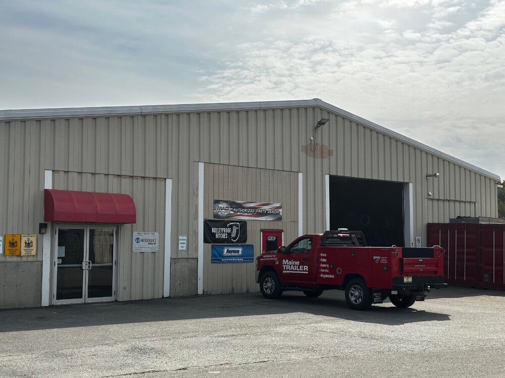

Lucky  this happened 5 miles from a Maine Trailer location.
it looks like the issue was caused by a small crack in the leaf that has the bolt eyes.  That small original impurity caused internal rust weakening the metal and over time and bumpy roads it finally snapped right where the next leaf touched the longest spring.
I called them at 11:30 and they  got us in on a Friday at 12:30 and on the road by 2:30.  That’s pure luck!

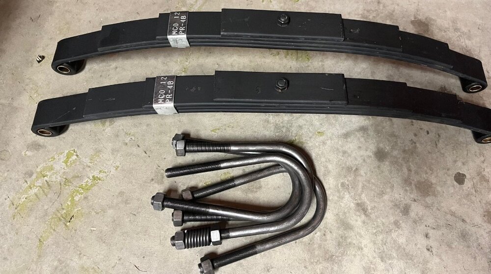

I had a spare pair of springs in the bumper from our Alaska trip,  but had them put on 2 new springs that were a perfect match, so I kept the spares and put on the new ones on the rear axle.  $314 installed!
new springs

Added pix of crack

Thanks for posting.  All Oliver owners need to know that the factory 4-leaf springs have a limited life, and that springs often fail far from home, because that is when they are asked to flex the most.  That is why I now have a set of four Alcan 5-leaf springs for my Elite II.

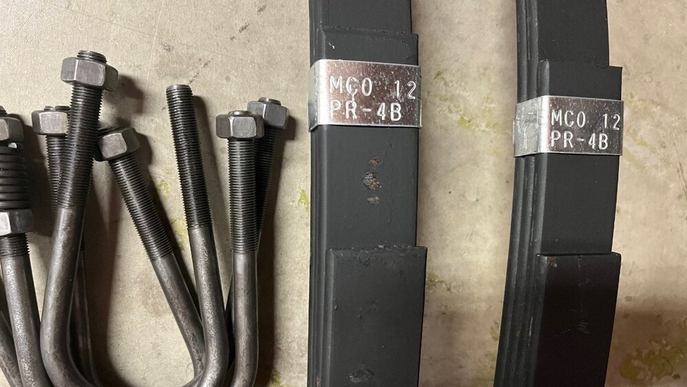

My new springs from Maine trailer l are clearly Chinese. IMG_0886.thumb.jpeg.d6352bf80f96eca590b6b245d6a27feb.jpeg

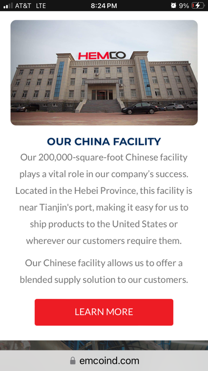

According to the TRP website (TruRyde parent company), they merged with EMCO in 2016. EMCO was founded in Oklahoma but has a large spring manufacturing facility in China. Fingers crossed that your springs came from the OK facility and are made with USA steel.
I had a back and forth on email with TruRyde, asking about country of origin on both the manufacture of their springs and sourcing of steel for both TruRyde and EMCO springs which fit our application. It was the strangest of exchanges where I asked several times for their sourcing of steel for their springs. I was met each time by different yet similarly evasive responses to my direct questions. I shook my head and gave up on them.
Below screen capture is from EMCO website.
2021 Elite II, Hull# 898
Okay, that’s our definitive answer. Anytime someone is evasive in answering a direct question it only means one thing and one thing only. They are not proud of where their product is made and that means china! Okay, TruRide is off my list. I can buy less expensive china made springs most anywhere. The cheap ones I bought with u bolts, nuts, and bronze bushings are for emergency roadside replacement just to get me home. When I can go to Colorado I’ll get the USA made springs and not need the emergency spares. Those will go in the yard sale pile. Less junk to haul around.
