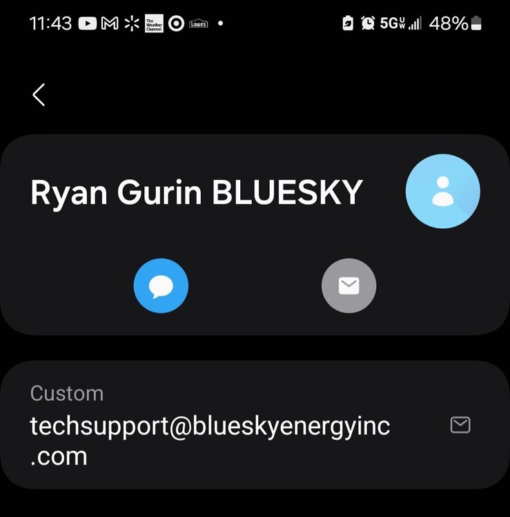

Moderators SeaDawg Posted December 12, 2024 Moderators Posted December 12, 2024 Changing settings on the blue sky controller is a bit tedious, but not that hard. (Old school dip switches. No blue tooth,etc. ) Send the amazing customer support guy at Blue Sky (Ryan) an email, with your phone number and email, and all equipment info,and he will likely be able to walk you through everything you need to do on the blue sky end. 2008 Ram 1500 4 × 4 2008 Oliver Elite, Hull #12 Florida and Western North Carolina, or wherever the truck goes.... 400 watts solar. DC compressor fridge. No inverter. 2 x 105 ah agm batteries . Life is good.
jd1923 Posted December 12, 2024 Posted December 12, 2024 @T-Oliver glad to see you got the Epoch sale! Which one(s)? #AHs? I don't remember HW dipswitches on the Blue Sky (did I miss something?), just a whole lot of menu selections on the IPN-Pro interface. I talked to and emailed with Ryan Gurin a few times. What a great, very detailed and helpful guy He even advised me on setup of the Victron MP2, that's going beyond the call of duty! He sent me this link and it's just what you need. Later part of the video bottom of page goes through the setup steps. It took me 3 tries to get through all the keystrokes without making a mistake! How to program BSE charge controllers for LiFePO4 batteries – Sunforge LLC The settings are similar to what Ken wrote. Off my head, I remember Epoch suggesting 14.2V where Battleborn states 14.4V but check your battery Epoch battery manual to be sure. It's great to have the settings list in writing in addition to the video to keep things straight. Chris & John in Prescott, AZ | 2016 EII #113 | '01 Ram 2500 Cummins!

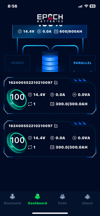

T-Oliver Posted December 27, 2024 Author Posted December 27, 2024 Thanks for the assistance and information. The Epoch batteries (2x300AH) are installed with a new PD charging module utilizing 2017 Oliver wiring (20 degrees and snow) The batteries are fully charged, sofar so good. Now if I could only get the Blue Sky programing menus to behave 2

jd1923 Posted December 28, 2024 Posted December 28, 2024 On 12/26/2024 at 7:46 PM, T-Oliver said: Thanks for the assistance and information. The Epoch batteries (2x300AH) are installed with a new PD charging module utilizing 2017 Oliver wiring (20 degrees and snow) The batteries are fully charged, so far so good. Now if I could only get the Blue Sky programing menus to behave. Check your Epoch Manual (see pic). Your app is showing 14.4V to the batteries fully charged. I believe the high voltage settings is recommended at 14.2V. If voltage cannot be fined tuned on the PD charger, it will be fine but do not leave your Oliver plugged into shore power continuously (always a good recommendation). Watch that Blue Sky video when he runs through the programming several times until you get used to the keystrokes. It took me 3-4 times to enter all the strokes correctly. If I had struck out again, I would have asked my son to do it. He is of the video-game generation, and he would have nailed it first or second try. Get the right 13.6V, 14.2V and other settings correct for the Blue Sky and this will be your better Epoch LiFePO4 charging curve. I have solar charging on always and shore power connected only when needed. Chris & John in Prescott, AZ | 2016 EII #113 | '01 Ram 2500 Cummins!
Teaney Hull 292 Posted March 30 Posted March 30 On 12/10/2024 at 9:31 PM, T-Oliver said: I haved admired everyone's upgrade projects Could the process br as simple as: Swap the PD charging module Swap the AGM for lithium Reprogram Blue Sky charge controller 2017 Elite II Hull 254 On 12/28/2024 at 2:02 PM, jd1923 said: Check your Epoch Manual (see pic). Your app is showing 14.4V to the batteries fully charged. I believe the high voltage settings is recommended at 14.2V. If voltage cannot be fined tuned on the PD charger, it will be fine but do not leave your Oliver plugged into shore power continuously (always a good recommendation). Watch that Blue Sky video when he runs through the programming several times until you get used to the keystrokes. It took me 3-4 times to enter all the strokes correctly. If I had struck out again, I would have asked my son to do it. He is of the video-game generation, and he would have nailed it first or second try. Get the right 13.6V, 14.2V and other settings correct for the Blue Sky and this will be your better Epoch LiFePO4 charging curve. I have solar charging on always and shore power connected only when needed. Will Follow as I’m about to upgrade 2017 Hull 292 Gary and Anita Teaney and Ranger 2017 Oliver Elite II Hull 292 2018 Nissan Armada Tampa, FL
