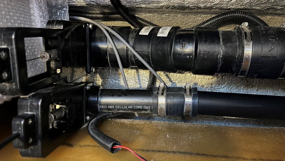

Imelda Posted December 30, 2024 Posted December 30, 2024 Hi all, Imelda Here hull 642 pulled by Nissan Titan. I haven't been on the forum for a while now as I have need getting out and about and enjoying my Ollie😁. I noticed at the last dump station the black water was leaking when I removed the end cover so I am assuming the black water blade valve will have to be replaced as it is either damaged or not closing properly. I have replaced on of these on my horse trailer w living quarters and it was straight forward as it was outside the trailer. I think the Ollie one is under the street side bed. I haven' t seen a post on replacing this blade valve on an Oliver but I should also check to make sure nothing is catching on the blade, Any tips? Imelda
jd1923 Posted December 30, 2024 Posted December 30, 2024 12 minutes ago, Imelda said: I think the Ollie one is under the street side bed. The larger of the blade valves under the front dinette seat is for the black tank (see pic). The smaller is to cut off drain water from going out on the shower floor while traveling and it's the gray tank valve that is under the streetside bed. First, I would fill the blank tank with water to be certain of leak. If it's just a little black water after travel, it is likely black drain water left in the main line when dumping with the trailer level or forward leaning (without raising the front of trailer higher which is a good practice). Quite a bit of black waste can sit in this long plumbing. Question, are you getting a quart of black or gallons? I would work the drain many times prior to the pain of replacing! After filling, open and close the blade repeatedly. This may dislodge something lodged on the blade. You could use a chemical drain cleaner letting it soak for a while and then again open and close. I forget, but there also may be a way to remove the valve blade for cleaning without replacing the entire valve. Best wishes. 6 Chris & John in Prescott, AZ | 2016 EII #113 | '01 Ram 2500 Cummins!
Moderators mossemi Posted December 31, 2024 Moderators Posted December 31, 2024 7 hours ago, Imelda said: not closing properly A couple more steps that I would add to @jd1923 suggestions is to make sure that both the black and grey blade valves are closing completely. Both black and grey tanks empty out of the same pipe at the rear bumper, so either blade valve may be leaking. Try pushing down on both blades to check for any movement which could indicate the need for a cable adjustment. And if you haven’t previously lubricated the valve cables, it will help valve opening and closing. It goes without saying that troubleshooting the sewer system it much easier to do at a full hookup site. Mossey 5 Mike and Krunch Lutz, FL 2017 LEII #193 “the dog house”
Imelda Posted December 31, 2024 Author Posted December 31, 2024 Thank you jd1923. about quarts of black water not gallons coming out so there may be a blockage preventing the valve shutting and I has noticed that to get all the tanks drained I have to tip the front of the Oliver up (it cannot be flat) to get both tanks drained. I will try filling and flushing the black tank and see where I get , I will keep you posted. 1
Geronimo John Posted December 31, 2024 Posted December 31, 2024 (edited) 21 hours ago, jd1923 said: I would work the drain many times prior to the pain of replacing! After filling, open and close the blade repeatedly. This may dislodge something lodged on the blade. You could use a chemical drain cleaner letting it soak for a while and then again open and close. I 14 hours ago, mossemi said: A couple more steps that I would add to @jd1923 suggestions is to make sure that both the black and grey blade valves are closing completely. Both black and grey tanks empty out of the same pipe at the rear bumper, so either blade valve may be leaking. Try pushing down on both blades to check for any movement which could indicate the need for a cable adjustment. And if you haven’t previously lubricated the valve cables, it will help valve opening and closing. It goes without saying that troubleshooting the sewer system it much easier to do at a full hookup site. Great info from JD and Mosseim!. I believe you have 4 or 5 years on your OTT. A good reason to lube the cables to the valves before starting the below. Having a flow control valve on your gray water hose discharge end would work if a helper is not available. Also a head lamp to see down the toilet tank or bathroom sink drain line is helpful in not over filling and causing a flood in the bathroom. First dump and rinse the tank at a dump station. Adding a bit of food grade dye in one tank will quickly help you figure out which tank is the problem. Most likely it will be the black tank so I would start there. Would not suggest using blood red as if it gets away from you, it could traumatized the neighbors. 🙂 Blue frosting dye would be a better choice. Full Hookup and a clear fitting at the end of the dump hose is also useful. Once you know which tank is of concern, you could use your gray water hose to fill your tank. Black tank is easy just open the toilet valve. If it is the gray tank, then modulate the flow down the bathroom sink to hyper flow the gray tank. Start with the blade valve closed and fill the tank with close coordination with your partner on the hose bib valve. In an emergency situation kink the hose twice and you'll slow down the flow a lot. With a full tank, then open the valve and keep the gray water hose wide open filling while the tank is draining. Likely anything bad will find itself down the sanitary line to the treatment plant. If this does not work, then go aggressive with harsh chemicals. When done, lubricate the drain valves. Hope this works for you. GJ Edited December 31, 2024 by Geronimo John 4 TV: 2019 F-150 SuperCrew Lariat, 3.5L EcoBoost, 10 Speed Trans, Max Tow, FX-4, Rear Locker OLLIE: 2018 OE2 Hull 342, Twin Bed. OLLIE DIY’s: Timken Bearings, BB LiFePO4's, Victron 712 Smart, 350 Amp Master Switch, Houghton 3400, Victron Orion DC - DC, 3000-Watt Renogy Inverter, P.D. 60-amp Converter, Frig Dual Exhaust Fans, Kitchen Drawer Straps. Front Wardrobe Shelves, Snuggle Shelf. TV DIY’s: 2 5/16" Anderson System, Nitto recon’s, Firestone Rear Air Bags, Bilstein 5100’s, Mud Flaps & Weather Tech all, installed Ham Radio (WH6JPR).

Moderators Mike and Carol Posted December 31, 2024 Moderators Posted December 31, 2024 First thing I would do is to open the dinette seat and give a push on the silver cylinder on top of the valve. Can you push it down (this is after closing with the cable)? If you can, then a simple cable adjustment may be all that is needed. There’s a set screw on top that holds the cable in, it may have slipped over time (mine did). I’ve adjusted it a couple of times over the years. Also, you could have some black water debris that is stuck in the bottom of the slot where the blade rests when closed. I also had that happen and after taking it out and cleaning it all was well. Mike 7 Texas Hill Country | 2016 Elite II #135 | 2020 Ram 2500 6.7L

johnwen Posted January 1 Posted January 1 On 12/31/2024 at 9:13 AM, Mike and Carol said: First thing I would do is to open the dinette seat and give a push on the silver cylinder on top of the valve. Mine needed adjustment as well, one time, I found the valve didn't fully close as I could push it down a little. A lot of good ideas listed here....especially black vs grey. The only thing I can add is that my black tank handle offered some resistance (sprung back out a half inch or so) when I pushed the handle in and I found that holding the handle in for about 5 seconds was enough to allow that long cable to offer enough pressure to fully close the valve and the handle did not try to spring back out. We also switched to the Calgon beads/ Pinesol /water solution to clean and lubricate the tanks and blade valves and the handle seems a little smoother to operate. So far so good ") John 1 5 Oliver II #996 "Bessie", 2019 Silverado LTZ 5.3, Veterans https://wenandjohnsadventure.com/
