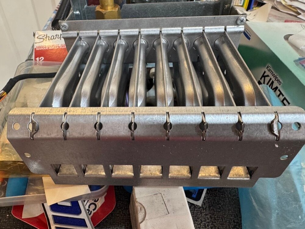

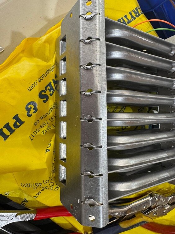

Guest Posted March 25, 2025 Posted March 25, 2025 Found a brand new burner assembly from a "cosmetically damaged" AquaGo on eBay and bought it for $200. One goal was to see what is involved in removing said assembly, since we do not have access to a service manual. I also wanted to see what was required to crimp the ends of the intermediate burners. Having done that now, I will also put a small TIG weld bead at the ends to make sure there is never any movement. Still have not heard back from Truma to schedule a replacement unit, but now that I've seen what is involved in replacing the burner, I'm not going to bother. I'll wait for Oliver to get to me in their recall queue, but I'll have a burner that I am comfortable with already installed.
Galway Girl Posted March 25, 2025 Posted March 25, 2025 (edited) @katanapilot Curious, in the 2 pix, the top one has only the end tubes crimped, in the bottom all tubes are crimped. Is the bottom unit from the item you bought one bay? Or did you simply crimp the tubes yourself? Our replacement shipped to the repair facility a couple days back. (On Friday Mar 21,2025) Craig Edited March 25, 2025 by Galway Girl 2019 Elite II (Hull 505 - Galway Girl - August 7, 2019 Delivery) Tow Vehicle: 2021 F350 King Ranch, FX4, MaxTow Package, 10 Speed, 3.55 Rear Axle Batteries Upgrade: Dual 315GTX Lithionics Lithiums - 630AH Total Inverter/Charger: Xantrex 2000Pro Travel BLOG: https://4-ever-hitched.com Lower 48 + Alaska Achieved in Maine Aug 2024 on way to Nova Scotia.
Guest Posted March 26, 2025 Posted March 26, 2025 1 hour ago, Galway Girl said: @katanapilot Curious, in the 2 pix, the top one has only the end tubes crimped, in the bottom all tubes are crimped. Is the bottom unit from the item you bought one bay? Or did you simply crimp the tubes yourself? Our replacement shipped to the repair facility a couple days back. (On Friday Mar 21,2025) Craig I crimped the ends. First picture was as delivered, second was after crimping the burner ends. Took 5 minutes. I'll add another picture when I TIG spot weld them.
Rivernerd Posted March 26, 2025 Posted March 26, 2025 14 hours ago, katanapilot said: I'll add another picture when I TIG spot weld them. Your burner assembly will then be "better than new." We submitted our replacement request to Oliver promptly after receiving the recall notice, but still we wait for a properly crimped burner assembly... 1 Hull #1291 Central Idaho 2022 Elite II Tow Vehicle: 2019 Tundra Double Cab 4x4, 5.7L with tow package
