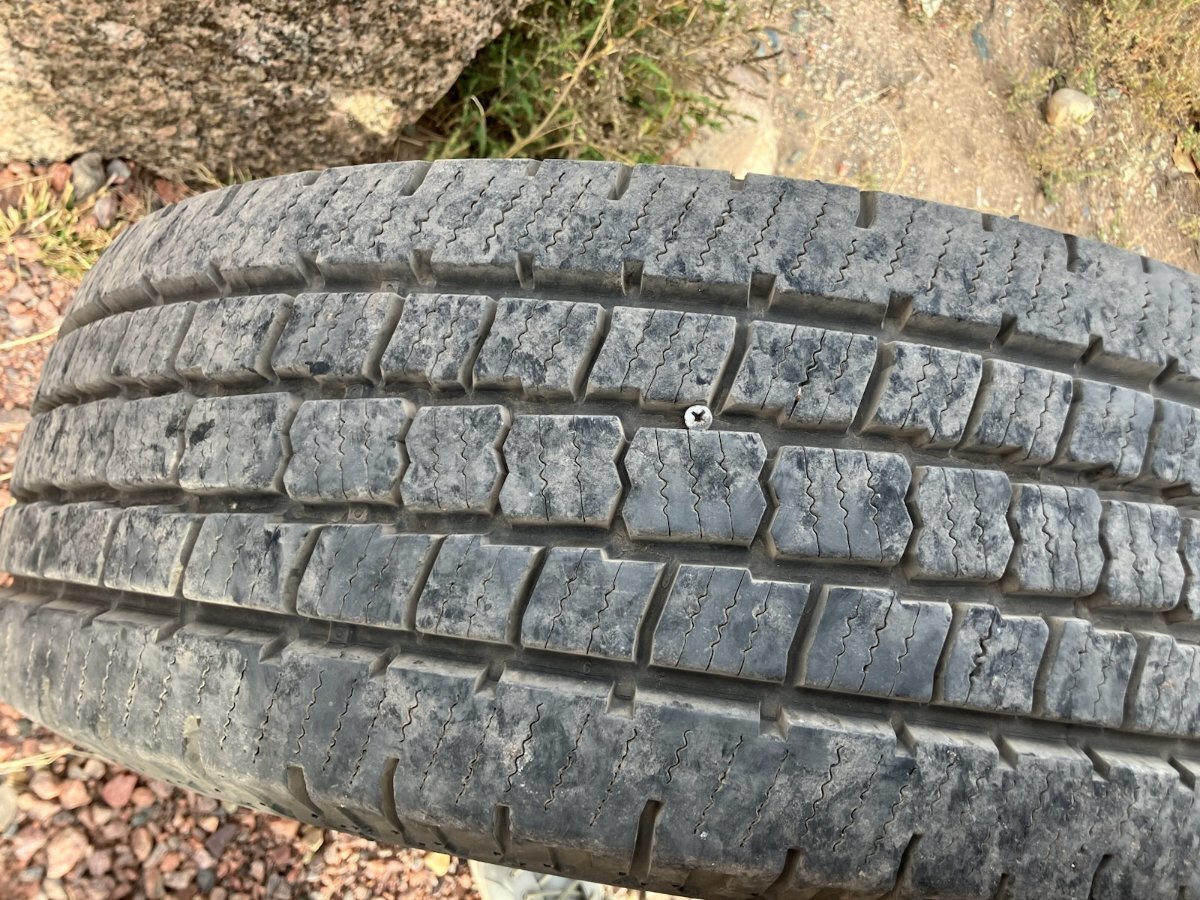

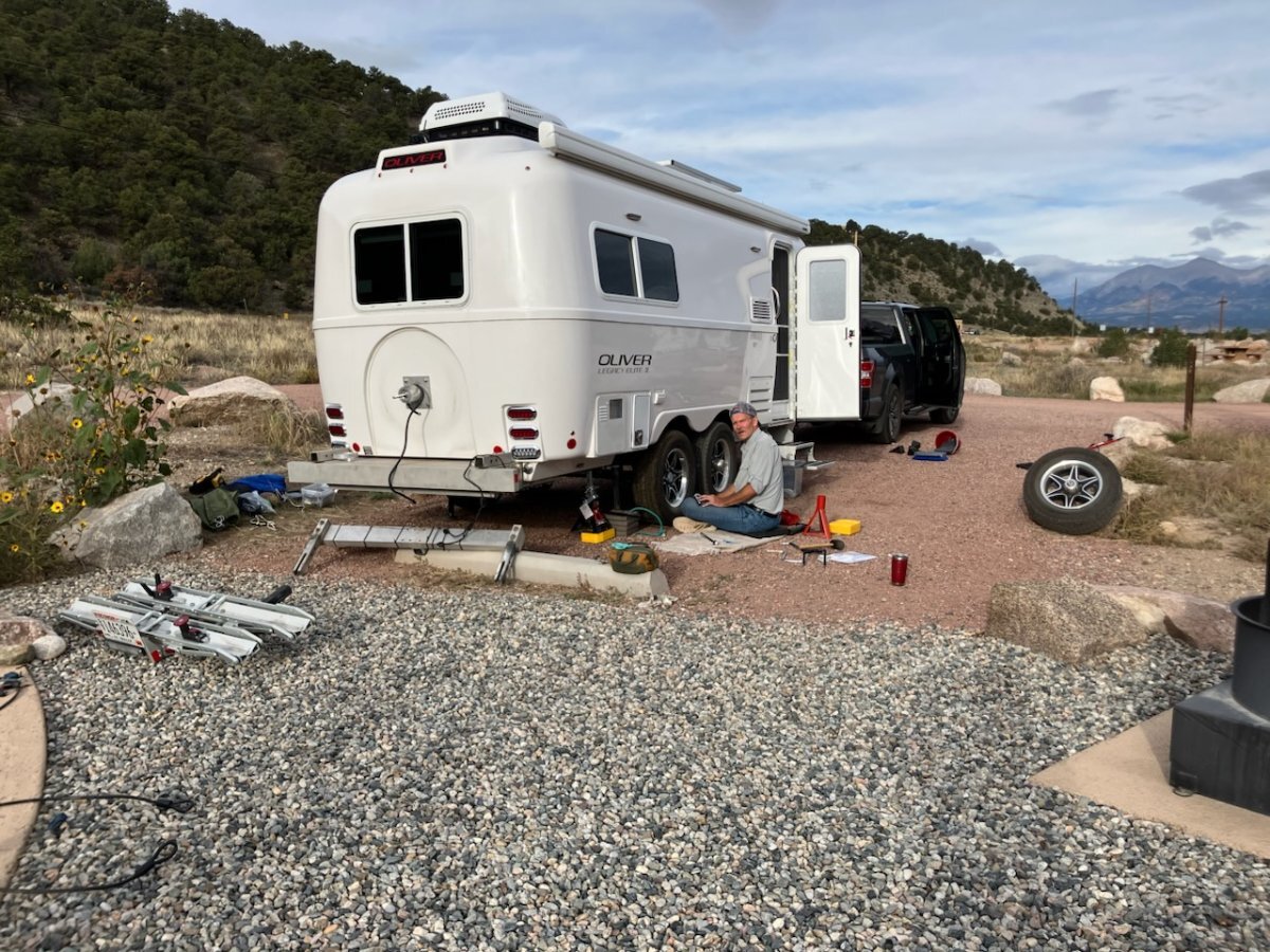

Gliddenwoods Posted Monday at 12:08 PM Posted Monday at 12:08 PM Oh I know this story too well. My yesterday morning in Salida, Co in the attached photos. I used both a jack and the stabilizing jacks. When using the stabilizer does one use both? Also, why not just remove the hub cap for socket access and then put back on? 1 2022 Oliver Legacy Elite II, Hull 1242, 9/26/22 Lithium Platinum Power/Solar Package Tow with Supercrew Cab 2019 F-150 4 x4, 5.0L 4-Valve V8 with 3.73 axle ratio & 157" wheelbase. F-150 GCWR of 16,900 lbs with maximum load trailer of 11,500 lbs.
Gliddenwoods Posted Monday at 12:10 PM Posted Monday at 12:10 PM Just now, Gliddenwoods said: Oh I know this story too well. My yesterday morning in Salida, Co in the attached photos. I used both a jack and the stabilizing jacks. When using the stabilizer does one use both? Also, why not just remove the hub cap for socket access and then put back on? Oh yes, having a bike rack on with two bikes is a real pain in the project... 1 2022 Oliver Legacy Elite II, Hull 1242, 9/26/22 Lithium Platinum Power/Solar Package Tow with Supercrew Cab 2019 F-150 4 x4, 5.0L 4-Valve V8 with 3.73 axle ratio & 157" wheelbase. F-150 GCWR of 16,900 lbs with maximum load trailer of 11,500 lbs.
Moderators topgun2 Posted Monday at 01:12 PM Moderators Posted Monday at 01:12 PM (edited) 4 hours ago, Gliddenwoods said: When using the stabilizer does one use both? Also, why not just remove the hub cap for socket access and then put back on? While not the safest - I've just used the stabilizer alone for changing a tire. Again - this is not the safest procedure by any means. The "hub caps" remove from the back. Therefore, if one is simply checking the torque of the lug nuts , the removal of the hub cap is a bunch of extra work. Bill Edited Monday at 04:59 PM by topgun2 2 2023 Ford F150 Lariat 3.5EB FX4 Max Towing, Max Payload, 2016 Oliver Elite II - Hull #117 "Twist" Near Asheville, NC
Moderators topgun2 Posted Monday at 01:22 PM Moderators Posted Monday at 01:22 PM 1 hour ago, Gliddenwoods said: My yesterday morning in Salida, Co in the attached photos. I don't see an air compressor in the photos above. But, if you did have an air compressor (or some means to re-inflate the tire), you could have simply "pluggged" that tire without removing it. Note: Plugging a tire is not necessarily the easiest thing to do either. I takes some practice to do it properly. But, in certain situations it is the easiest, cheapest way to get back on the road quickly. Many local tire shops will give you an old tire to practice on. Tire plug kits like THESE can be found at WalMart and almost any automotive parts store. Bill 4 2023 Ford F150 Lariat 3.5EB FX4 Max Towing, Max Payload, 2016 Oliver Elite II - Hull #117 "Twist" Near Asheville, NC
