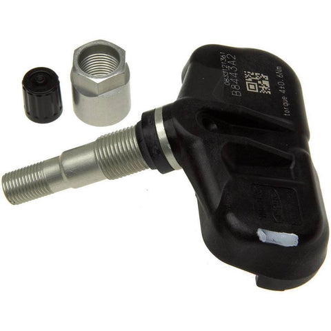

John E Davies Posted April 2, 2017 Share Posted April 2, 2017 Here is a great option- the Dill kits use OEM style sensors mounted internally, and they have a 5+ year service life. No worries about water corrosion, failed seals, theft or pranks. Unlike some generic kits for cars, they are available with sensors of various stem diameters to fit trailer wheels (measure yours!). They come with a cute magnetic roof receiving antenna that can replace the stubby one, and a trailer signal booster is available at extra cost. http://trailertpms.com/home.html I will pass .... I really like their internal sensors but the rigid aluminum stems are too vulnerable to curb or offroad damage. I want rubber stems so they can flex instead of break. Also, being able to swap external sensors from trailer to trailer or to remove them entirely when not needed is a big plus for me. I am still set on the excellent Doran kit. John Davies Spokane WA "Mouse": 2017 Legacy Elite II NARV (Not An RV) Two Beds, Hull Number 218, See my HOW TO threads: https://olivertraveltrailers.com/topic/john-e-davies-how-to-threads-and-tech-articles-links/ Tow Vehicle: 2013 Land Cruiser 200, 33" LT tires, airbags, Safari snorkel. Link to comment Share on other sites More sharing options...
