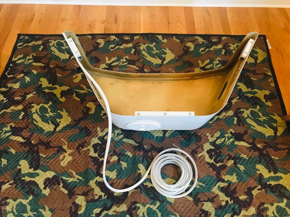

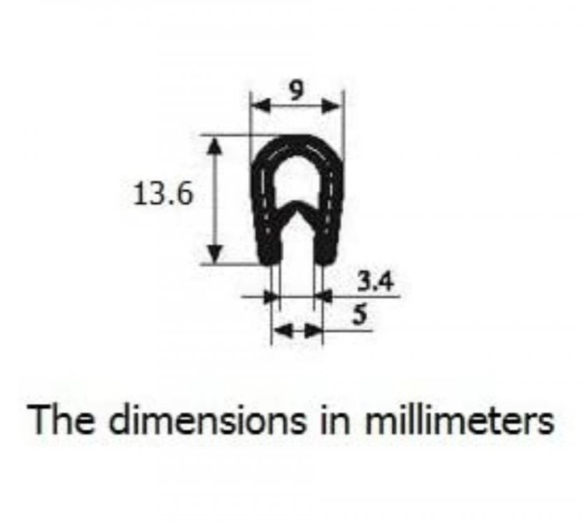

Popular Post DavePhelps Posted July 11, 2017 Popular Post Posted July 11, 2017 Thought I would put this up here in case anyone else is having the same issue I had. Soon after leaving the factory, the plastic strip that lines the bottom edge of the tank cover started to come off. It was a very cheap piece of 'L' plastic kind of glued on here and there. Really, it was pretty ugly even when new. So I finally found this very nice 'U' channel on Amazon that fits perfectly. These trims come in a vast variety of sizes and colors. It appears to be a very high quality vinyl compound and has internal fins that grab the cover on both sides, so no gluing is involved. I just set it in the sun to warm up and gently tapped it on with a rubber mallet. Before doing this, I carefully scraped off all the old glue residue with MEK and a plastic razor blade, followed by a light scrub with a 3M WHITE scotch brite pad (love these for tough cleanup jobs on the trailer, no scratching) Then I filed all the edges to make sure there were no sharp edges or bumps in the fiberglass. Then a good wash. Here's the product: https://www.amazon.com/gp/product/B01F9FXQLU/ref=oh_aui_detailpage_o01_s00?ie=UTF8&psc=1 This looks so much better to me, and the fit is great, better than with the stock plastic trim. It's supposed to be marine grade, so hopefully it will last. My Elite took 5 feet to do. Those with the Elite 2 will need to measure, but the stuff is available in different lengths. It's all in the details! Dave 22 1 2015 Oliver Elite 1, Hull 107 2025 GMC Sierra HD 2500 AT4, 6.6 L8T (gas)

DavePhelps Posted July 14, 2017 Author Posted July 14, 2017 I'm glad some of you found this useful, and hope the trim works for your cover. I'm hoping that Oliver makes them all about the same thickness. The thickness of my cover fell within the specs of the trim. Filing really helped to smooth out that edge and even thing out. To me, it has made a huge visual difference for the better. My wife didn't notice..! LOL. Oh well, we all see things differently, that's for sure. Happy camping! Dave 3 2015 Oliver Elite 1, Hull 107 2025 GMC Sierra HD 2500 AT4, 6.6 L8T (gas)
ScottyGS Posted November 10, 2018 Posted November 10, 2018 Dave, Thanks for posting this. I have been wanting to do this for some time and finally got around to it. The Amazon link still works. I didn't measure the amount needed for the LE2 and just got the 10' length. It took about 7 feet total so now I have some left over to store forever and never find a use for again. :-) Installation was easy.... I pressed it on by hand. This product has some type of malleable metal inside the vinyl cover. It stays on very secure and makes the propane cover sit solidly as well. I was getting a bit of rubbing on the bottom fiberglass and this trim solves that problem. You will need a good utility knife to cut to length. The hardest part about doing this is finding suitable trim material and Dave has solved that problem for us. Scotty Gregg & Donna Scott and Missy the Westie - The Flying Sea Turtle - 2016 Hull # 145 2024 Nissan Titan XD - Western NC

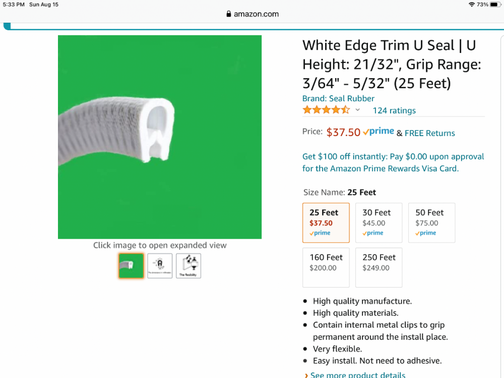

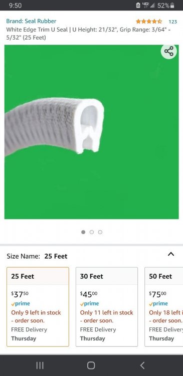

Moderators SeaDawg Posted August 10, 2021 Moderators Posted August 10, 2021 I'm adding screenshots of the product for the day the Amazon link stops working. That looks really nice. I bought some u-shaped trim at an auto supply for ours years ago. 2 2008 Ram 1500 4 × 4 2008 Oliver Elite, Hull #12 Florida and Western North Carolina, or wherever the truck goes.... 400 watts solar. DC compressor fridge. No inverter. 2 x 105 ah agm batteries . Life is good.

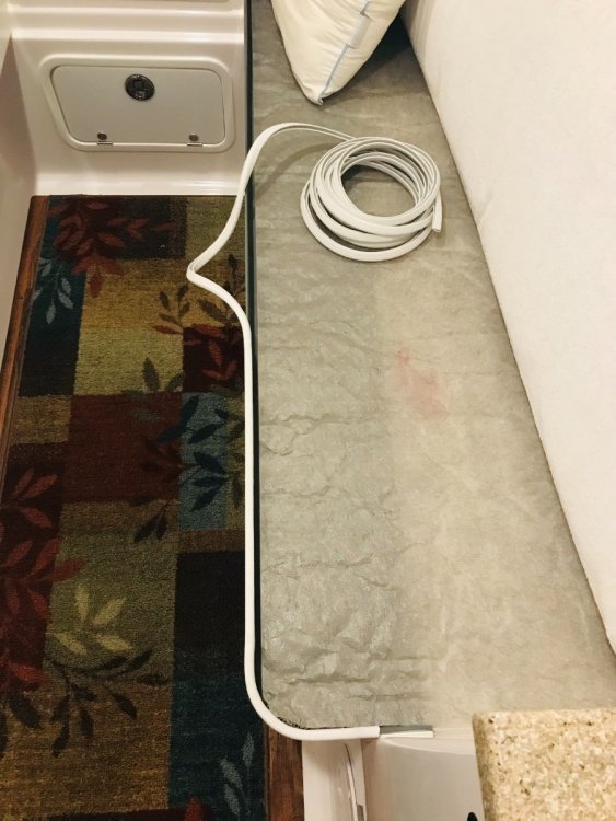

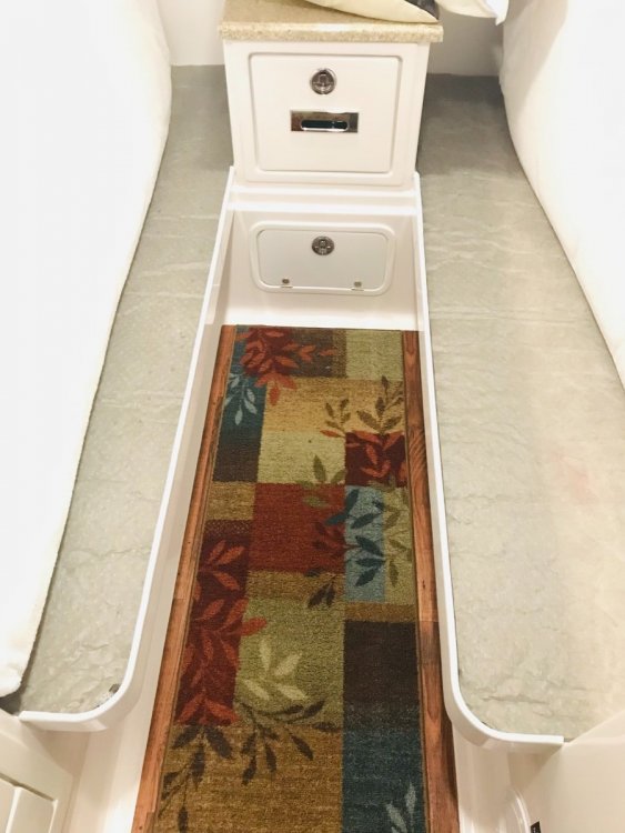

Patriot Posted August 15, 2021 Posted August 15, 2021 Thank you Dave Phelps! I completed this mod today on the LP tank cover or dog house. With the extra material left over I decided to install it on the twin bed shelf edge which is a little rough. It just makes for a much nicer complete fit and finish. This appears to be a pretty high quality moulding. It has quite a strong bite on the edge once installed. Leave it in the sun for a few minutes and it goes on with hand palm pressure with very little effort. 1 2 2020 OLEII - Hull #634 aka- “XPLOR” TV 2021 F350 6.7 liter Diesel Lariat Ultimate Tremor aka - “Beast of Burden” Retro upgrades - Truma Aventa 13.5 AC, Alcan 5 leaf pack, Alcan HD shackles & HD wet bolts, 5200lb never lube axles. XPEL 10 mil PPF front both front corners, 30 lb LP tanks, Sea Biscuit Front Cargo Storage box. North Carolina

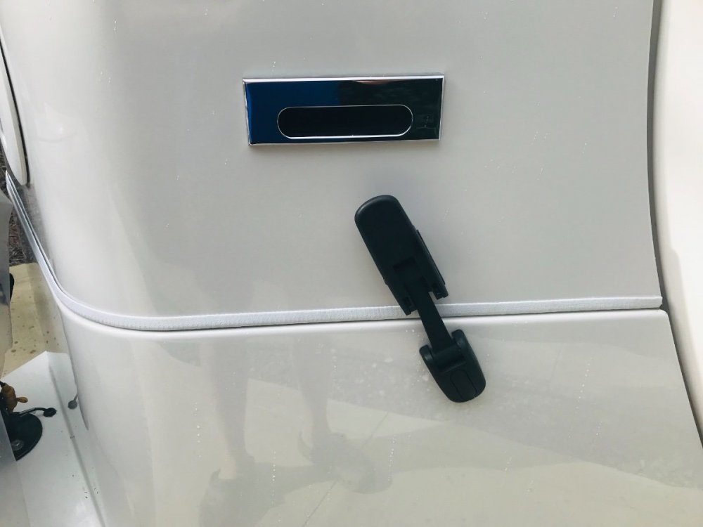

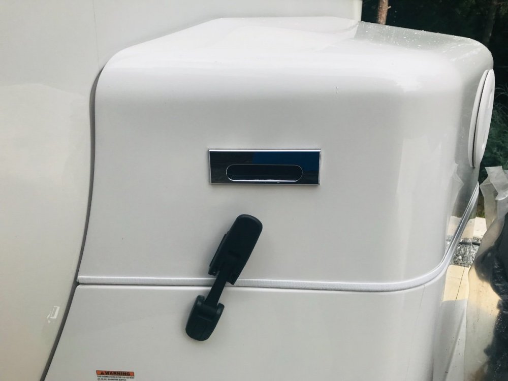

taylor.coyote Posted August 16, 2021 Posted August 16, 2021 I'm home and installed the trim on my trailer today. I needed a couple of inches short of 6'. A tip on the installation. I used a rubber mallet to set the trim. Also, to get the trim running all the way to the back edge of the housing, i had to cut off the back of the trim the last 1/2" inch or so. When done, it looks nice. You will find the cover sits a bit higher (trim is thicker than factory's). the trim stands a bit proud. I think the trim will catch water and grit a bit like a rain gutter. I live on the very damp north coast of California amongst the old growth redwoods. I'm guessing I will have something green wanting to grow in the trim in time. Likely, I will need to pull and clean and possibly replace on occasion. I think it's a good solution but time will tell. 2016 Legacy Elite II, Twin Beds, Hull #124 Tow Vehicle: 2019 Ford F250 4x4 / Short Bed / Crew Cab / 6.7 Diesel Fieldbrook, Ca
